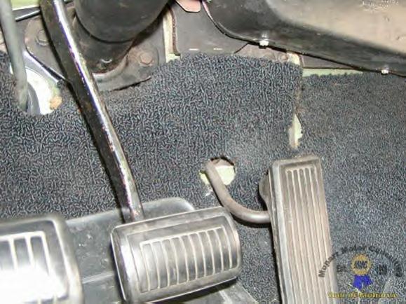

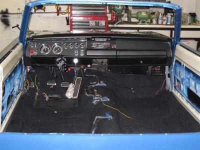

IMG_0020 (Large).jpgYes never seen side to side layout. The rear section gets laid first and the front section overlaps the rear section, no other proper way. The heel pad should spell a starting location for you and then adjust a little here and there.
A 69 GTX would have the gas pedal bolted through the edge of the heel parts_06_l.jpgpad.

I got it in this weekend. Cuts look similar around the console shifting area. That was the biggest pain. I cut my carpet around and under the foot throttle so I dont get hang ups. Thanks for the pictures

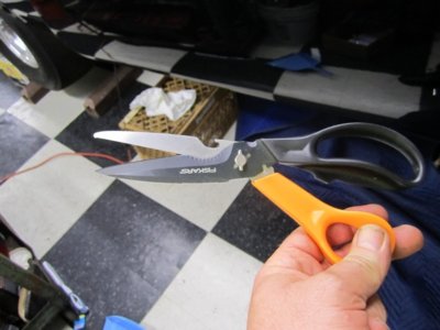

Resurrecting an old thread here. I am installing new carpet in my 69 RR this weekend. This thread is very helpful, but one more question....what is the best tool for the actual cutting/trimming of the carpet? Just a utility knife? Or is there something better?
Most anything should work, but I used one like this.............because I had it laying around since I inherited it from my dad.

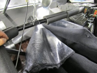

I liked the large utility knife. Fitting slicing and dicing for the roll cage. I also request UNtrimmed as I prefer the carpet go further up the fire wall so you can't see the top of the carpet from the back window.

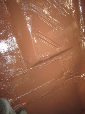

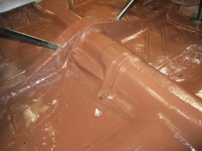

5.19.12 007.jpg 5.19.12 008.jpg 5.19.12 009.jpg 5.19.12 010.jpg 5.19.12 035.jpg 5.19.12 036.jpg 5.19.12 037.jpg 5.19.12 038.jpg 5.19.12 041.jpg 5.19.12 042.jpg
