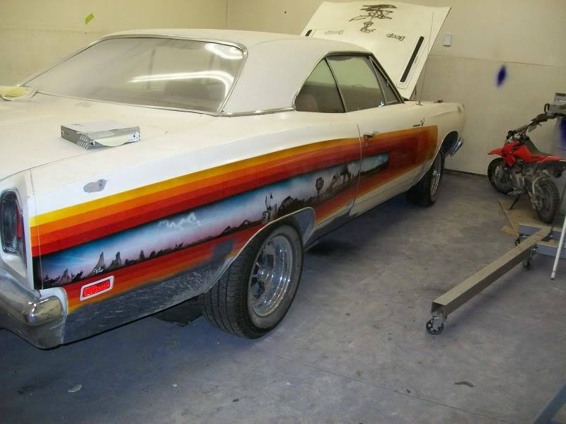

1969 Road Runner facelift

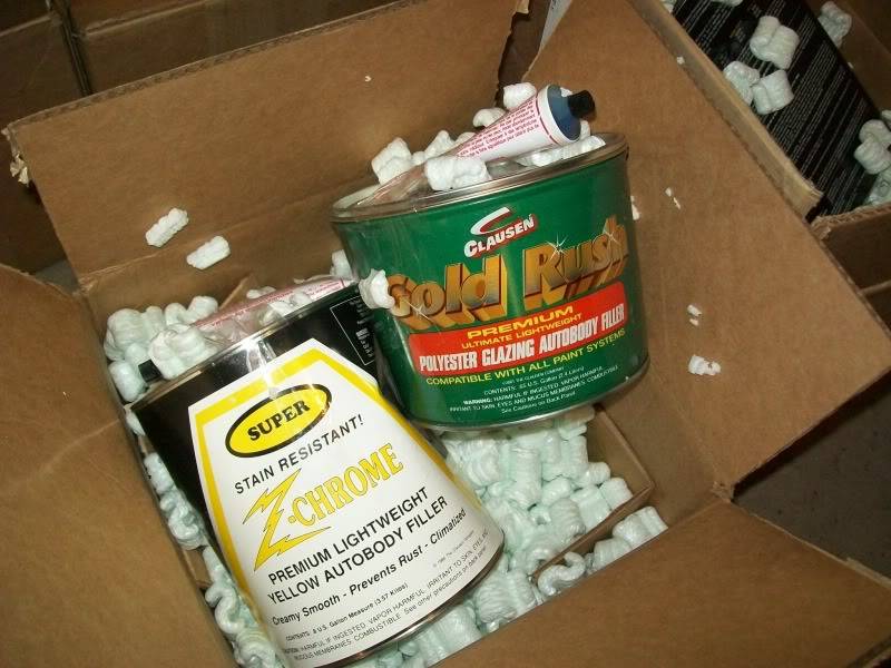

Anybody ever use clausen "all u need" polyester surfacing primer?
I've used slick sand (evercoat) before and I loved it. My supplier talked me into the clausen all u need.
It cost more than evercoat slicksand.
They claim you can eliminate epoxy and sealer with it.... what ever... I guess i'm still going to put my epoxy on and seal it all before base coat.
What sold me was the solids level, it sounded like the stuff had even more solids to it than the slicksand. So I guess that's why I chose to buy it.
Just wondering if anybody here has used it before.
I've used the clausen body fillers before and that's what I'm using on this car as well, I've just not tried this "all u need" before.

Used the slick sand in the past and had pretty good luck. Always do with evercoat products.
Let us know how the clausen pans out for you Dave.

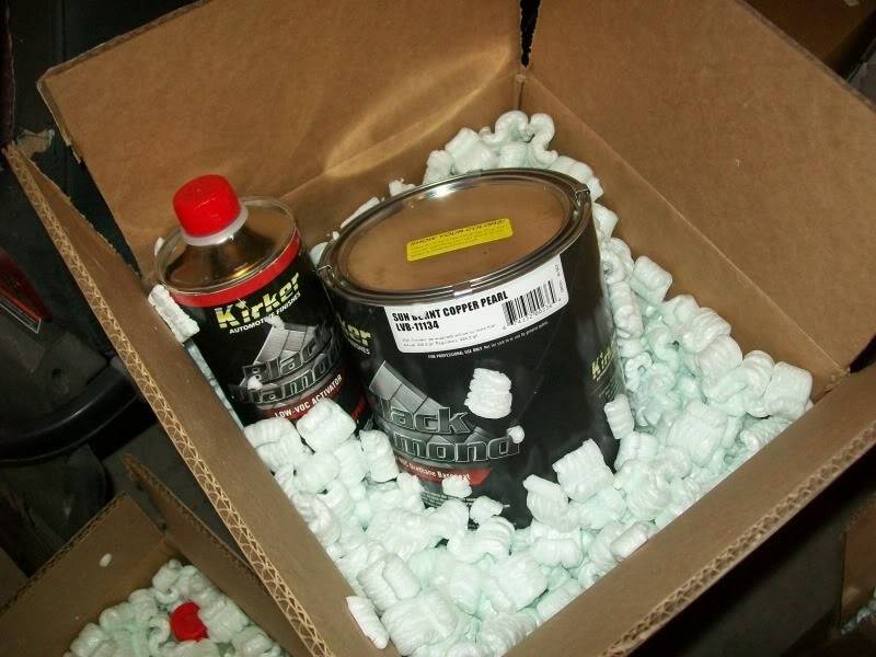

Yeah I'll do that, another thing I can report on is the kirker paints.
Very afordable... I guess we'll see.

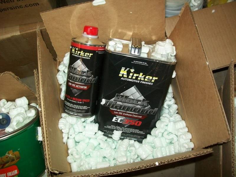

I went with a 2 stage, the base is similar to the old dupont DBC system.
I asked for there best clear... planning to wet sand and buff.
We'll see how it goes.

Same with clausen, I am familiar with and really like there body fillers, especially the "gold rush" glaze, but this will be the first time I've sprayed there poly prime.

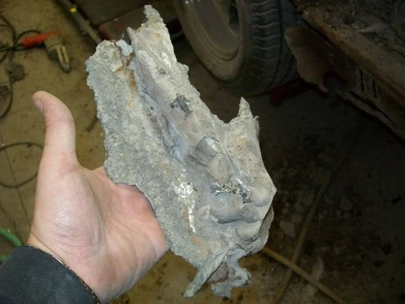

Dave, laying in the dirt does not look like fun, been there, done that, no more brother! But, knock yourself out!!! Not sure who up there is available to Media Blast for you, but, I recommend taking that moment to think about life as you tear the car all the way down to nothing...then, send it out for the blasting; no amount of sanding and discs will ever get it as clean as getting it blasted. When I strip a car down, I'm thinking the same things like what this car has seen etc as the paint, bondo and rust disappear before my eyes. Here's a pic of something that the sanding disc never could replicate...

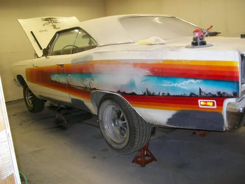

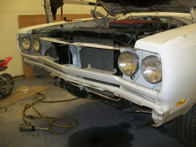

Well I didn't get much done today but I at least got a start.
My secret weapon, worker/wife :grin:
my bad wheel house.

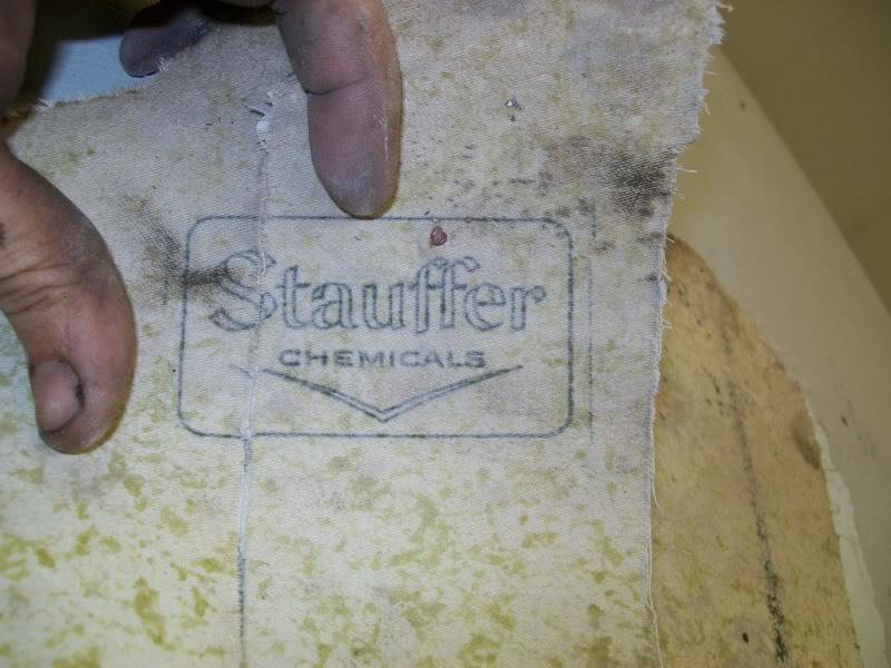

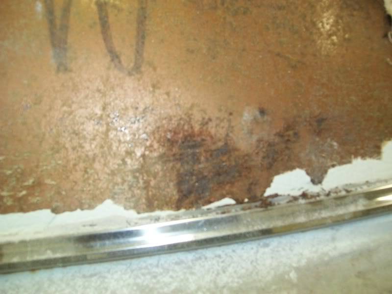

this was interesting, the matching 1W code from my fender tag was written on the roof under the vinyl.
the rust under the vinyl is thatnkfully not bad, I won't need to patch any.
Backside of vinyl.
a little of the original paint under the trunk weatherstripping.
I was really worried about the roof. I has a small and very pointy blade pocket knife with me when I went to look at the car. I poked at any obvious rust bubbled areas on the vinyl before I bought the car, I didn't find any soft metal spots then and now I feel even better.
I might see my sheet metal from AMD early this week and my other supplies including the sand paper.
I have plenty of disassembly to do yet before I get too wild with the sander though.
One nice thing about replacing quarter skins is that you don't have to sand the old ones lol!!
I would have got a lot more done on the car but I had to fix my plow truck on saturday and my garage is still cluttered with vehicles, broken snowmobiles etc.
I decided to just start tearing it down inside the spray booth.

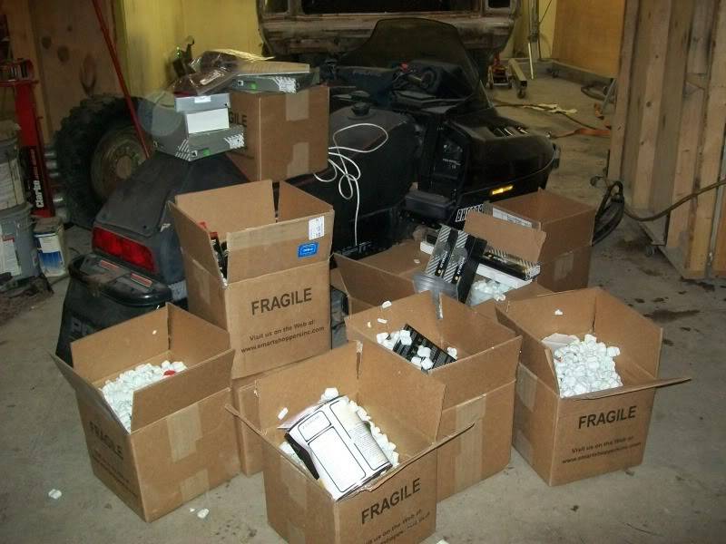

UPS was here, I got about 9 boxes of supplies.
Sandpaper, primers, fillers, base coat, clear... all kinds of stuff.
Damn, guess I have to get to work now.

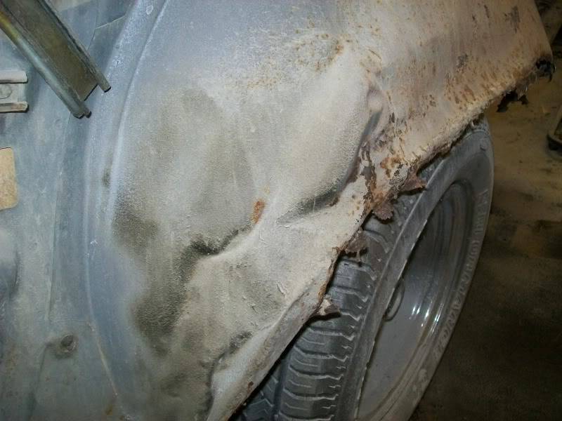

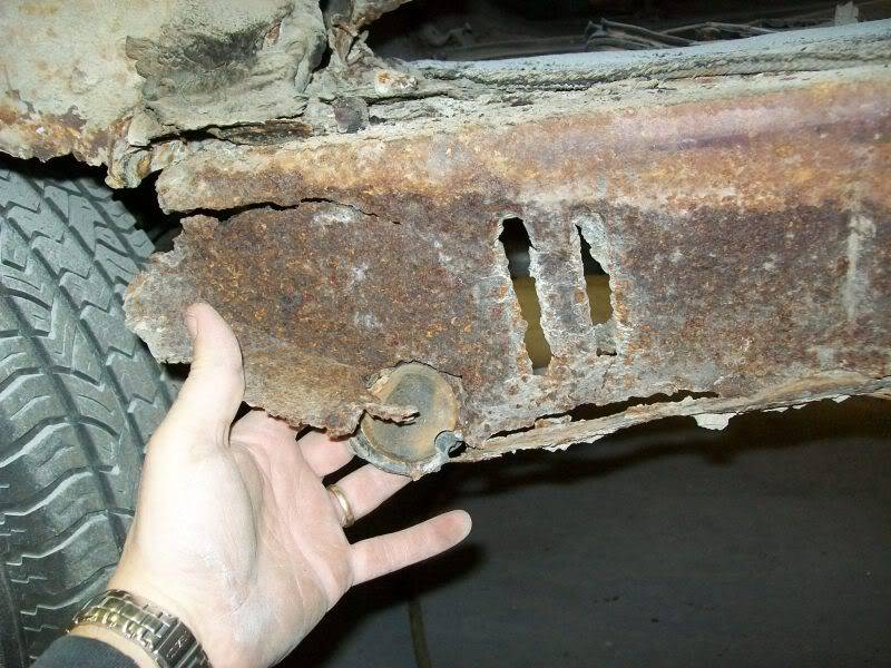

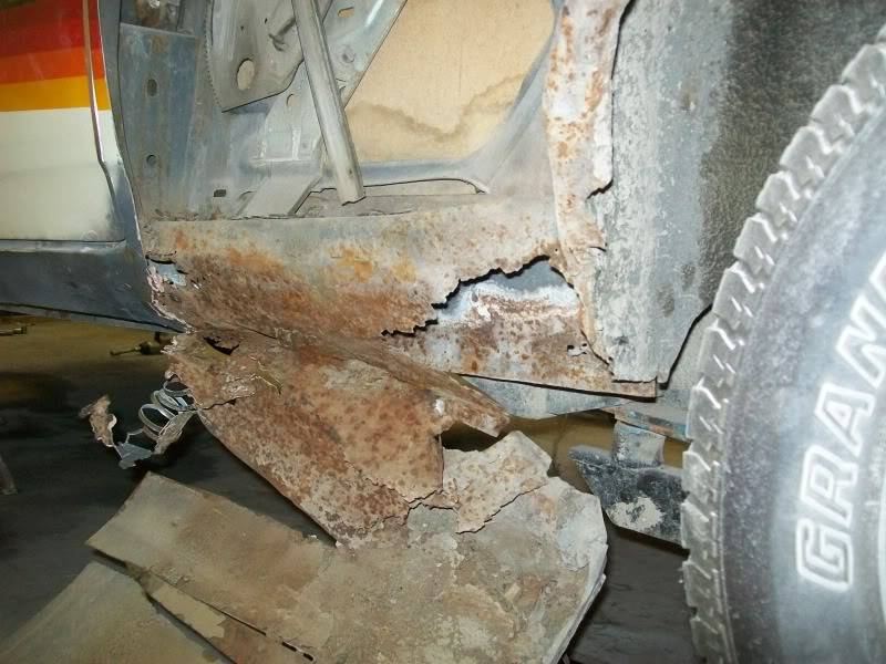

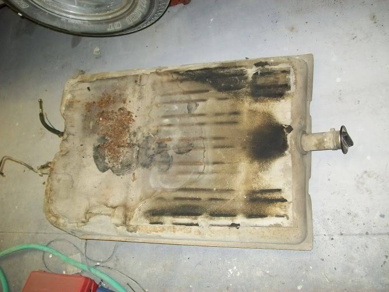

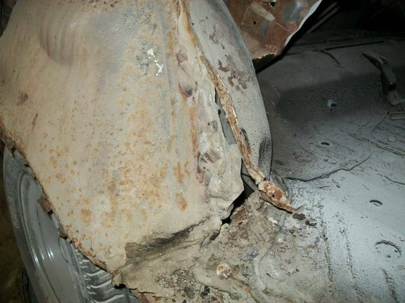

Everything went about how I expected tonight except for my rocker area between the back of the door and the wheel well.

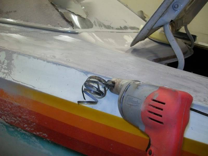

I sanded the rest of the old bondo and paint off the top of the quarter on drivers side, it was on there way too thick and it was very poorly done.
I got the can opener out, pealed a quarter skin off.
Nasty.
ancient dent pulling efforts mid quarter.

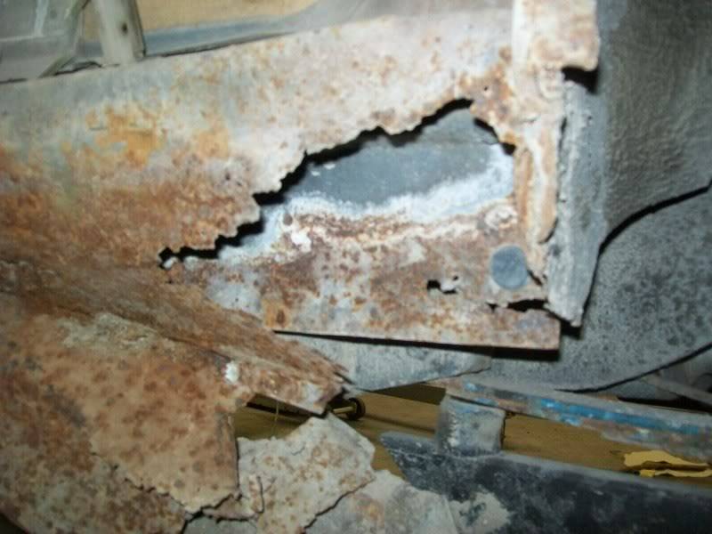

nasty rear rocker area.
some crude old patching where the wheel house split probably 35 years ago.

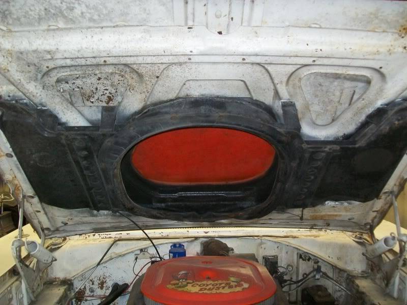

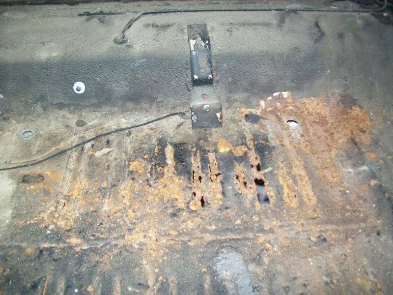

trunk ext, very floppy.
a bunch of goods for after the sheet metal work is done.
That rear rocker area is going to keep me awake tonight.
Advice is certainly welcome.
