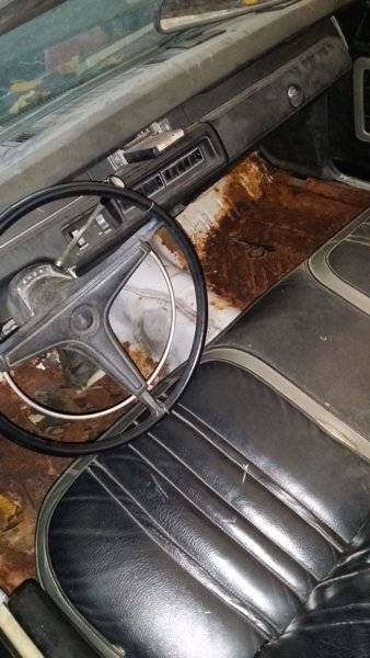

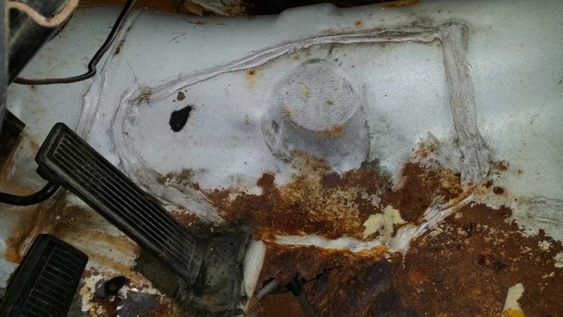

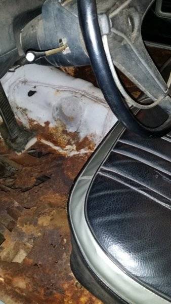

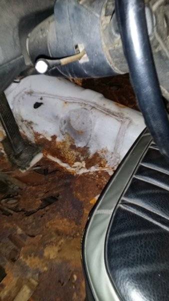

Anyone ever come across this floor pan issue? This is in a 1970 Satellite, looks like a Factory 4 speed hump screw up...??
Car photos, etc 935.jpg Car photos, etc 934.jpg Car photos, etc 937.jpg Car photos, etc 936.jpg
Wow...It could be. What if a worker thought it was coded for a floor shift and then realized the mistake? They all started out as automatic floor pans, right?
My car, being a different model. Also, a column automatic. Has something similar that is factory done. But, mine is more centered in the floor tunnel. My guess is, this might have allowed factories to easily convert the same floor pan to an automatic or standard transmission. Depending what car the floor pan was used for. A guess, being convinced that no one else could have done it to my particular car being that it has all matching transmission, driveline, etc.

I would think it would not be cost effective at the factory to convert it. I think they would have just added it to the sales bank and build another for that order.

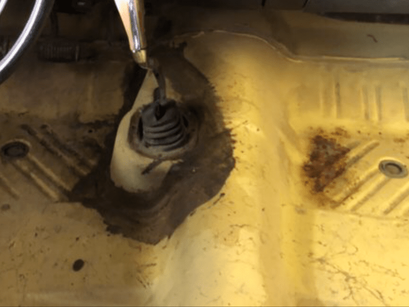

That is not a factory job in any way. The sealer the factory used on the floor hump was the dark colored stuff that stays a bit gooey and absorbs the paint.
Look at this picture of a factory floor notice the paint didn’t stick to the sealer.
That job in this thread is either painted white over the sealer, or was a white sealer to start with.
Additionally, where are the welds they had to remove? Any evidence of weld cutting on the white floor pan in the first post? Do they cut the hole before they weld the hump to the floor? Or after?

could be previous hack work someone covered over
did you dig out the crap and see what it is covering over?

I say it’s a factory mistake. The seam sealer matches the firewall to floor seam sealer in color and application sloppiness.
