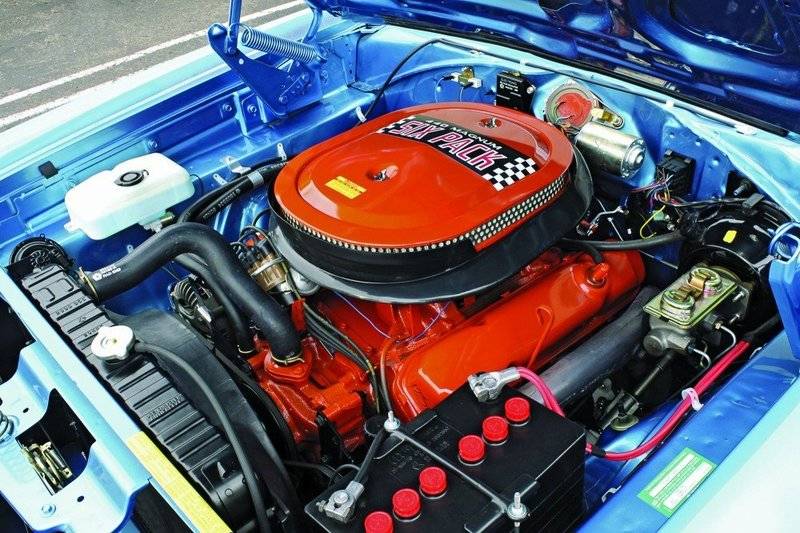

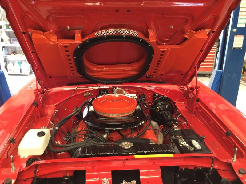

1970 bb engine harness -2 or 4 pin ballast?
all the cars I see have 2 pin ballast.
