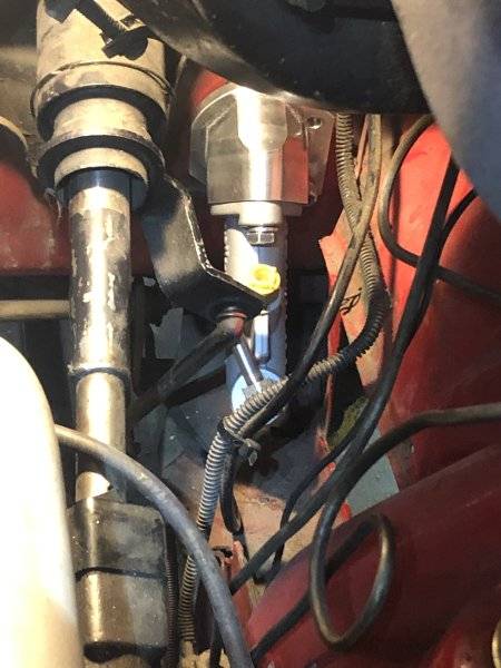

If the shaft isn't centered, maybe it rubs the shift arm as it turns?

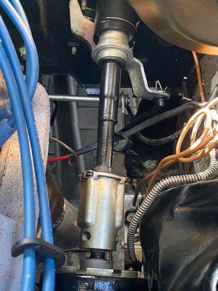

Got some photos. Shaft is centred and nothing touches it.
I think it's something from interior side.
