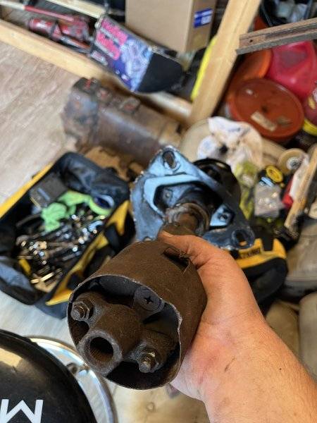

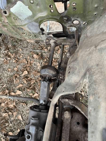

Hey guys. Just got my 73 charger home last night been working on it all day. Went to install the column and there is no way it’s going to fit. I think the shaft coming out of the steering box might be the problem. I’ve attached pics but the column it’s around 3-5 inches too far out when the end of the column touches the steering gear shaft. Any thoughts?
A couple of things could be going on with it. First is it a power steering column? If a manual column it would be too long for a power steering application. Second the inner shaft is collapsable in the event of a collision and has small plastic pins that are easily sheared and allowing the shaft to be extended and too long.
I believe your shafts pins are broke. The pins are supposed to break if you get in an accident.
Ok so update. I don’t think it’s the pins. Just took a closer pic of the column and I know I can’t get the difference from the shaft going in further in, the column looks good to me. So I’m thinking either the column is a manual column or the shaft coming from the steering box is too long. Anyone have a clue how long the manual column is so I can measure what I have?
Are the parts assembled in the proper order?

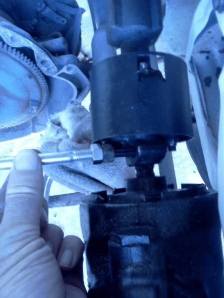

This is what my 73 looks like at the box.
Heat shield is missing while I test fit.
Yes, that's a hockey puck.
There it is with the shield.
Note where the slip joint box is.

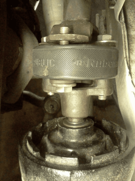

This looks like a 74 arrangement-
That might be the issue. The parts look to be in correct order but that shaft coming out of the box I think is what’s messing me up. I think if I swap out the bottom of this shaft (assuming I can do that) it might work out. This is one I pulled from a 73 charger but the floor shifter parts were broken inside.
That looks correct for 73.
Be aware that the 73 "rag joint" is one year only and pretty expensive.
That's why mine has a $4 hockey puck (and have been in there for almost 12 years).
You can retrofit the entire 74 setup, and use the $12 parts store ford rag joint, but there a little work involved swapping out the floor mount.

Oh ok I’m following now haha. I might just be better off swapping the upper column parts onto the 73 column making it column shift column, which I’m cool with. I’d probably have to move the column shift lever at the bottom of the column as well.
Or I could pull the firewall plate off the 73 column along with the steering box part and and move them to the 74 column then be good.
Just wanted to reach out and say thanks to everyone again. Yy1 was correct the column had a 1974 charger end on it it and the steering box side had a 1973 set up. Luckily I was able to swap the 1973 end onto the 74 column and got it attached. Floor pans came in the this weekend so I’ll be welding in new floors soon. As soon a I track down se quarter window hardware ( probably from the hardware store) I’ll get on the body work. Probably going to drop a 360 in it to putt around and get my charger fix while I’m working on the 71 charger. :)
