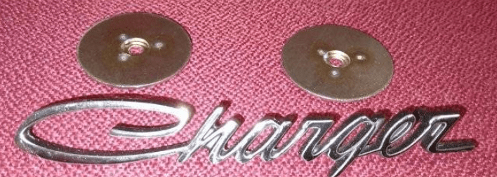

These are more of a large flat retainer that looks about the size of a 50 cent piece. I found an old post of someone selling some and this is the photo. Trying to be careful so i don't break my originals.

Interesting, I have never seen those. THey should be fairly easy to spin off I would think. If not, with a notch on the edge, you could break them loose and spin them off.
I think they are riveted. Or the head is mashed over.

I am pretty sure the pins on the back are riveted also
A one time thing no nuts
If you are careful you might be able to cut enough of the head off to get them apart and still have something to put them back on with
One time use staked over the large washer. I took a dremel and ground off the staked over button. I then used an epoxy to re-attach.
