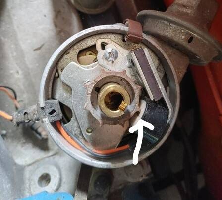

Are you running points? Possibly worn upper distributor bushing. That will cause breakup as engine speed increases and it can be seen on a dwell meter as the engine is revved up. If you are running electronic ignition I don’t think they are as sensitive to loose, worn bushings.
Oh yes they are, especially the factory based units. The reluctor wheel and pickup are set to a .008 clearance so if there is wear, the two points meet and shuck the teeth from the wheel!

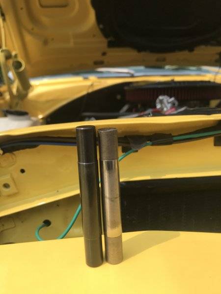

It idles fine and once you get above 2500 rpms it starts to miss really bad. I'm going to change the oil and see if there is any shavings in the filter. This is the second fuel pump rod I have put in this engine in 6 months. Here is a picture of the new vs old one I just took out of the car.
I pulled the cap but didnt pull the rotor. Will check the reluctor next time around. There was some carbon on the tip of the rotor button but I got that cleaned up. Also checked the cap and the contact points were a little crusty as well and I cleaned them up a little. But didn't think about the reluctor wheel and the pickup coil.
Thats about wrong.
Fuel filter?
Water in the gas?
Good question not sure.. I didn't notice anything weird when I swapped carbs. Then I actually bypassed the mechanical fuel pump and stuck a electric one in line and it worked fine filled the QFT carb in a matter of seconds. I thought it might have been fuel starvation. But with the electric pump it made no difference. But water in the fuel is and could be a suspect.
Thats about wrong.
The first one I changed out was worse. Almost a full quarter inch of it was gone. This one is about an 8th inch gone. Comp Cams push rods suck *** and they are made of chinesium butter steel.
