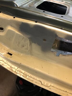

I use PPG black epoxy JP377 in the shopline series. I think they also have white and gray. Inexpensive and works very well.
I was going to ask you that exact question but ya beat me to it. So is there no window with the primer? Its always difficult to plan the windows because bare metal rusts and you want to get the epoxy on right after blasting or what ever prep you use. So you prime it in the window for a chemical bond (within 72 hrs). So the primer is a mechanical bond?As a habit I usually put PPG high build primer down over the epoxy (withing the 72 hour window) just to make life easier as the epoxy is hard to sand and I don't have to mess with any sanding if still in the window. But you don't have to as my current project is in mostly epoxy as I needed to coat the bare metal before it started to rust. Just have to sand it again before the high build primer PPG JP202 goes down.
Thanks BG what about after primer for say base coat. Is the base to primer a mechanical bond?Yes. High build will have a chemical bond within the window to the epoxy, after that window you have to sand the epoxy for the high build to have a mechanical bond to the epoxy. I have done it both ways and either works fine just use the grit that the high build asks for if sanding. If sanding the epoxy make sure it is fully cured or it will cause you problems.

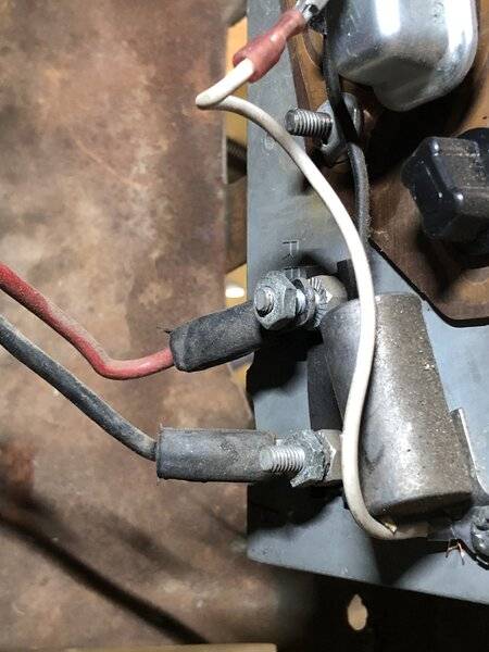

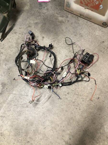

Is that the amp meter? Do you know about the amp meter bypass mod? A lot of guys do it. It is a lot safer for your car..

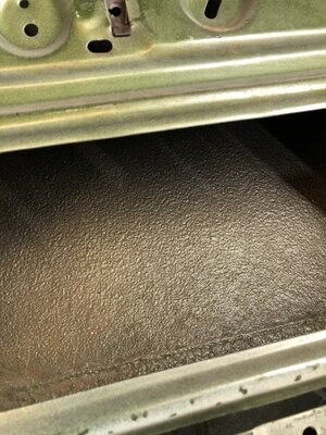

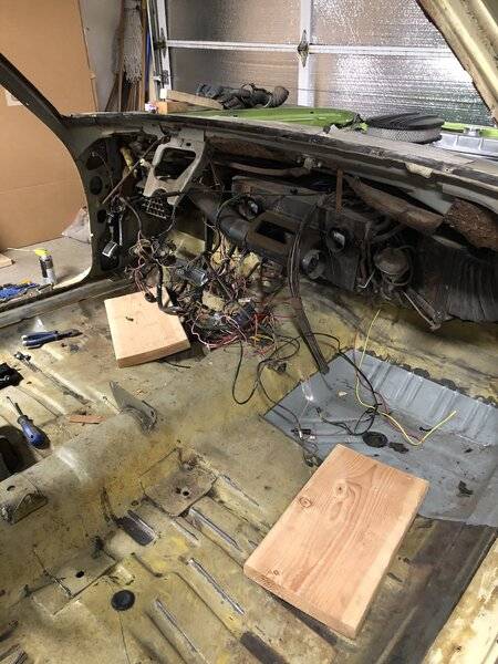

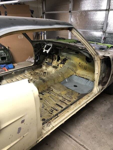

Unless you are going for a concours car or have money, energy and time to burn. I'd wire brush a little as needed, a little sanding here and there, clean it good, apply good sealer, then hit it with $3 walmart spray cans. Heck, it's never going to be seen and will never rust from the inside again, within the next 50 years anyway. Then put the extra money, energy, and time saved into other higher priority things.So I am not sure the best way to proceed on the floor. I would love to get it sand blasted and then epoxy it but the motor and trans are in and I am not sure if thats a good idea. Any thoughts or suggestions on what I should do to prep the floor here?
Yes I plan to do the bypass for safety even though the terminals look perfect.Is that the amp meter? Do you know about the amp meter bypass mod? A lot of guys do it. It is a lot safer for your car..

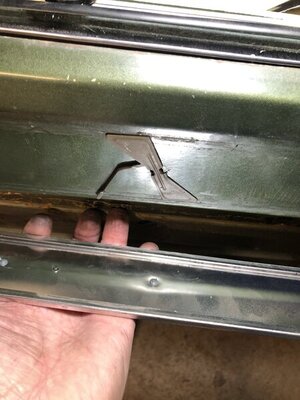

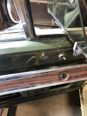

Mine are similar but different. In hindsight its better to release them from the back while still attached to the chrome plate.Maybe give you a better look at them.

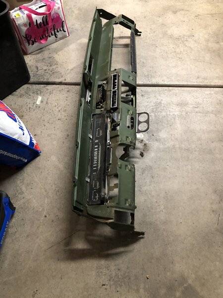

What can I say? Mopar mess? Buggars? What I plan to do with this I am contemplating. Keep it all stock and fix all this stuff or modify it.
All I want are decent gauges controls and a functional AC system AND easy access to all that after I an done if possible.
Got some time to chew on it and learn what a Vintage Auto Air needs from this set up. A lot of work either way.....

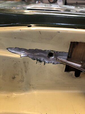

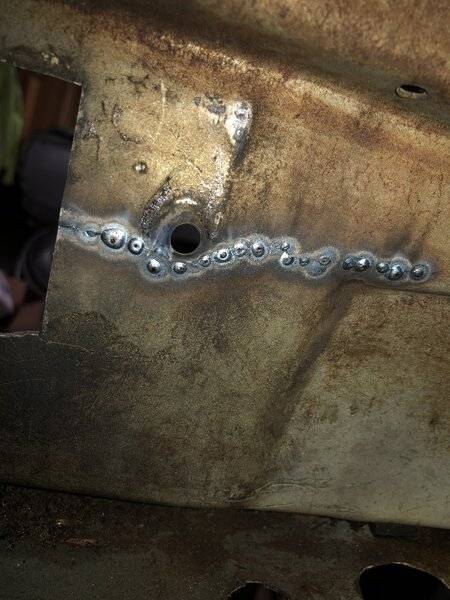

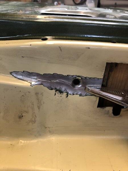

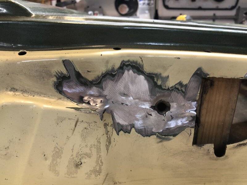

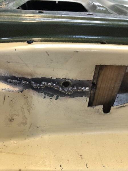

So in this (driver) door there “was” a stress fracture at one of the screw holes in the latch. Well I wanted to TIG it but I ain’t got no TIG (a blues song?). So the trusty old MIG turned out fine. 50% penetration is not worth going after as the metal is thin here.
Is this common in B-Bodies?
View attachment 978453 View attachment 978454 View attachment 978455 View attachment 978456
Good to know that its not uncommon. That metal there is very thin for that application IMO.I had the same thing in my 70 satellite, driver's side door. Welded it up.
