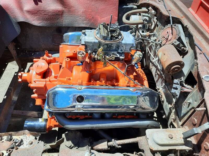

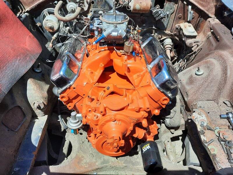

So lets talk about what I did to try and get her running for the first time in many years besides a new battery :wetting:

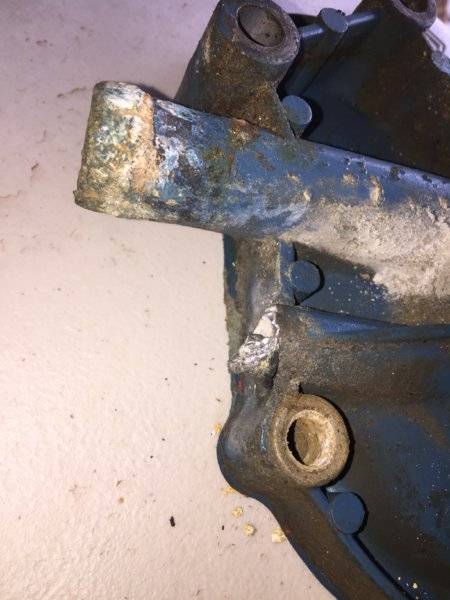

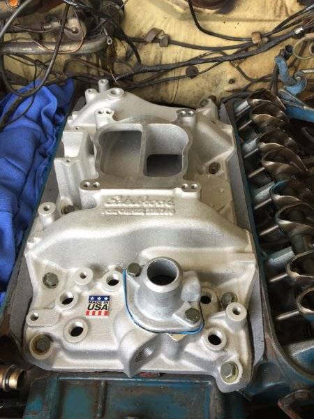

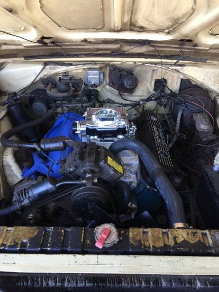

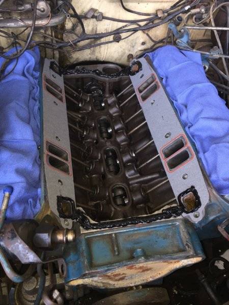

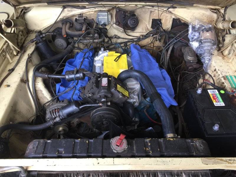

I noticed that the intake manifold was rusted through on one of the heater ports and was the stock two barrels YUK PUKE :bs: So I put a new Edlebrock intake on with a new demon carburetor and some new valve covers.
View attachment 779447 View attachment 779457 View attachment 779458 View attachment 779460 View attachment 779461

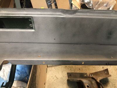

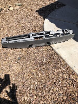

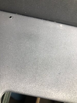

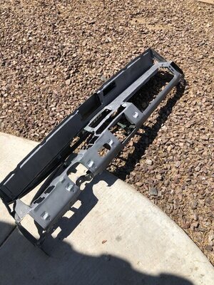

Been too hot outside so not much garage action. I decided to take up some water sports. I hydroblasted My dash frame. Way to many details to sand down. Took me 20 minutes to get it down to bare metal. Took an hour to set up and clean lol. Hit it with Phosphoric acid to stop the flash. It has excellent tooth structure being an etching acid. All ready for paint.

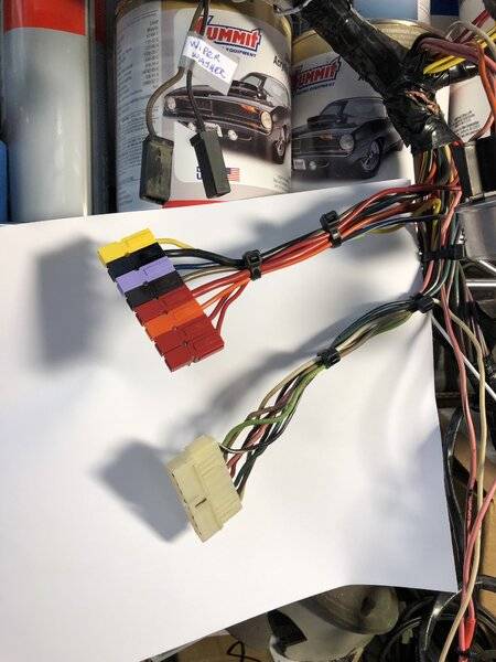

Slow progress as its 117F here in Hell. I received my Anderson Powerpole connectors and replaced the crap Molex connector on the ignition side as I rebuild the harness and fuse box. The Powerpole connector is color coded to the wires! By far the best solution and its got a 40A rating.

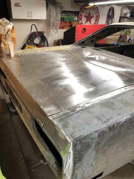

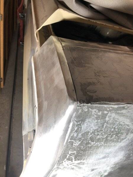

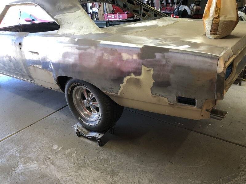

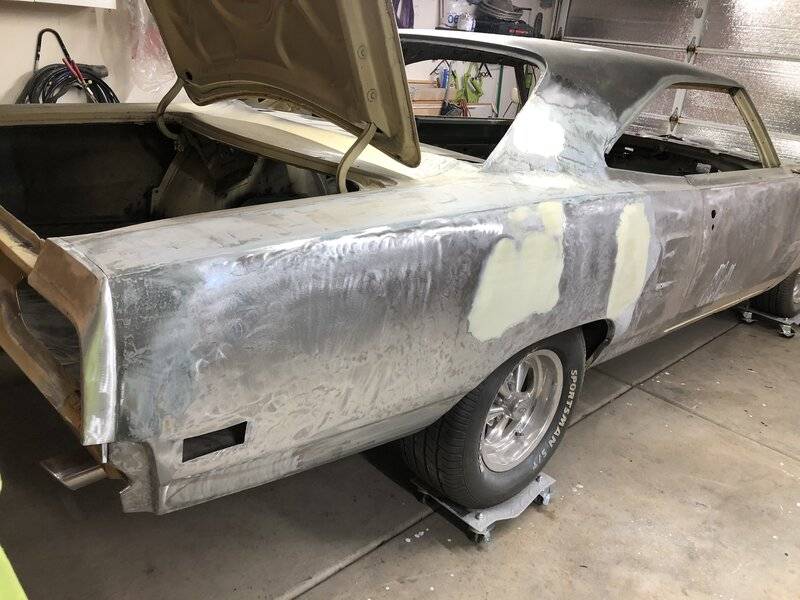

With the metal work now completed its time for the bodywork. Panel weld seams have been filled with Eastwoods aluminum filler and weld seams glassed with short strand fiber. Its time to strip her down and get epoxy on.
B9AC4DFB-7E23-44F6-BAC1-4D7A138BFE2A.jpeg 5FB8A34A-46E9-4942-A33A-B519A2B04D70.jpeg D059E922-B417-4D73-9A9A-2D499B40C4C2.jpeg 43F1D0DD-EB82-47D5-B0C7-1DACDD454340.jpeg
Starting to like the bare metal a lot! I am wondering if I should just clear coat it!

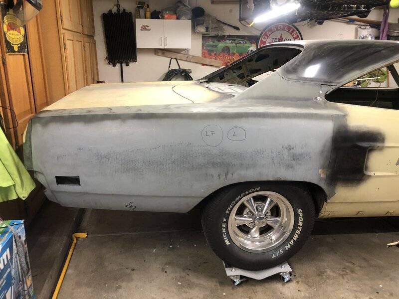

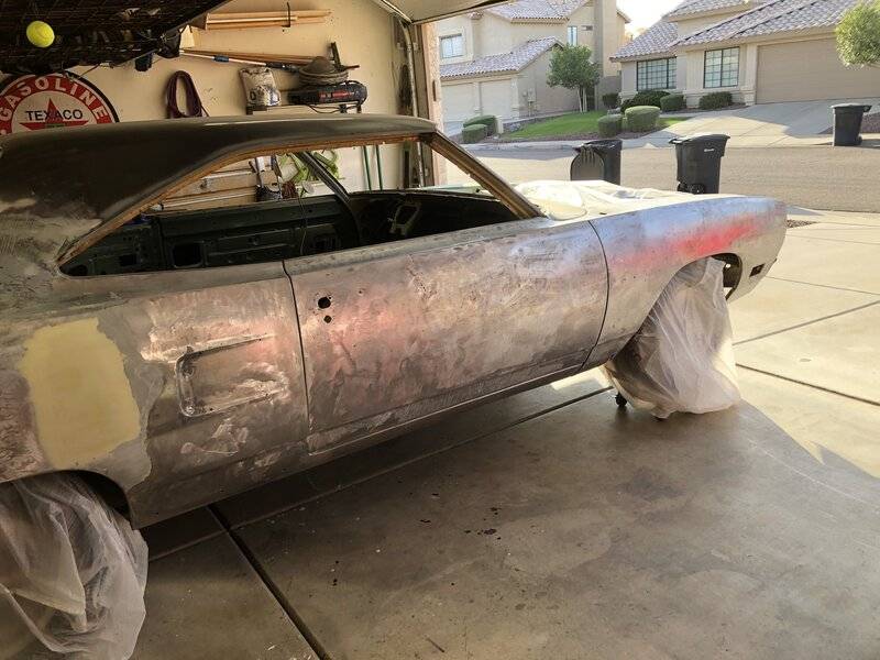

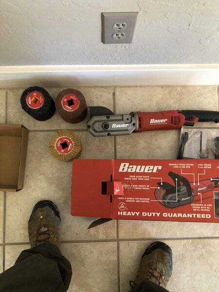

I have to say this new HF Bauer stripping surfacer tool is really fantastic. They just released this and I had to drive 30 miles to find a shop that actually had one. I stripped most of the exterior in one day using this:
711DD172-ABD0-48B4-8E32-33D2A00BDC25.jpeg 275CD456-D82D-4972-AD97-7C9BA5E57D3B.jpeg

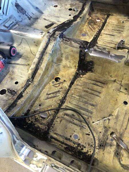

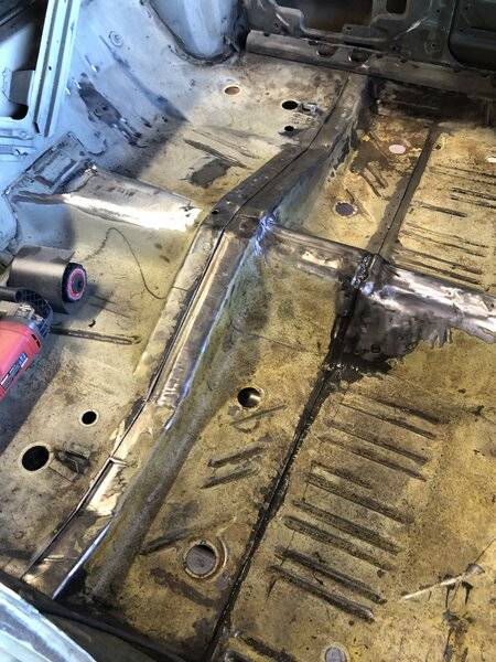

Working the floor for a while. Seams were filled with that sticky seam sealer. Thats out but its a slog. Sire wheel works good but that wire shrapnel though…..
