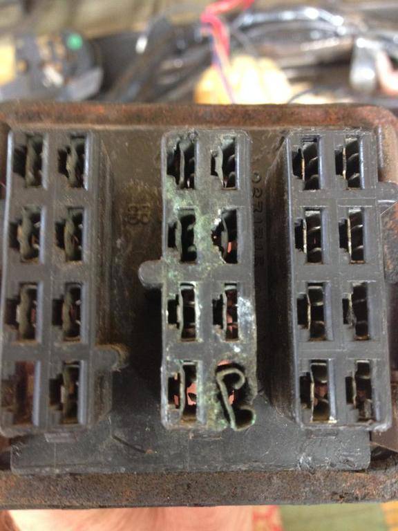

UPDATE. New to this site but love the information I can find. So i read some older conversations relating to no power problems and found what I needed. The b body has three 8 plug wiring harness that plug into the top driver side of the engine bay firewall. One for front lights, one for engine wires, and believe one for rear lights. Any how, the 2015 conversation I read some one posted a message saying to check these old wire harness plugs by carefully disconnecting them and checking if the plugs are dirty or need replacement. When I pulled of mine the center 8 plug on the firewall is for the engine wiring. Well that plug had a lot of built up crud for the blue wire that is suppose to be for coil ignition power. And at that same time I found out the hard way someone drilled through this factory plug at one wire spot to wire straight through to behind the dash for something. Time to re wire the car for me in the winter to update it and make newer, cleaner, stronger and safer. But in the meantime a good spray of brake cleaner and scrapped out the build up of grime in the plug and the ROADRUNNER starts right up and sounds awesome with the flowmaster exhaust and headers I recently put on myself. Old wiring looks okay but going on 47 years probably would be good to replace it all with factory replacement new wire assemblies.

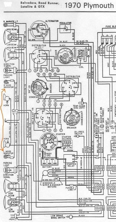

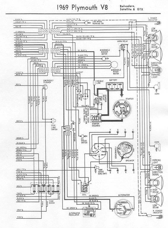

70 B-body Belvedere GTX RR diagram
the 69 B-body is almost the same
I have a better photos of them
Mopar 69 B-Body Wire Diagram 1969 Belvedere GTX Satellite RoadRunner Schmetic A.jpg
Mopar 69 B-Body Wire Diagram 1969 Belvedere GTX Satellite RoadRunner Schmetic B.jpg
always when you deal with the "bulkhead connectors"
be very careful taking them apart & they can be very brittle,
clean them well, get into both sides,
try to get corrosion/oxidation or even rust off/out
some electronics cleaner is great too leaves no residues,
IMO use a little bit {not gobs of it} of dielectric grease
on all connections too, it will help to stop the oxidation/corrosion
& help to keep most moisture out too...
M&H Electrical Fabricators Inc. http://www.wiringharness.com/
exclusively available only thru "Year One" unfortunately
makes all of the OE harnesses, & they ain't cheap either...
or check out Mad Enterprise http://www.madelectrical.com
both supplies & tips & tech articles are worth checking out
I'd highly suggest buying a "Factory Service Manual" for that specific year
http://www.mymopar.com
is a good resource too, check the tools-reference
good luck & happy Moparing

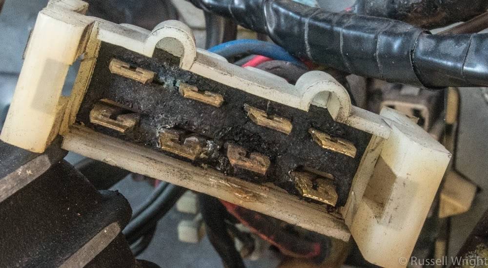

Thanks for suggestions but believe I found the problem. I went out to the garage this morning to pull the RR out and wash it for first time in 14 months, and guess what?? No power at ignition again. So i pulled the bulk 8 head connectors out, the center one is for the engine wiring harness and has the in line fuse link I was told about in this discussion. The plug for the large blue wire which is the fuse link to starter relay is decaying. I took some cleaner and cleaned it out again and it started. I pulled it out of the garage and washed the RR really well. Get back in and no power again. Pulled that connector off again and the main plug connector that is on the firewall and attached to the wiring harness inside the dash is decaying for the outlet for the blue starter relay fuse. Only options appear to be replace the wiring main plug on firewall or drill through it and connect a wire straight through cuz definitely just falling apart old. Stinks cuz I might have to pull apart the dash in order to change that? Ordered some of the wiring harnesses today from YEARONE because only they and ClassicIndustries sell it. Yearone staff told me that ClassicIndustries actually buys the wiring harnesses from YEARONE. YEARONE has a better price and only charges 16 for shipping but ClassicIndustries wants 36 to ship the same thing. YEARONE also accepted a coupon code I found online for my entire 400 dollar order that took 20 percent off (code is - BREEZE). Sucks to have to rewire it but In my opinion better to replace whole unit versus hacking it up further
I'm confused by your description as "decaying". Could they be oxidized or is the plastic bulkhead connector burnt from overheating? Oxidation is an easy fix. Overheating is the result of another problem.
