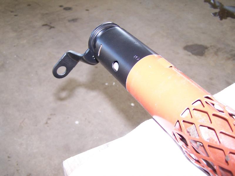

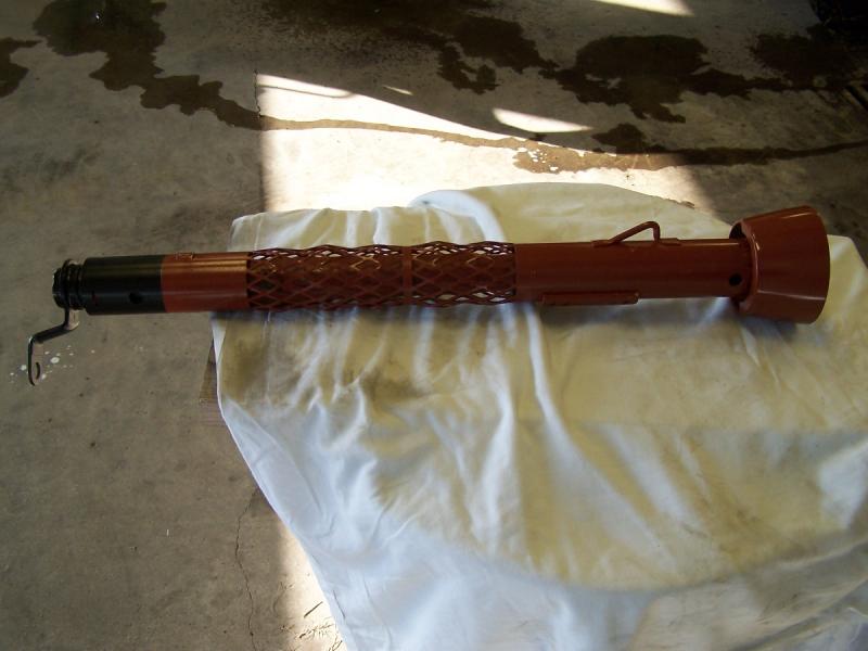

I'm restoring a 1970 Super Bee and can't find any info about the arm at the lower end of the steering column (Shown in pictures). There was no linkage connected to it when I disassembled the car, only a wire holding it in the down position. I would appreciate any info, schematics, or drawings about the linkage that should hook up to it.

The arm on your column is for a reverse lockout or column interlock, it's in the service manual (pics and all), several places sell the linkage setup that connects to the reverse arm on the transmission.
BTW, welcome and nice car.
BTW the bottom of your column should remain steering column color. I see you stopped the Burnt Orange and painted it black, that's incorrect for a restoration.

Thanks for the info. I just repainted it black today (darn) because it had some rust pitting that didn't get fixed when it was painted. Nice and smooth now but I might have to redo it.
Thanks for taking the time to answer on the column issue. I don't have a service manual or pics. Do you know where I might get them and who sells the linkage?
Thanks. Got a ways to go, but it's getting there.
Free manuals are here but yours is not listed, if you download 1970 Plymouth manual it shows the linkage and is the same as yours.
http://www.mymopar.com/index.php?pid=109
The linkage is available from Brewer performance or Passon performance, and I'm sure there are others.
