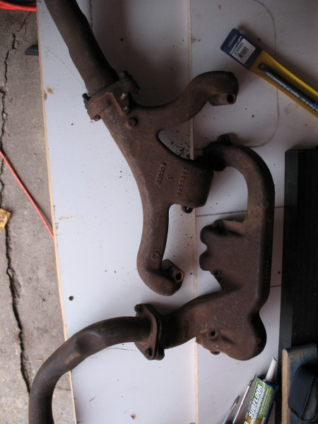

Here is what you're looking for, I got these off Craigslist locally in the fall. A buddy of mine just got another set off Craigslist locally last week. I saw a bunch of these at Carlisle and the Nats last year. They are out there, you just have to look. The casting #s you are looking for are 2863549 for RH and 2863553 for LH.

T/A and AAR don't have the casting number on the top edge of the drivers side like the earlier ones do
