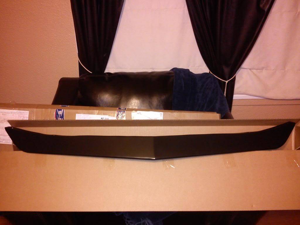

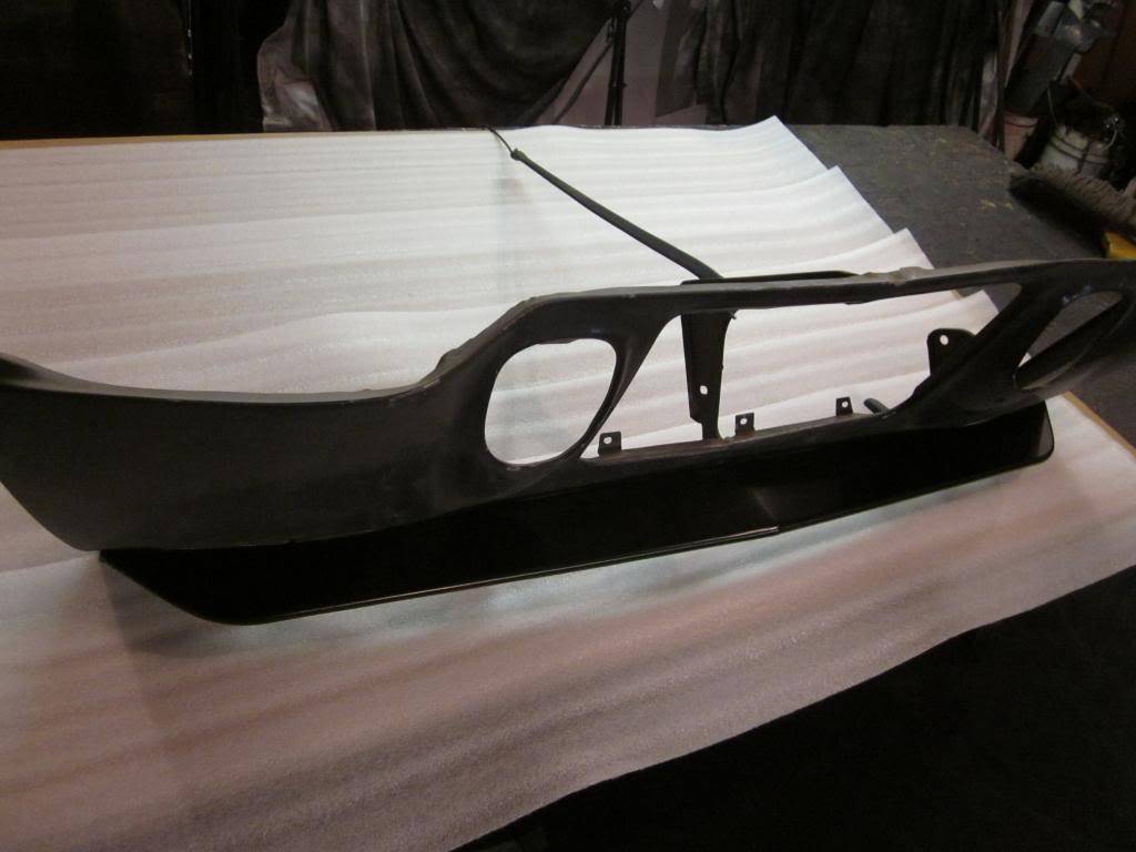

I got a present today in the mail:
My new spoiler from spoilers by randy! - http://www.spoilersbyrandy.com/Pages/default.aspx
its the first one for the 71-72 roadrunners!
his pic mounted won a front valance:
I'll get some mounted pics here on friday in the daylight when I'm not working so you can see it on the front of the car before I get it painted!!
its unfortunate but the spoiler just didn't fit right, had a huge gaps on both sides so I tried my spare valance and same thing. Randy was kind enough to refund my money and is back at the drawing board - he is gonna contact me when the new prototype is finished.

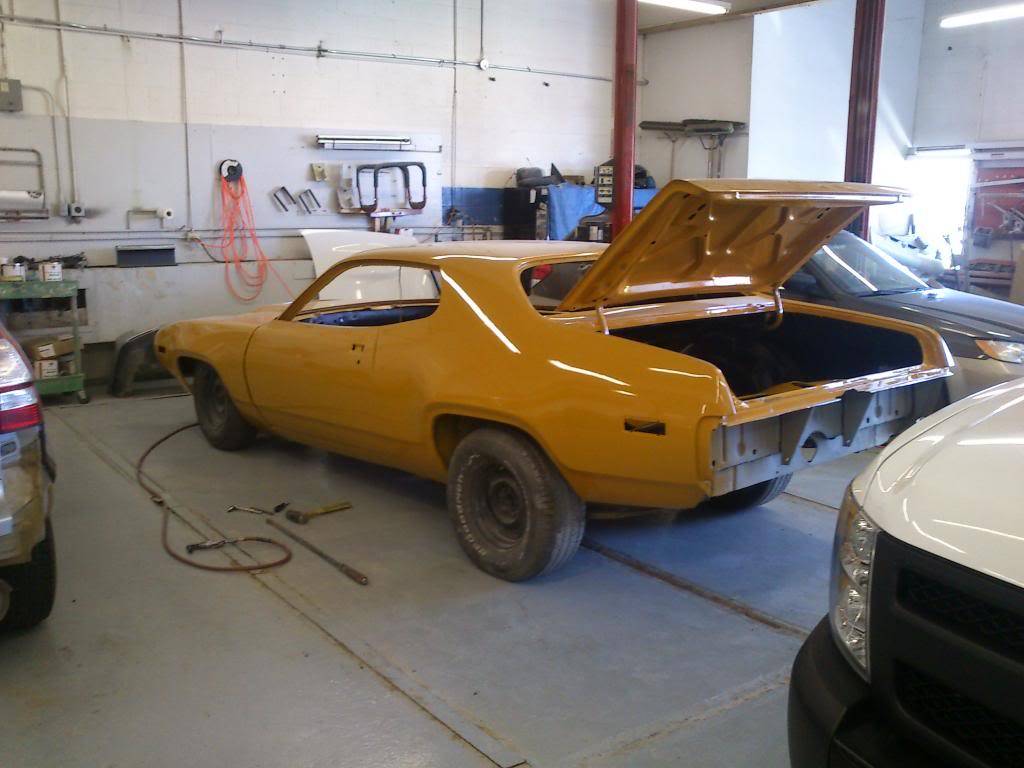

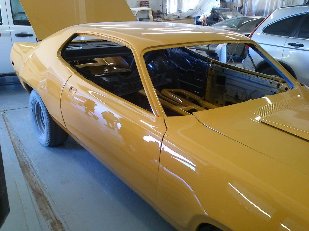

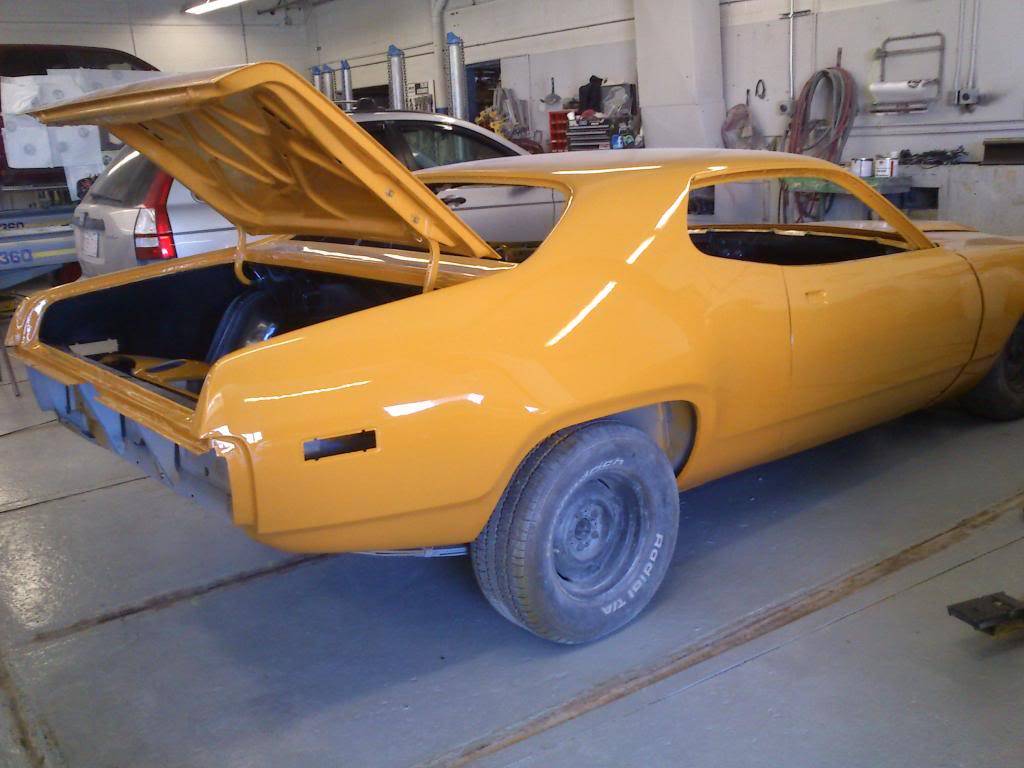

Found some pics of at the bodyshop before I got her painted:

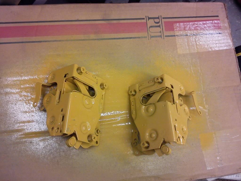

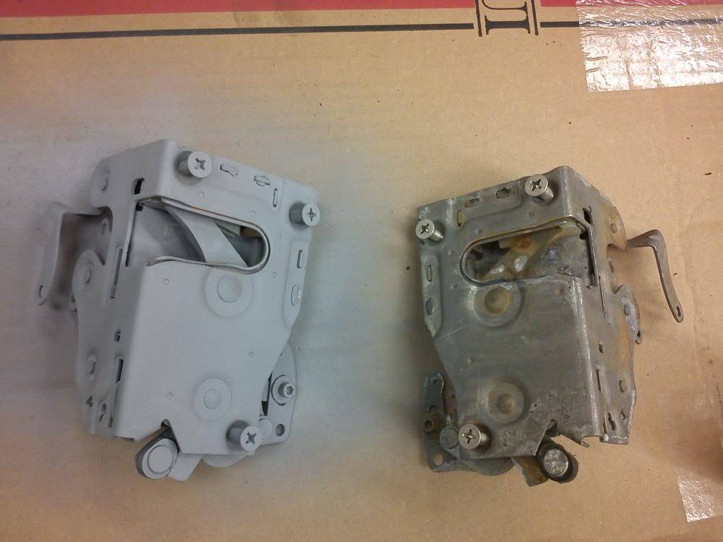

I probably spent over 10-20 hours with a pic cleaning these by hand after I acid dipped them to get the 40 year old paint/rust off.
and then painted them on the one side that you see when the door is open

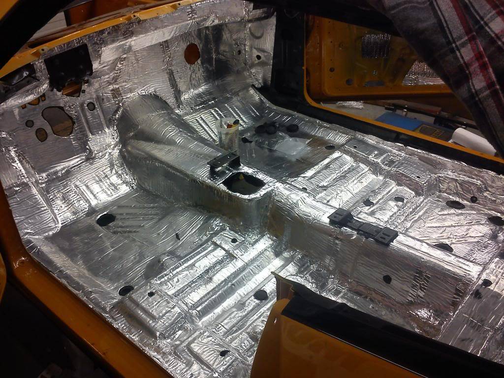

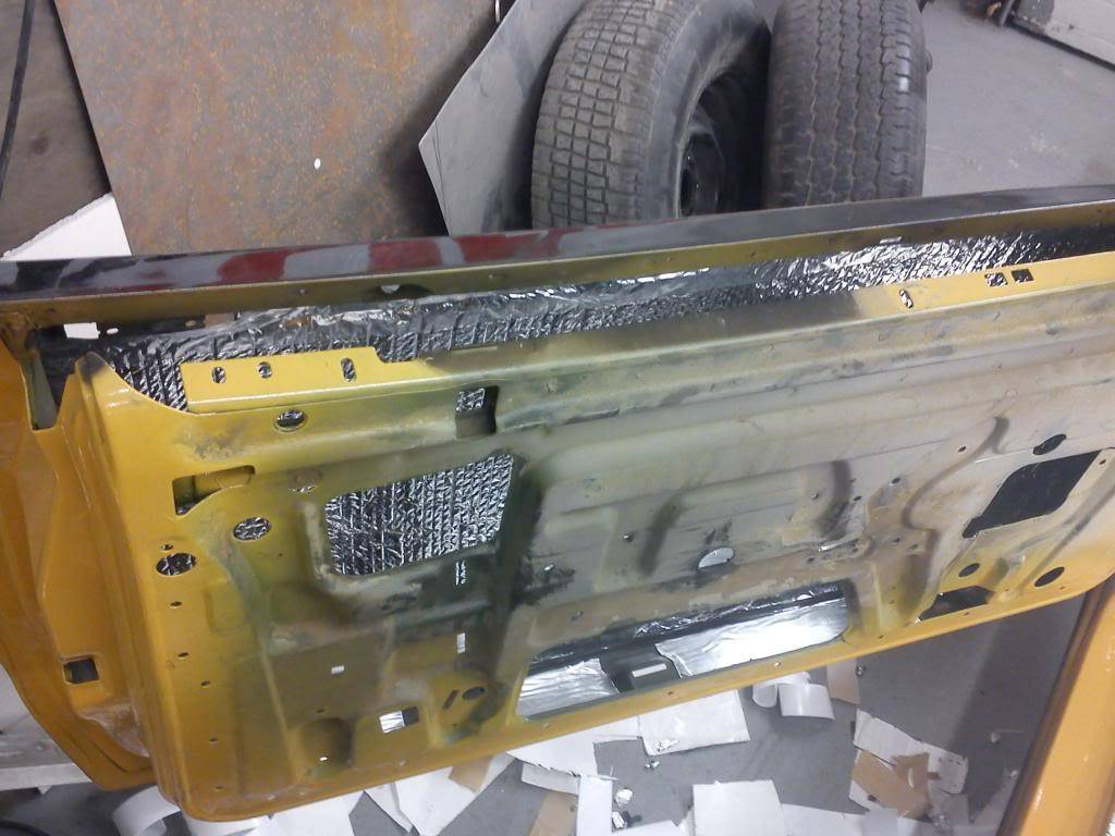

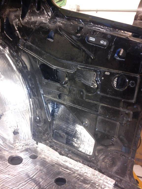

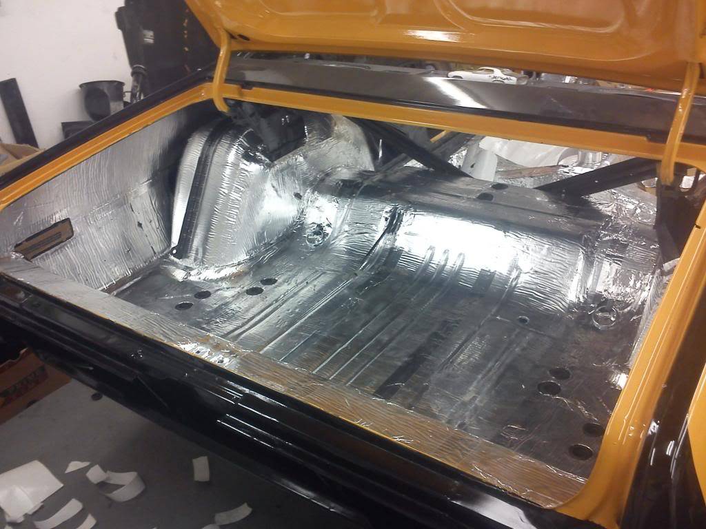

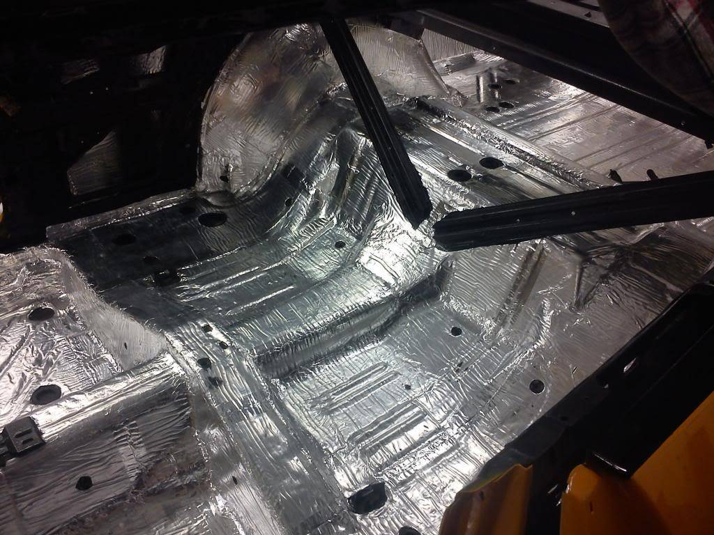

And I am now finally finished with the sound deadner in my car. It took almost a full 3 rolls of B-Quiet. For further reference it took:
1 roll did the roof, doors, and inner fenders to the trunk on the car
1 roll did the firewall to the rear passenger seats flooring
last roll did the trunk and any little place I missed with some spare left over!
I added close to 90lbs to my car but its all good weight? :)
I Think it took about 30 hrs to do the installation...

Your car coming along great very nice work! That is a very handsome young-un there!! Looks like you have two baby's to take care of, and doing a fine job to... That sound deadner looks real good..

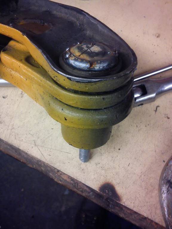

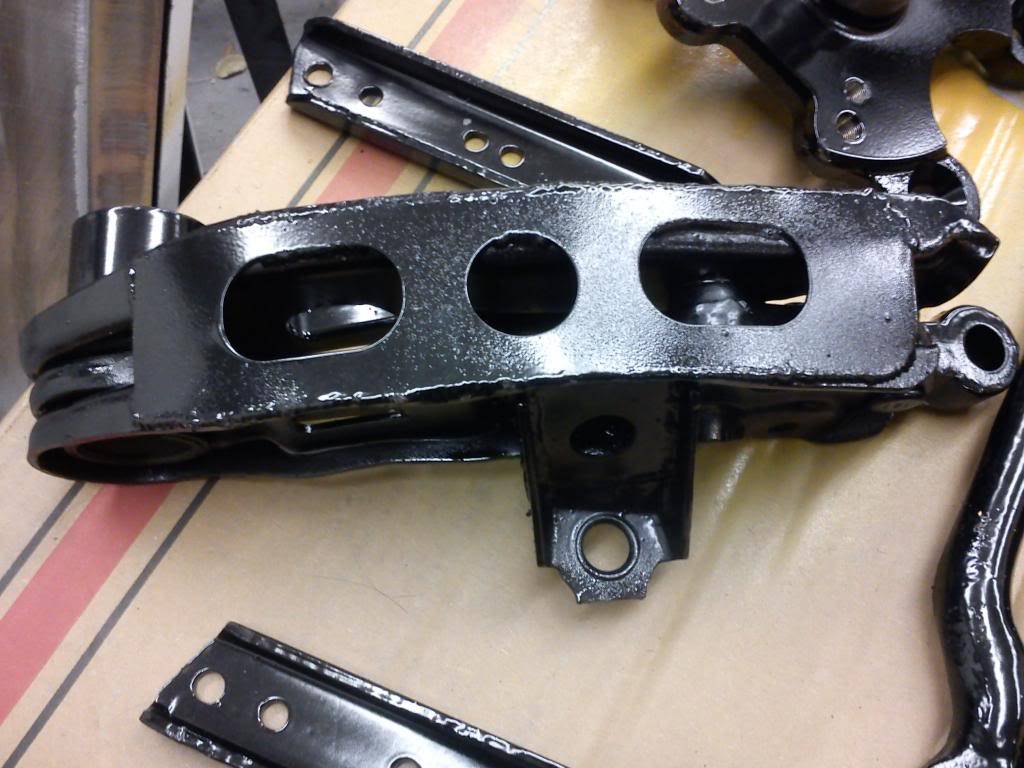

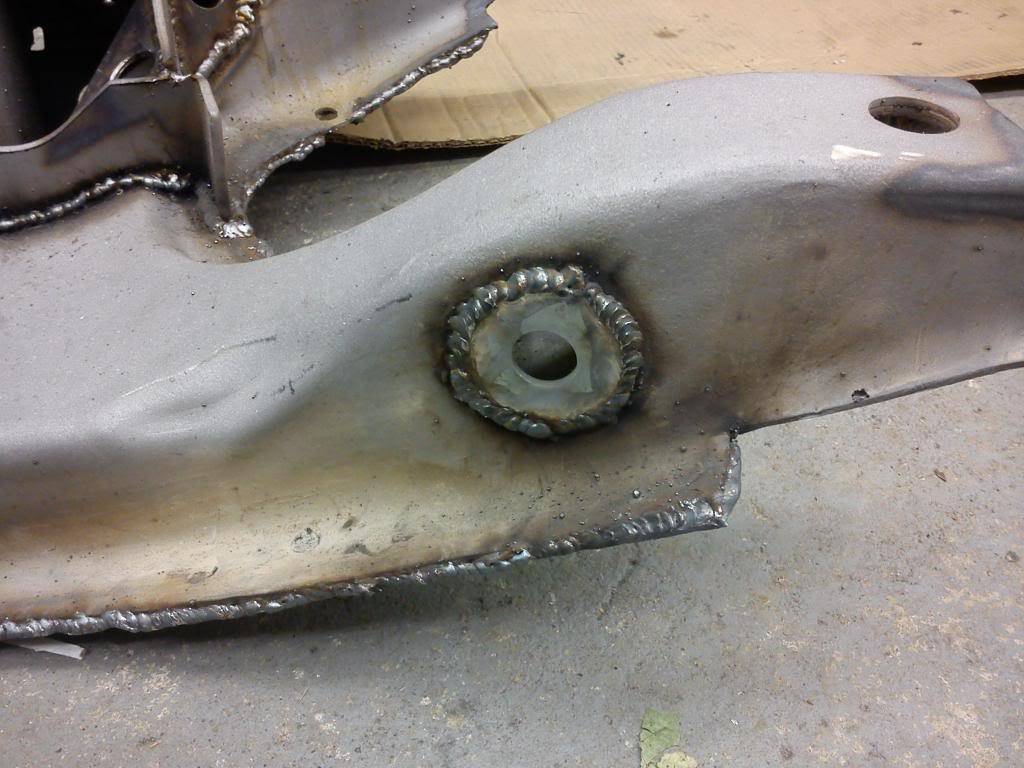

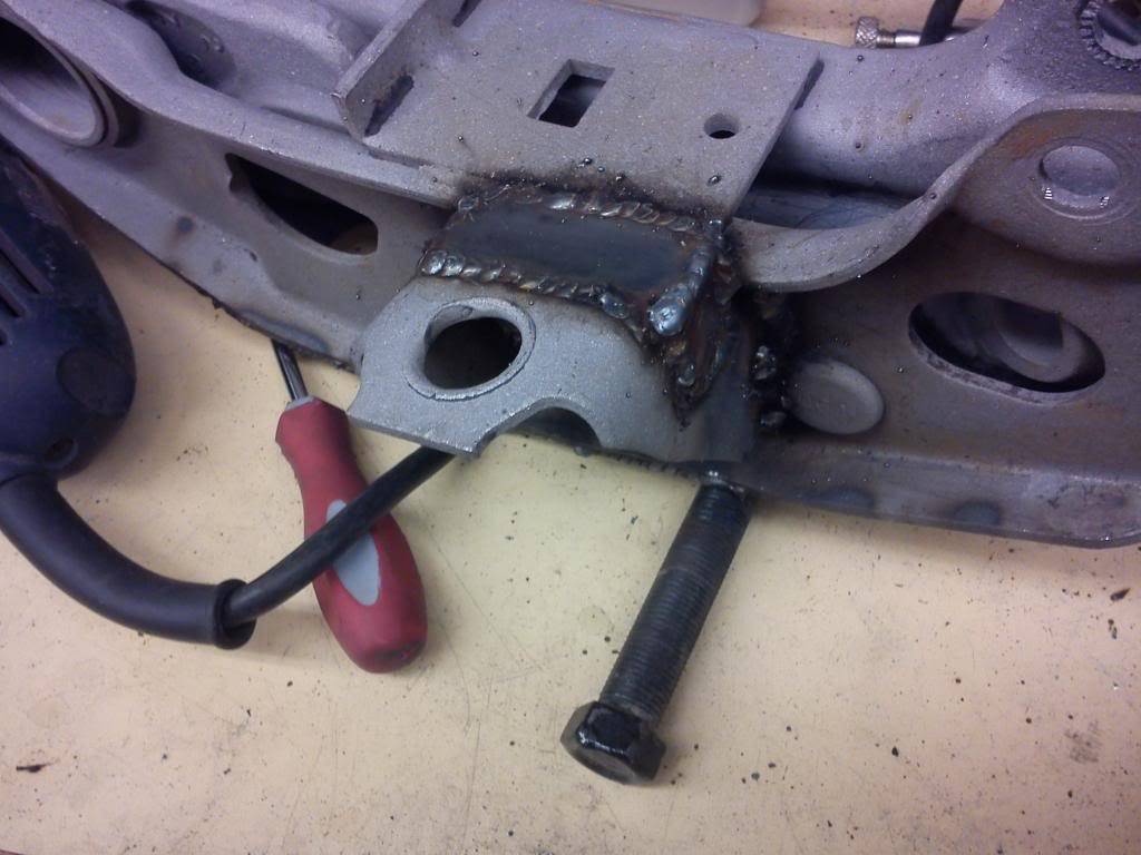

I sent the front suspension parts off for sandblasting but first I had to get the old bushing out of the LCA's - The trick with welding a washer to a bolt, then weld to the bushing, worked really well, so well it only took 2 hits with a hammer to get it out!

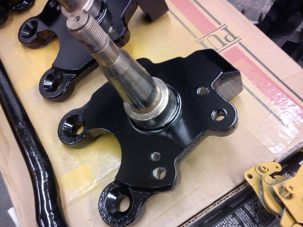

I got my front suspension sandblasted parts back, time to start welding!

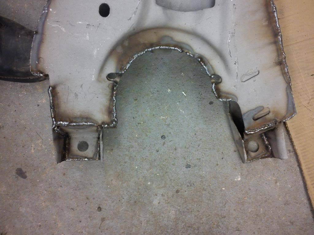

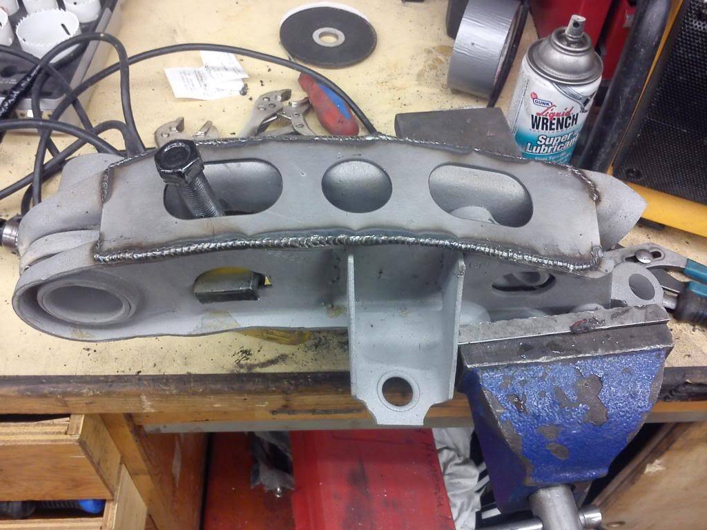

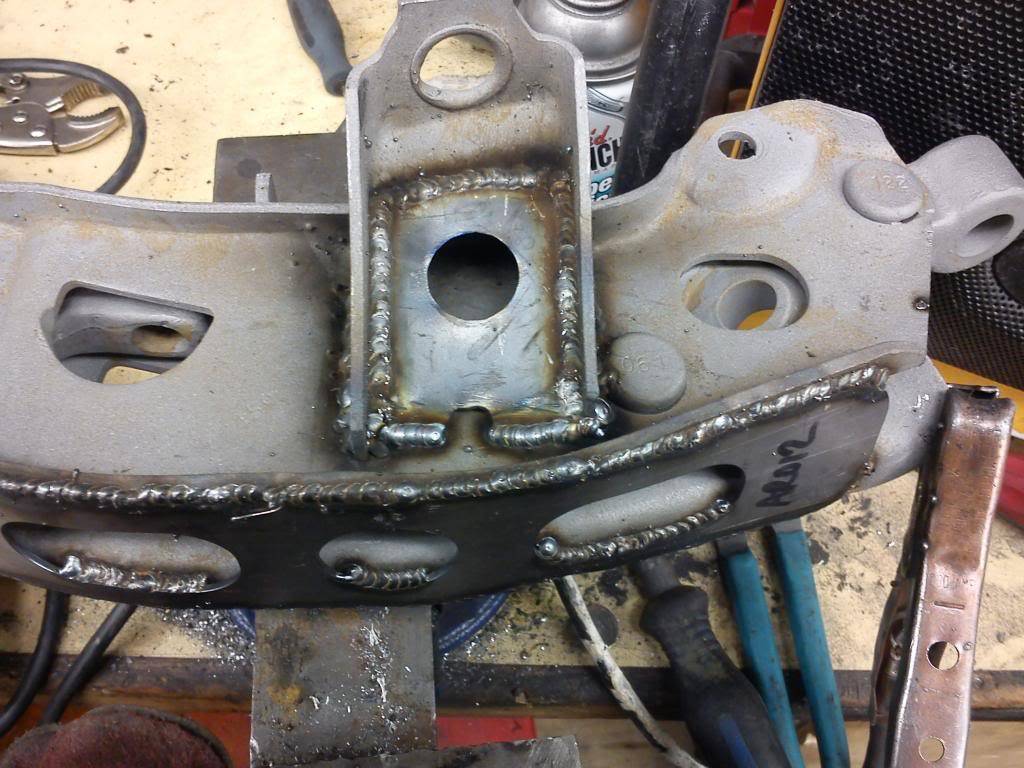

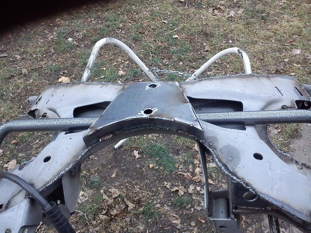

I got worried when I read here or on another forum about a guy who bent his LCA sway bar brackets after he installed his bigger front sway bar, I wish he had a pic of it so I new where it
had bent, so I took no chance and just strengthened where I thought it would happen:

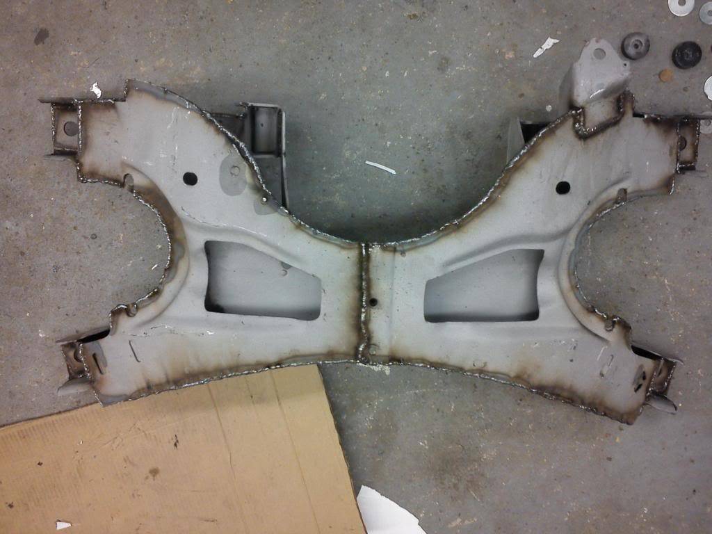

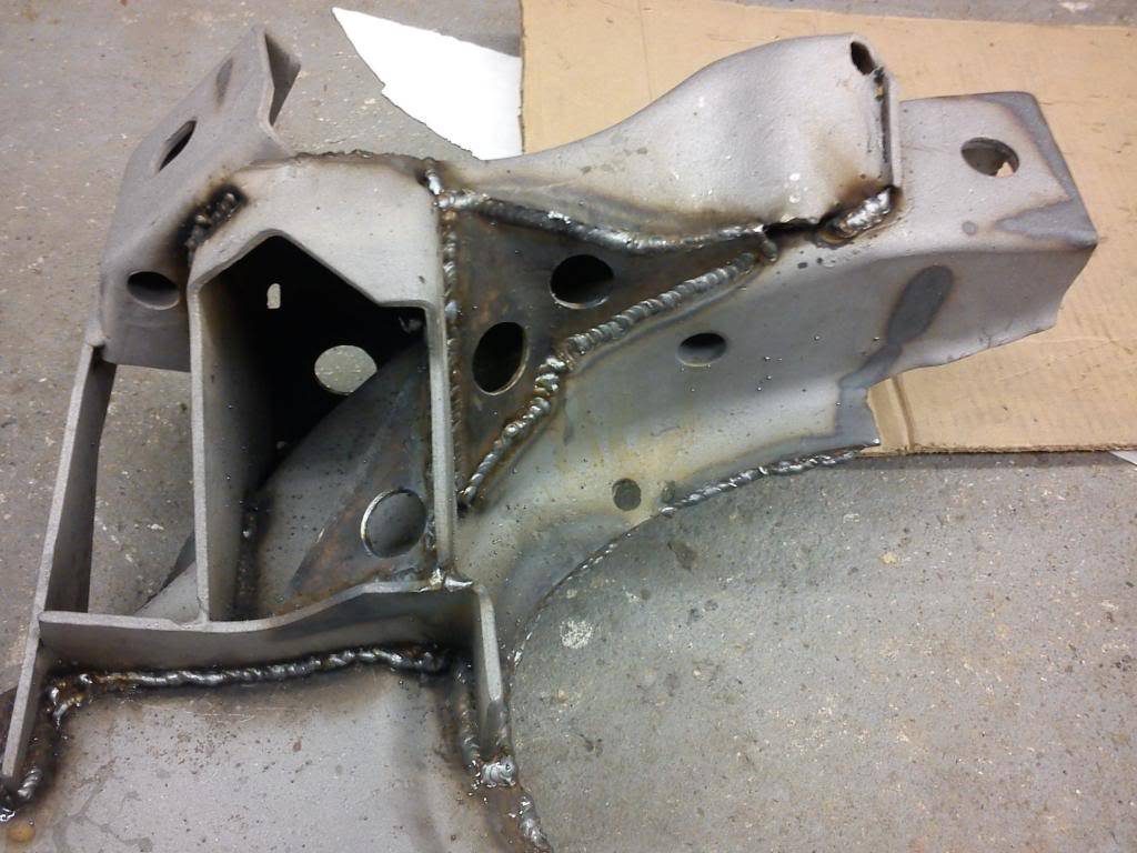

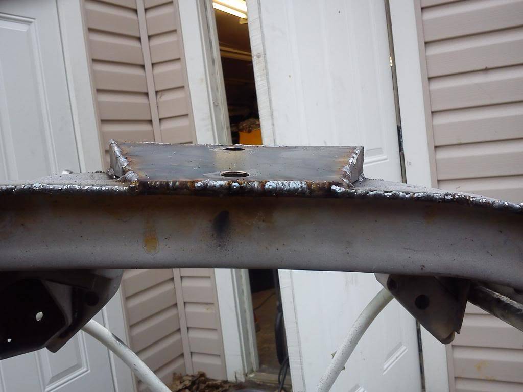

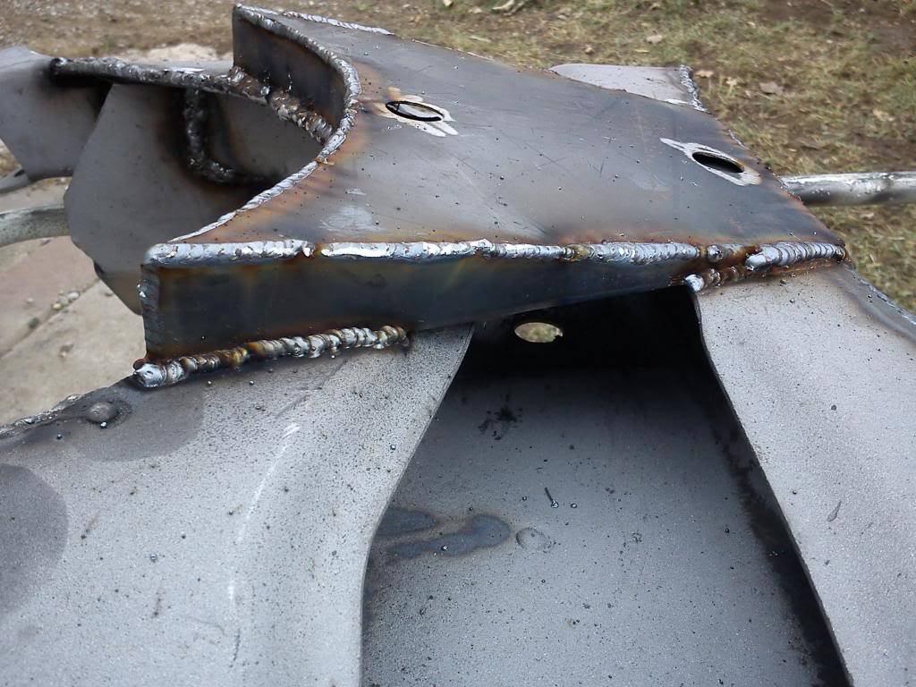

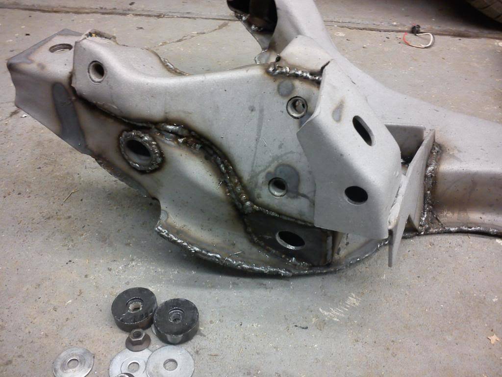

Welded up the k-member and strengthened the areas others have shown on the net, as well as over most of the factory welds:
I built my own skid plate as well, also made sure that i could get my 1 1/4" big hollow front sway bar in there:
And now off to the powdercoaters!
Great idea on taking out the LCA bushings. Those welds look good and stout. Not that you would want to, but you could do a good "jump" and not hurt too much underneath.

Wow... I am looking at a 71 as well.. Is all that boxing really needed?
No, I think he just likes to weld, Must be putting in a huge horse power engine.
Not really lol stock 383 for now, 451 or 470 in the next year or two. I building the car as a protouring car/daily driver. I wanted to stiffen up the chassis as much as possible without putting a cage in...

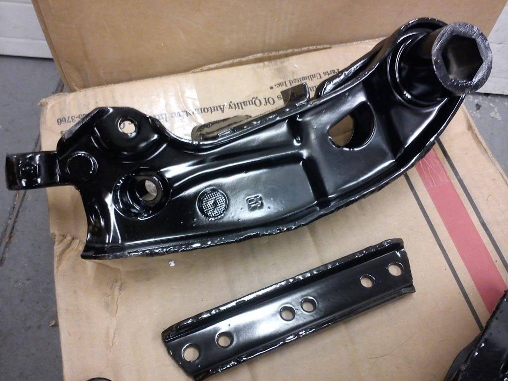

Well I dropped off the K-member at the powdercoaters yesterday, Today I powdercoated all the smaller pieces that can fit in an oven(My buddy has a small setup). For my first time doing it, I can say they turned out pretty good! So good, I'm considering buying a setup for myself :)
