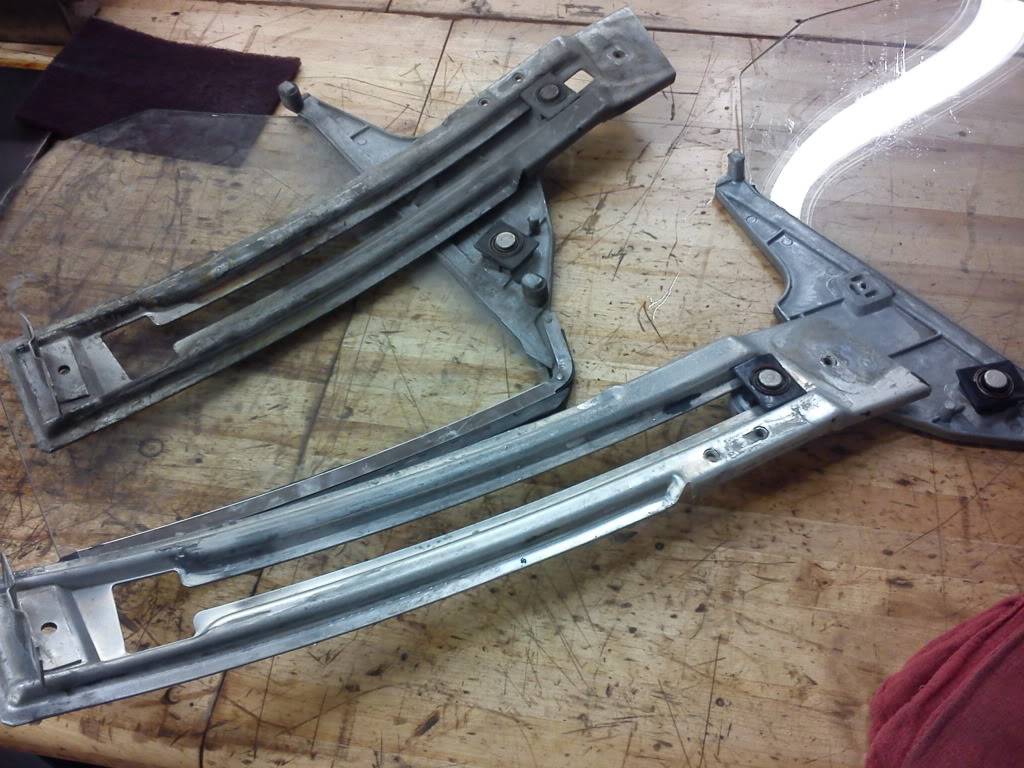

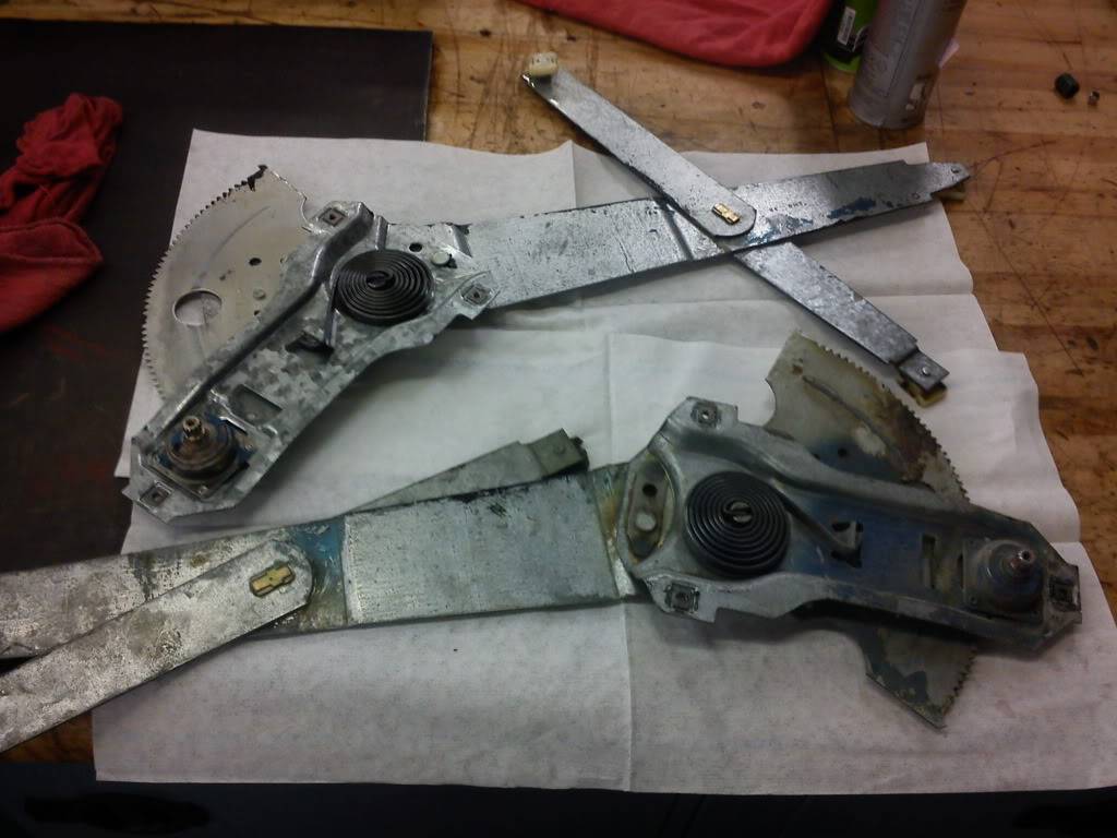

    Started putting the doors together, the regulators were filthy from years of sitting - time to work some magic:
    dirty on the bottom and clean on top!

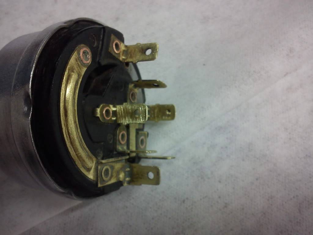

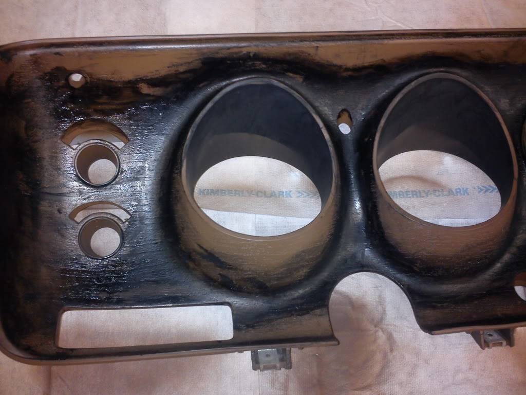

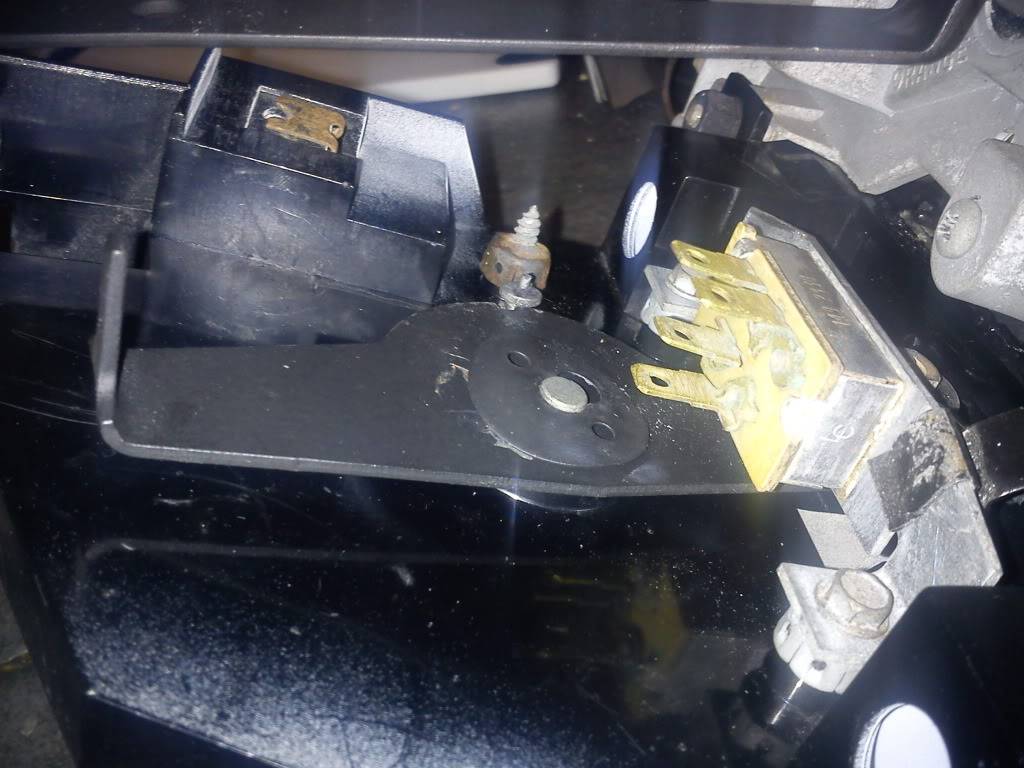

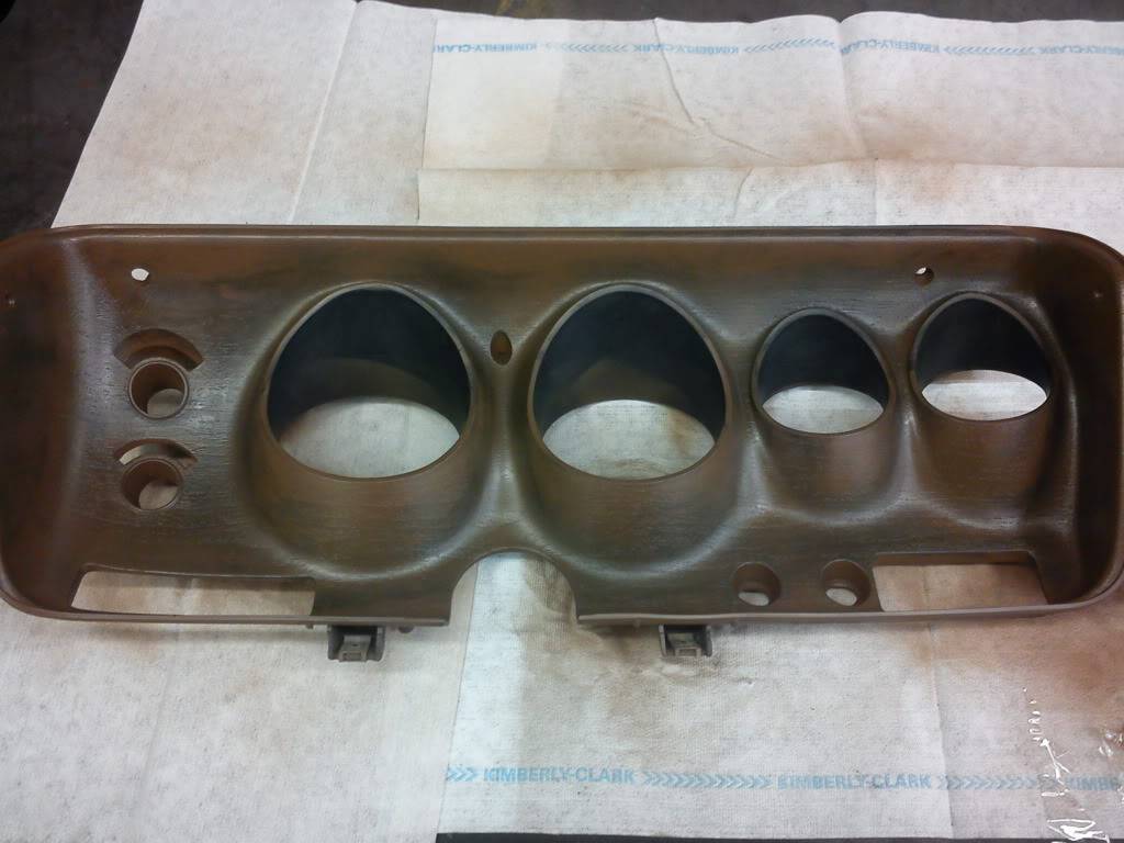

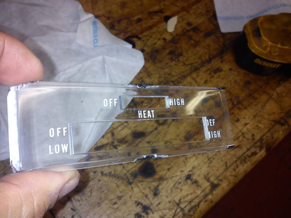

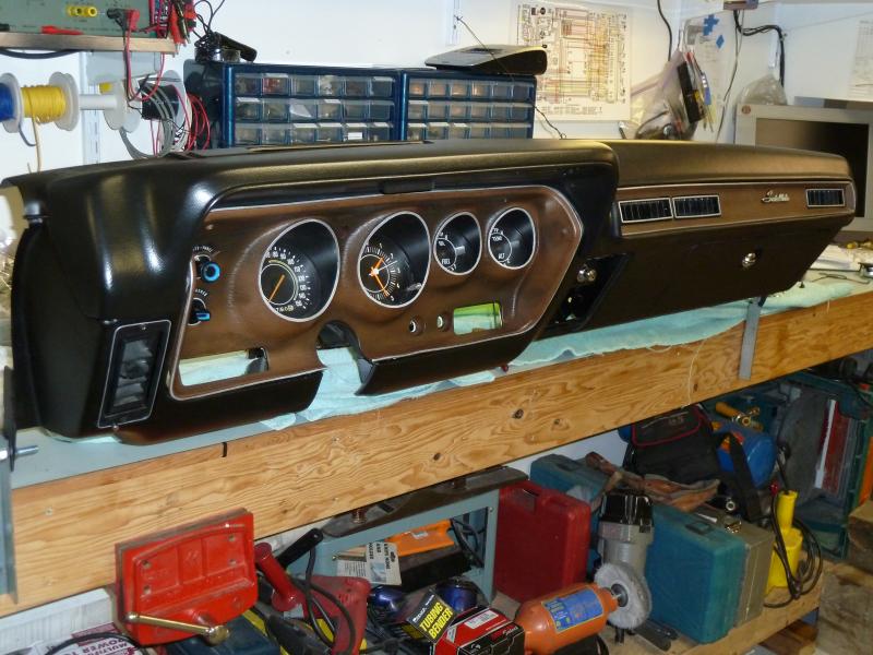

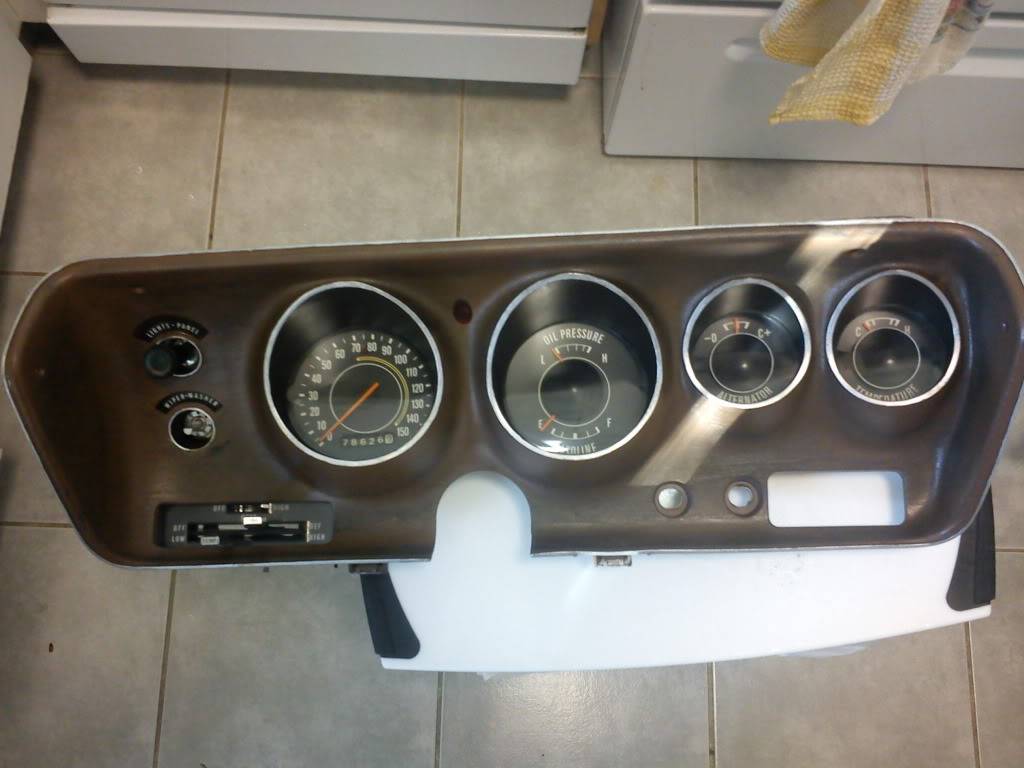

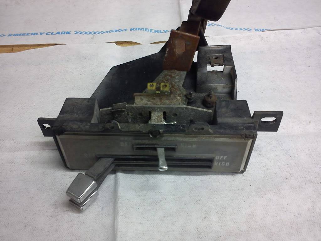

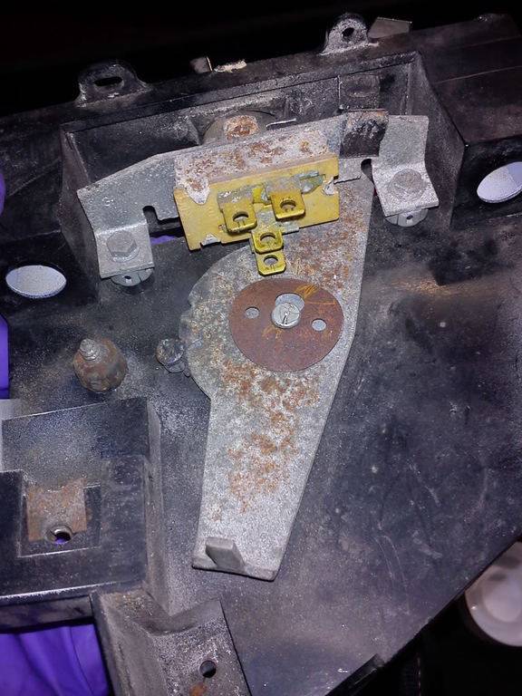

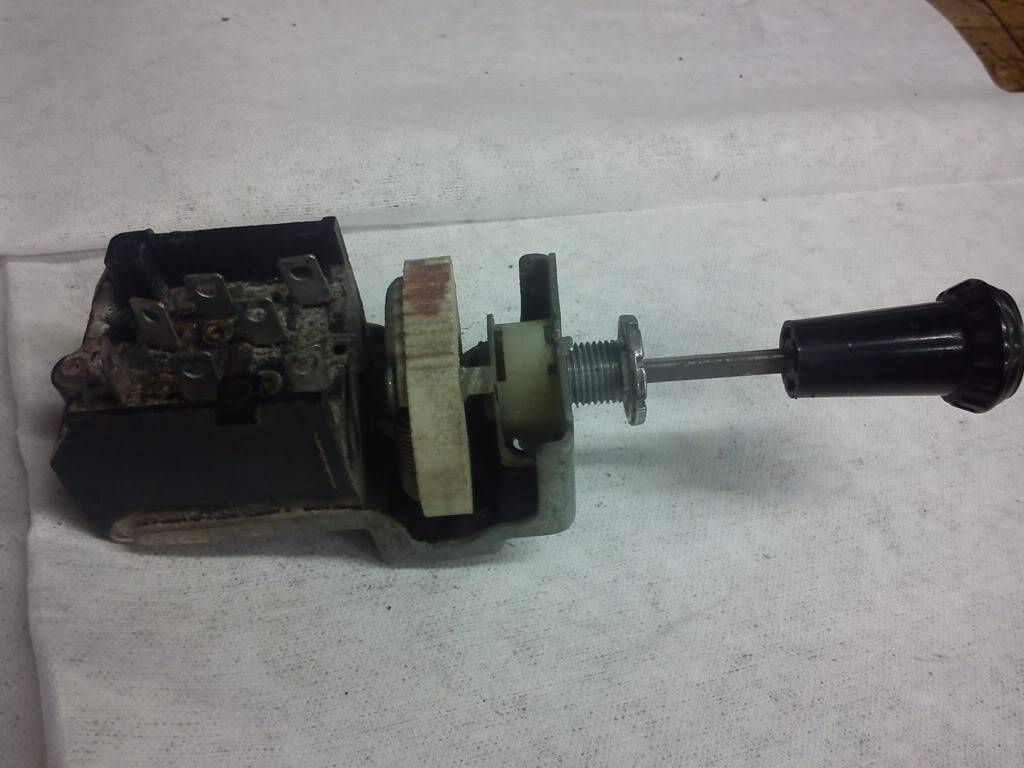

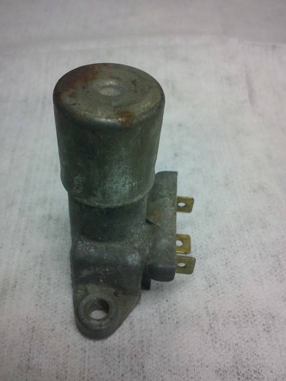

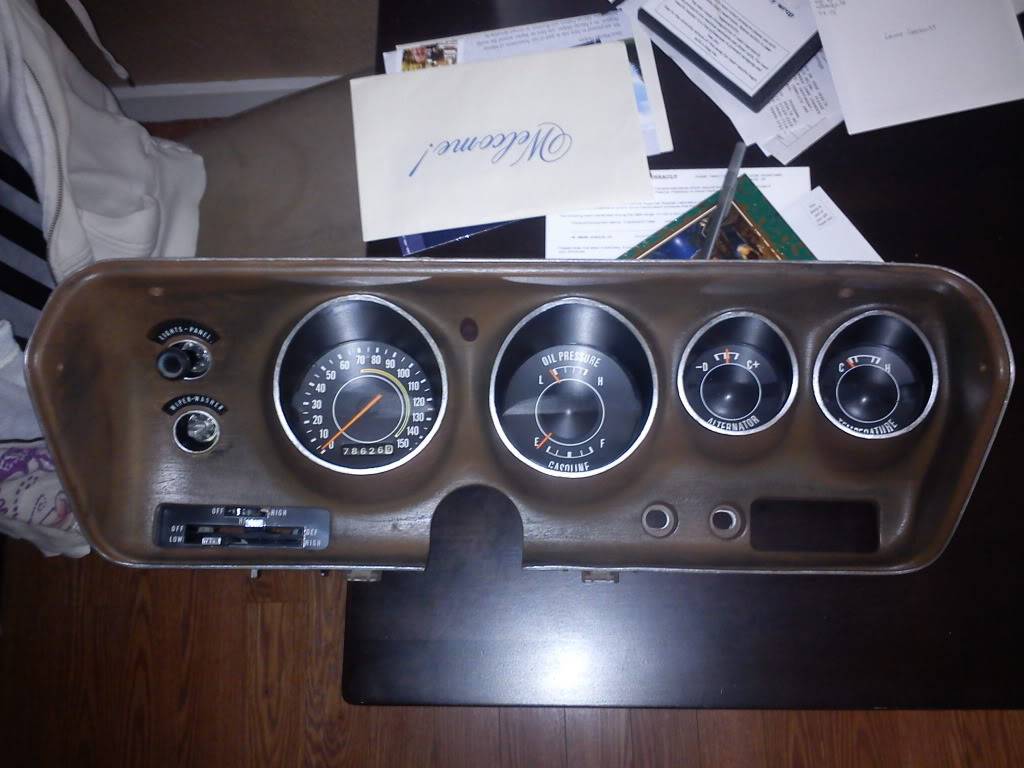

    The big one - restoring a 71 rallye cluster from start to finish. This is how I did it.

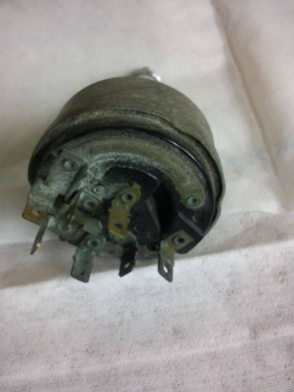

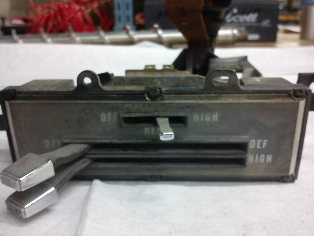

    what i had to start with:
    no more old wiring gremlins!!!

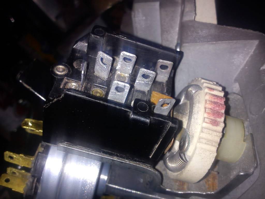

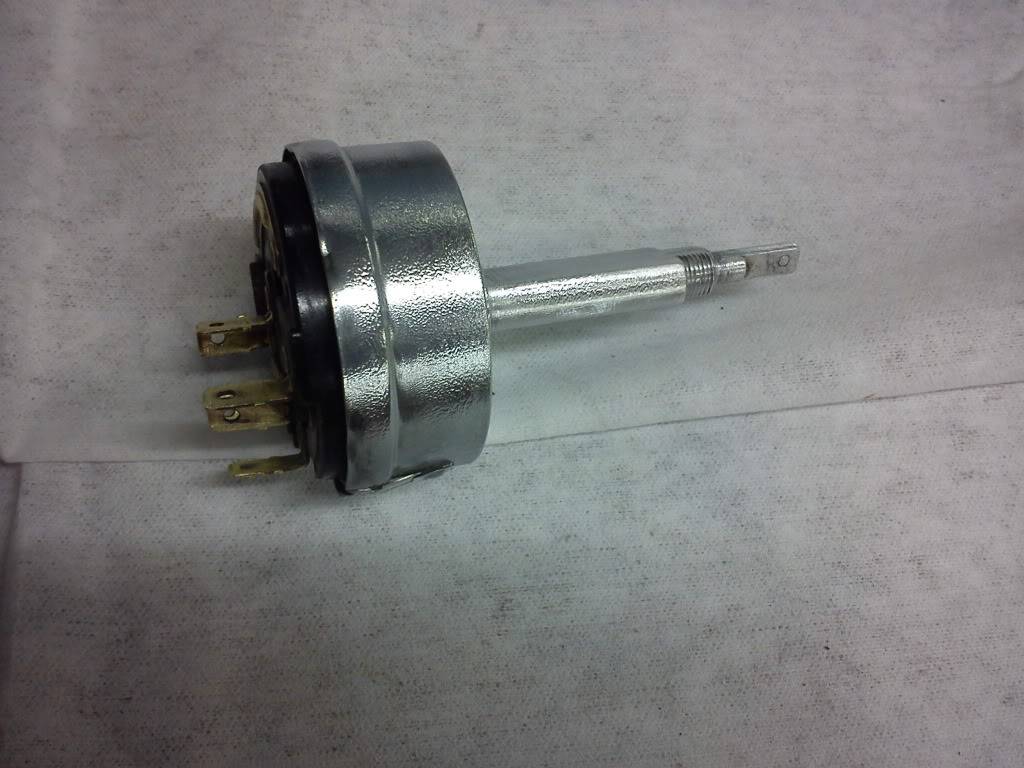

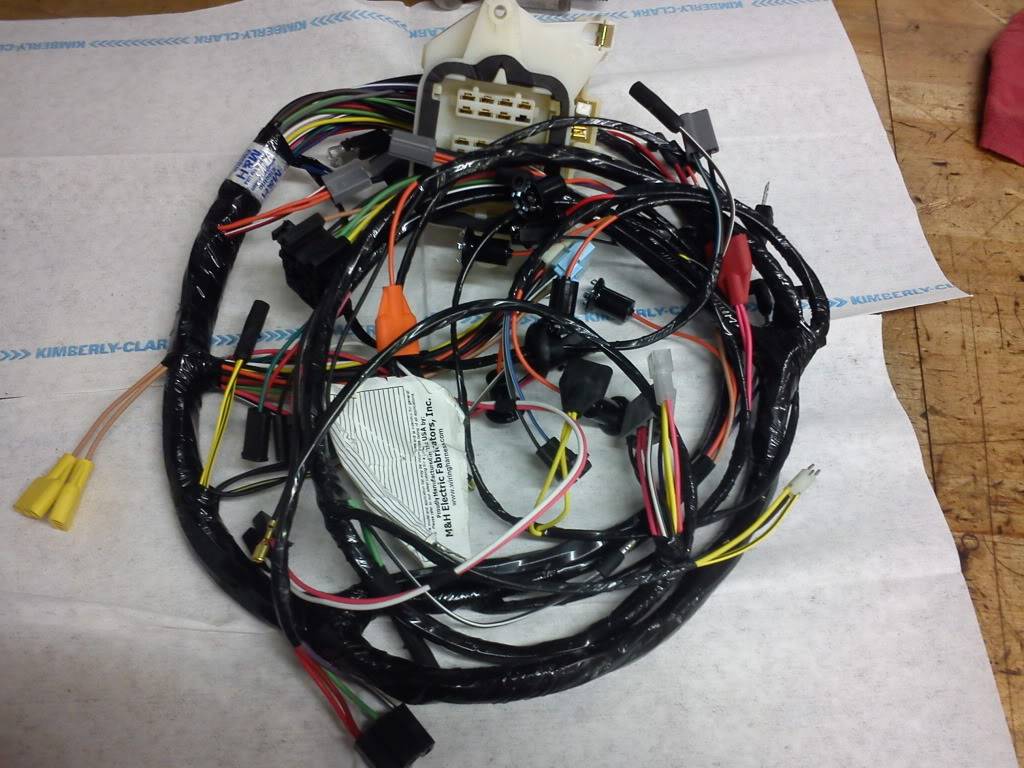

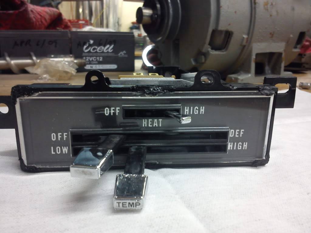

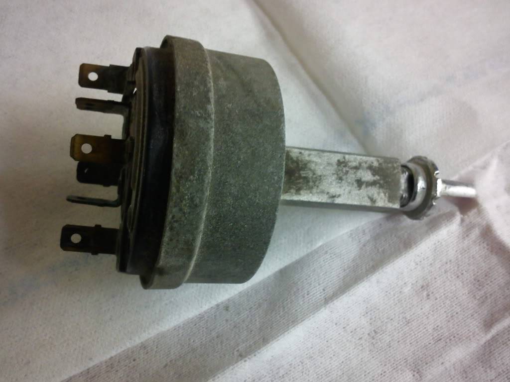

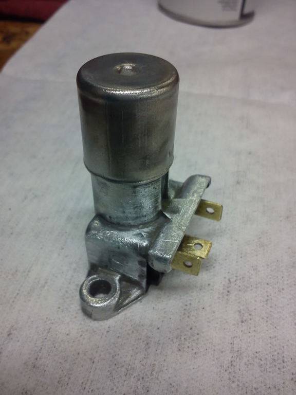

    Light switch:
    high/low beam floor switch:
    Wiper switch:

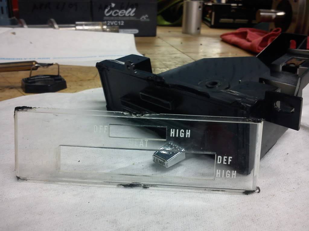

    Temp control:

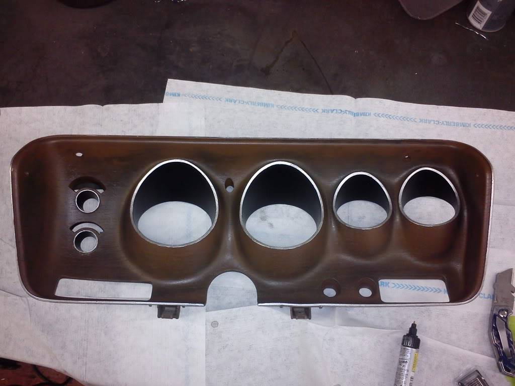

    Now the hard part:

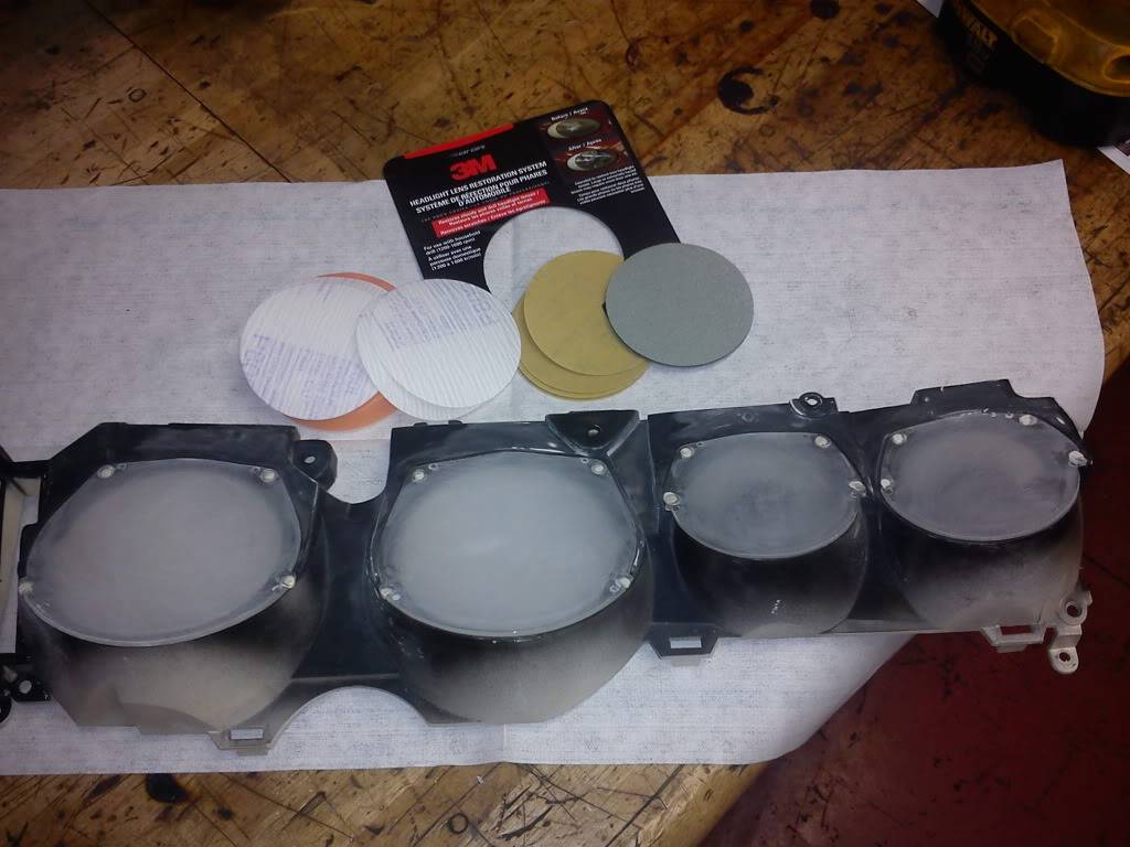

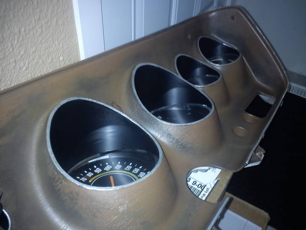

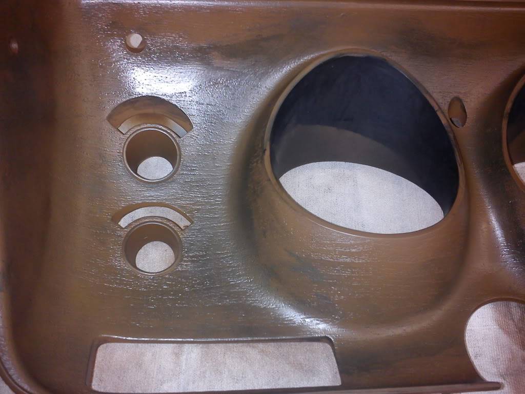

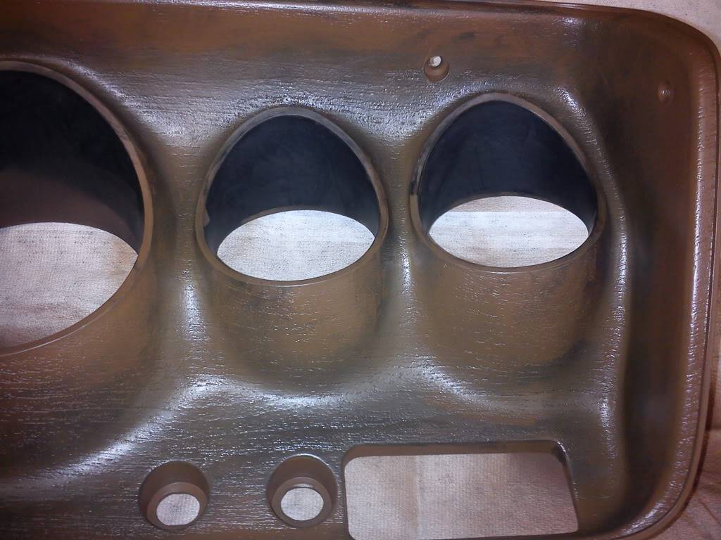

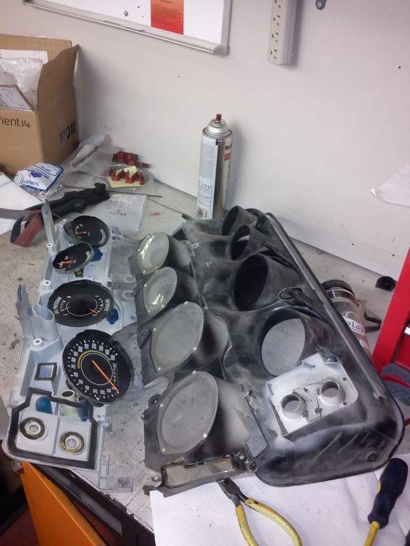

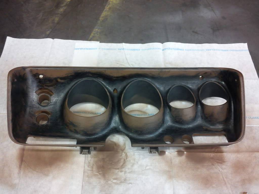

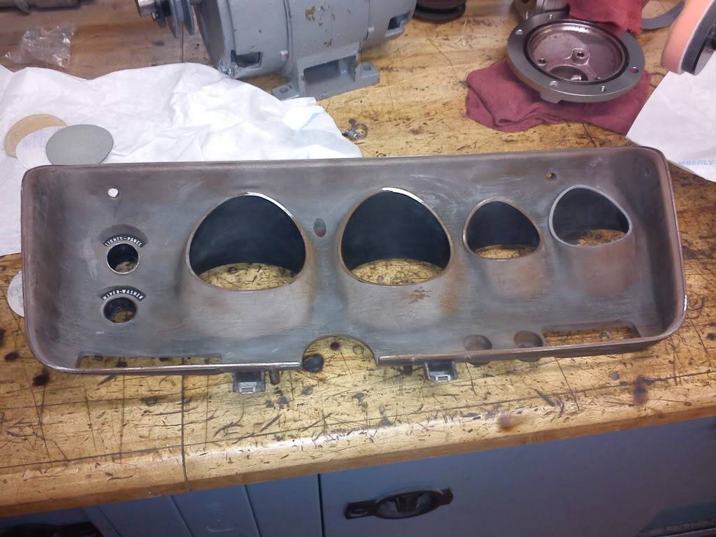

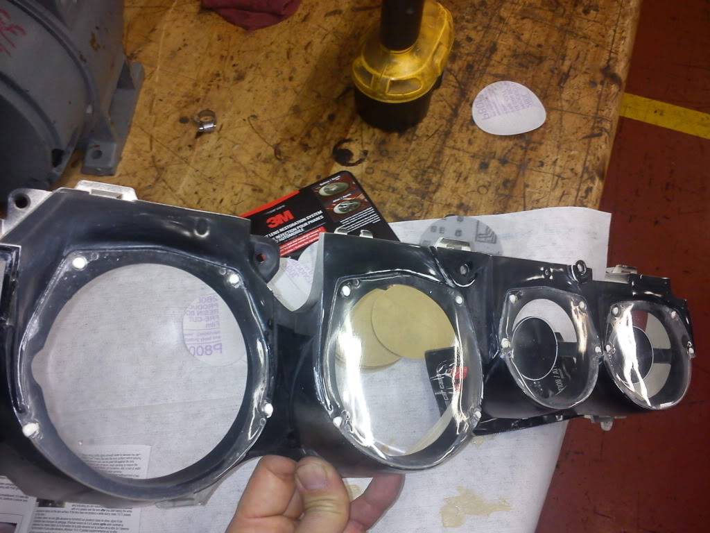

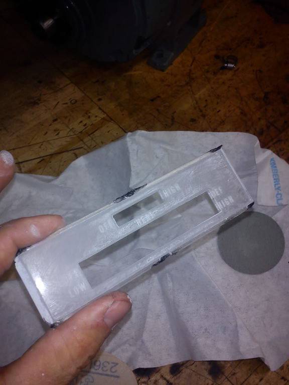

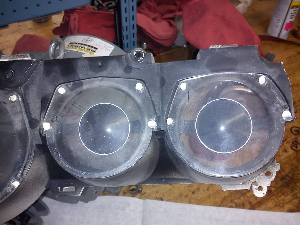

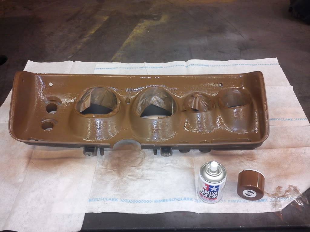

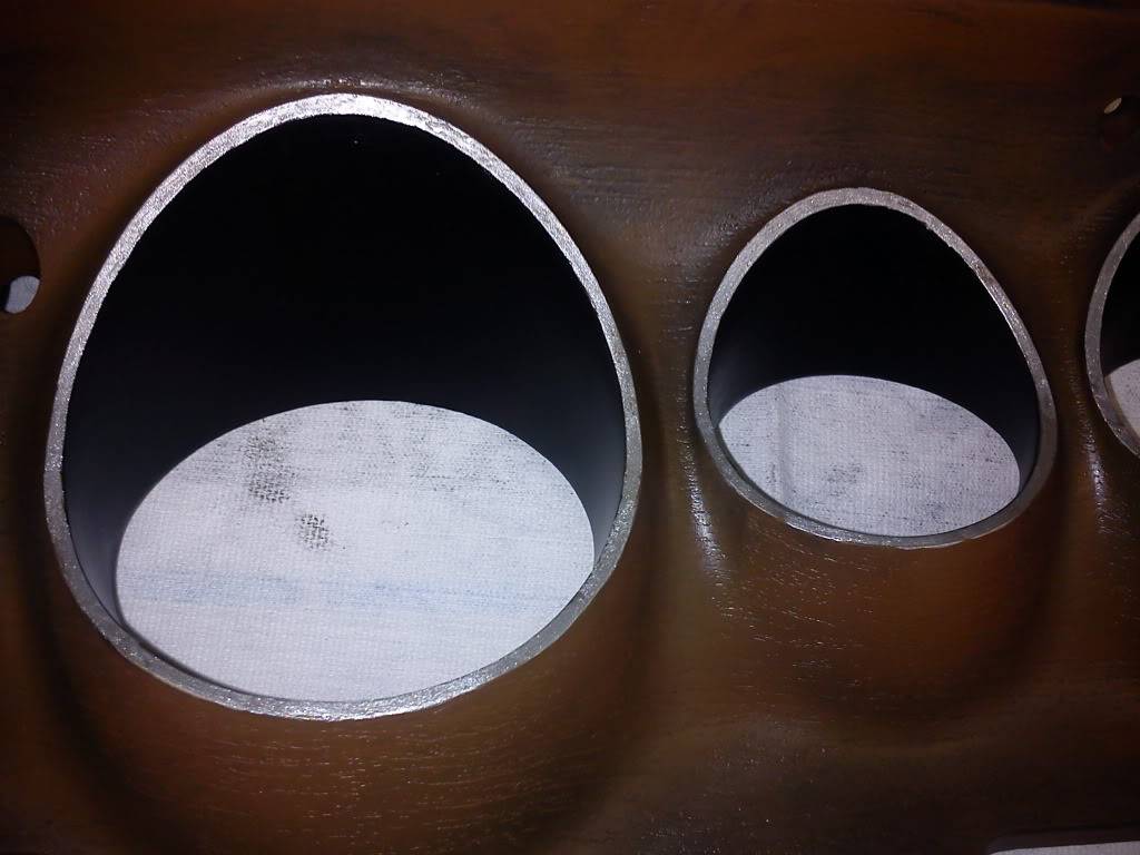

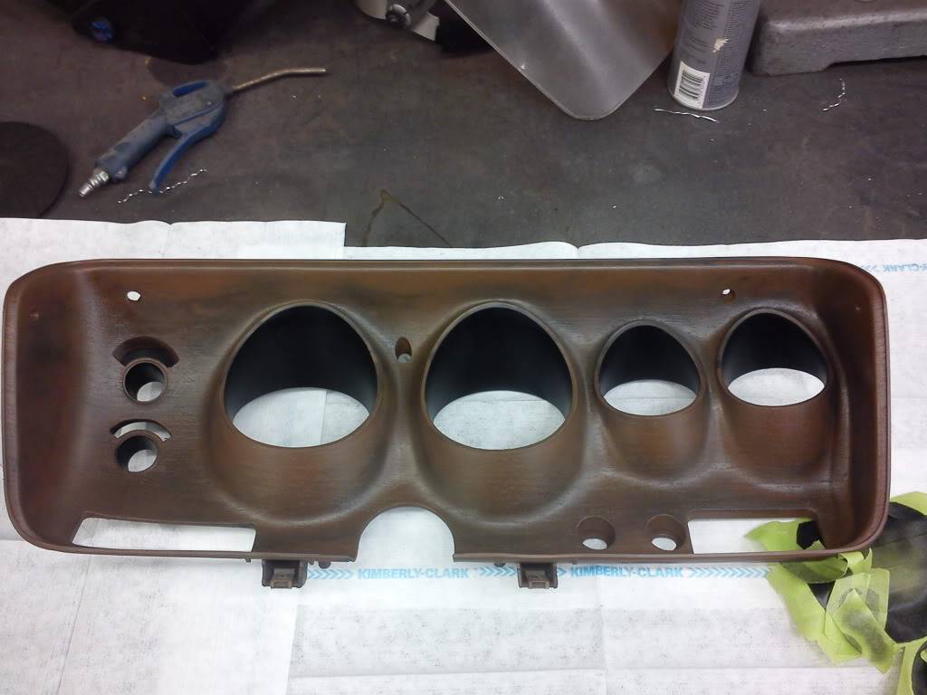

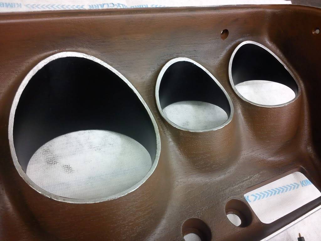

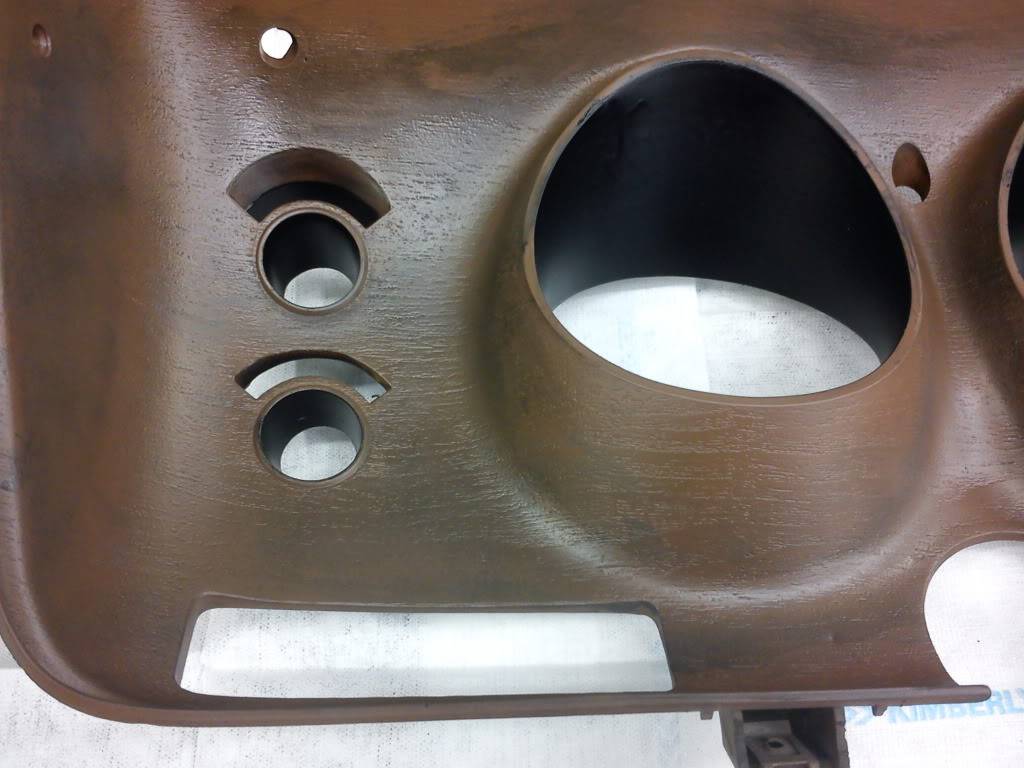

    started on the gauge face plates, I used the 3M Headlight restore kit, I thought "what the hell, they're both plastic, should work for this as well" I also did this to the temp control plate as well:
    Went to a hobby shop and got a paint that I thought would look close to original and this stuff was bang on and it went on beautifully with no runs - Tamiya TS-1 Red Brown. Goes on light brown but dries to what I wanted. First I sanded and painted the whole shelll:

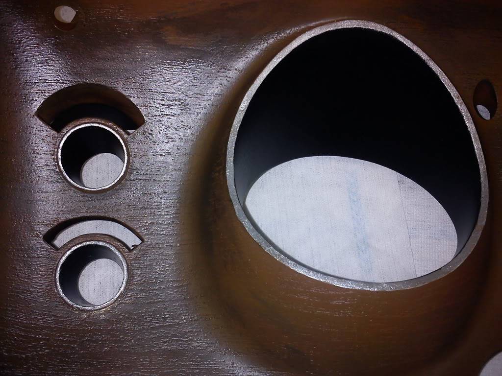

    I wasn't sure how to get the black in the wood like on the original, so I improvised, I thought if I could paint the background in a matt black and paint over top it might bleed through the paint. I used a acrylic paint which was messy to work with and it ran like crazy and pooled up alot so i had to keep wiping it down so the layer wouldn't get to thick, It was a PITA and I reccomend a different method but it ended up in my favor, I tried fingerpainting all the areas where the black was on the shell:
    Next I painted a very light layer of the red brown again:

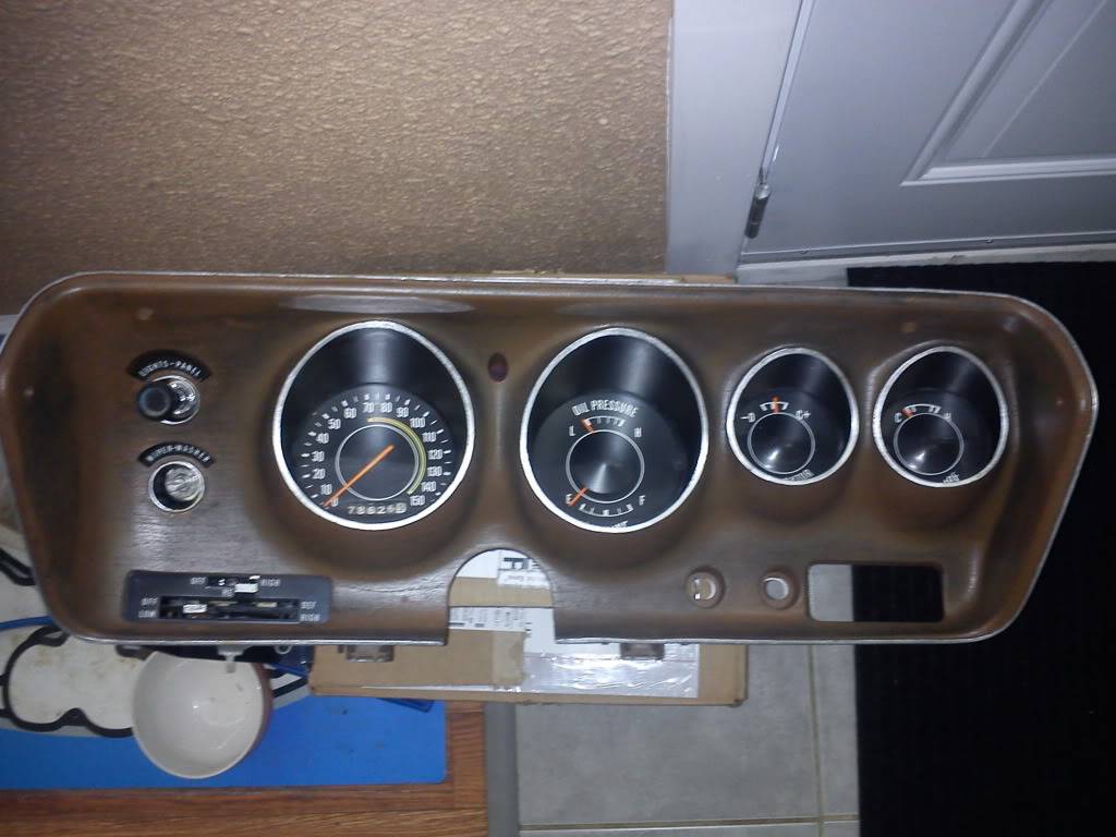

    next I sanded the gauge pods and wiper/light switch areas, masked them and painted them a semi gloss:

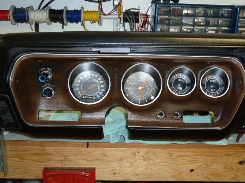

    Now this was the most stressful step of them all - applying the silver to the outer edges of the pods, switches and shell, I used a automotive GM Silver, comes as a 2 for 1, light bruch or can be used as a pen, i used the brush. It is hard to work with, you have to keep moving in one direction and it with thicken up on you if you overlap the previous area too much (it starts to dry pretty quick) This would be easy if you were a pin stripper, but for us joes its passable and didn't end up to bad:

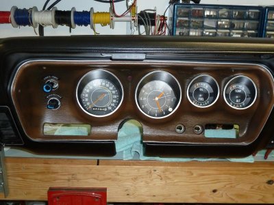

    Now all together: (I tried taking different pics in different light)
      G'day Dangina. You're not giving yourself enough credit. Your attention to detail for a common "joe" is awesome mate. I've only just picked up on your project after Roadrunnerman put me onto it for the sound deadener in the roof. You're doing an awesome job, and your tips and photos on restoring the dash and controls is something I'm gonna try and follow, I'm just not sure my patience and attention to detail will be as good as yours. Well done on a superb resto (luv the colour combo). Congrats on the little one. :VB toast:

        Great job! Everything cleaned up real nice and your cluster turned out great.

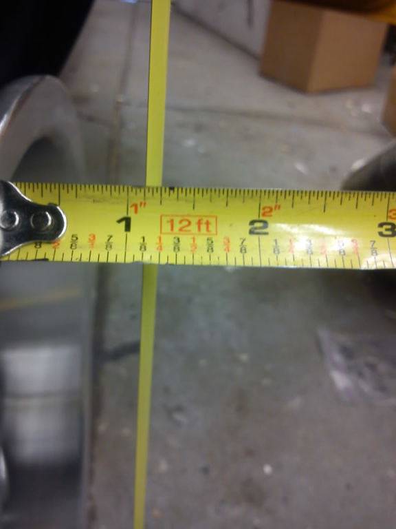

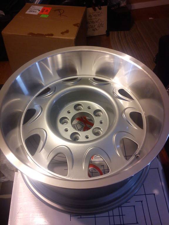

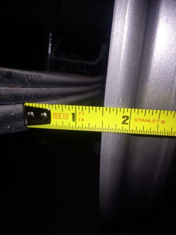

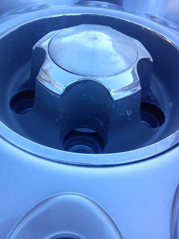

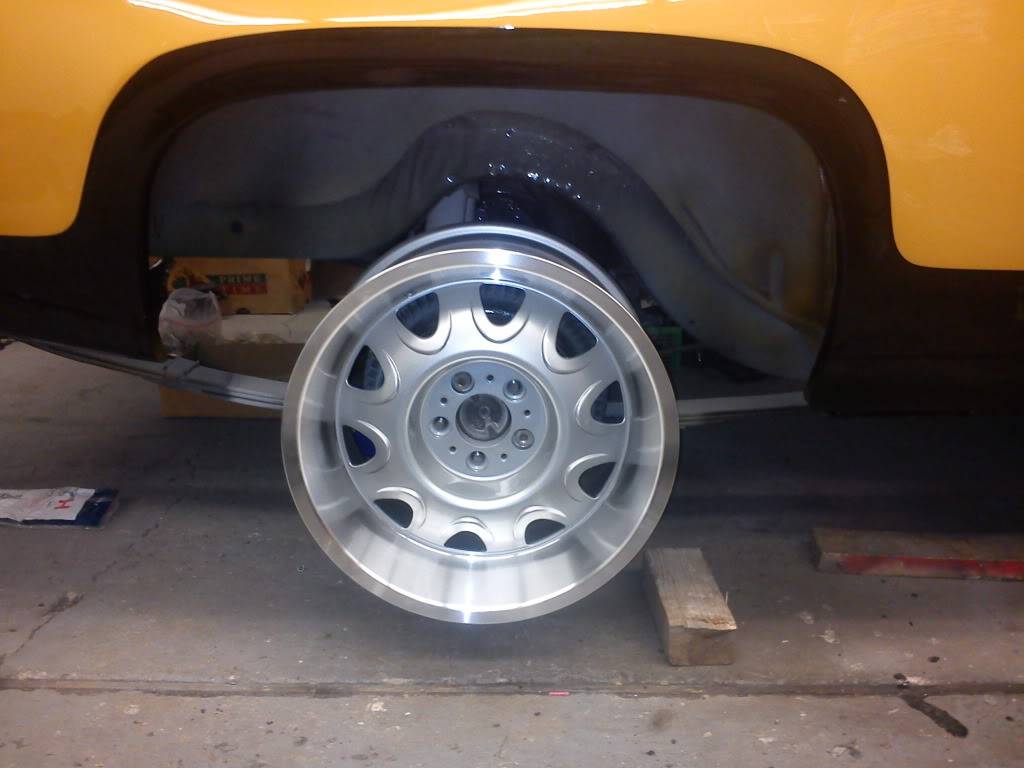

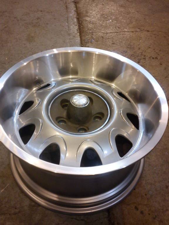

        I got the new rallyes from year one :
        1 1/2" clearance to the rear springs
        1/1/4" to inside front lip I ay get a 1" spacer down the road:

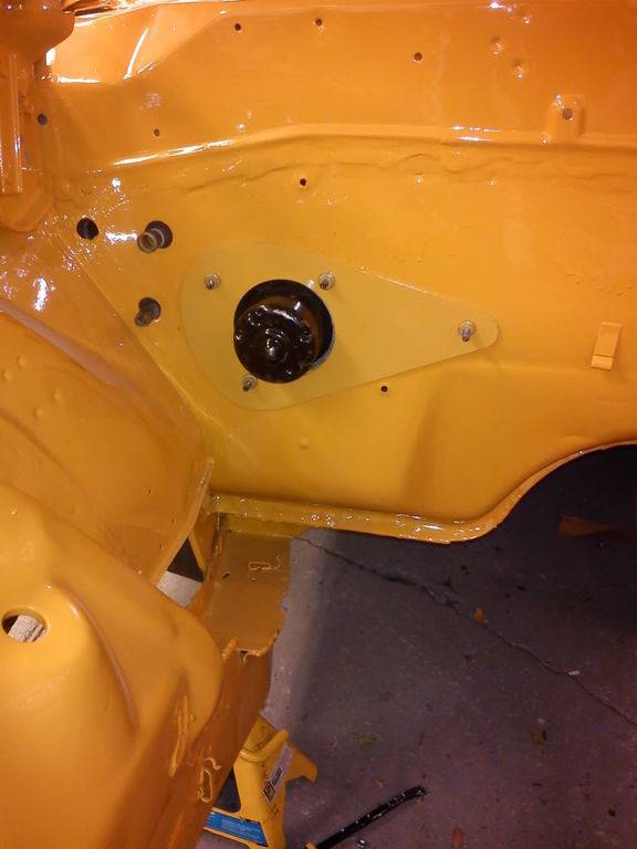

        My firewall was cracked when I first bought the car I figured it was because of the heavy heater core being held on by 4 screw heads and nothing else, So i ade a pattern and took it to the metal fab shop here intown and made my own aluminum plate so all 4 points are on the same plane - its made from 1/4" aluminum!

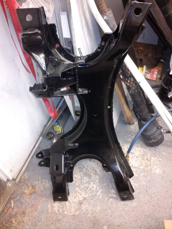

        got the kframe back from the powdercoaters!

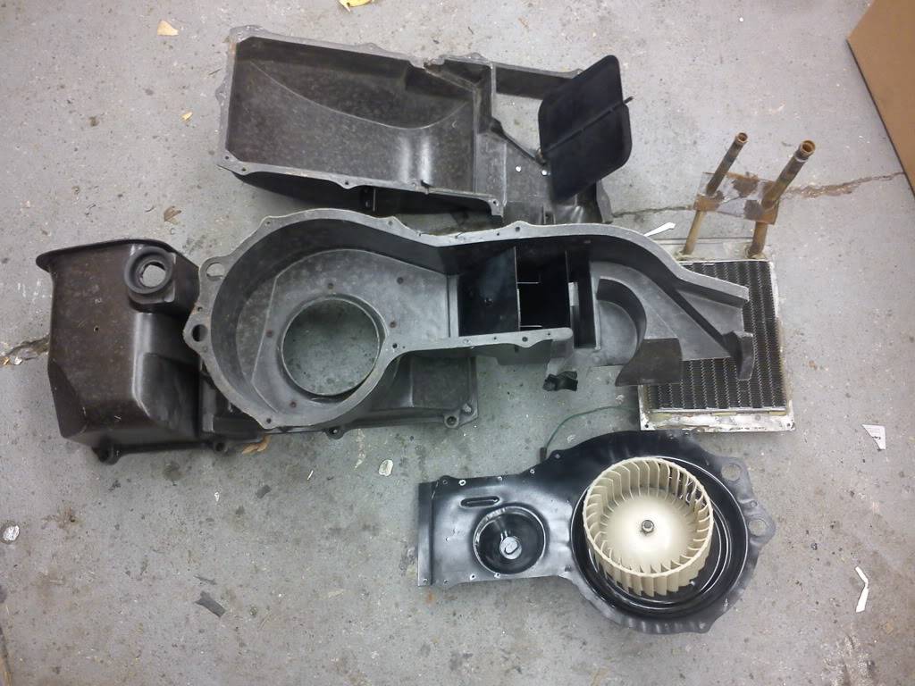

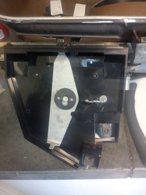

        cleaned up my heater box, put it together, sealed it, new weatherstripping, good as new!

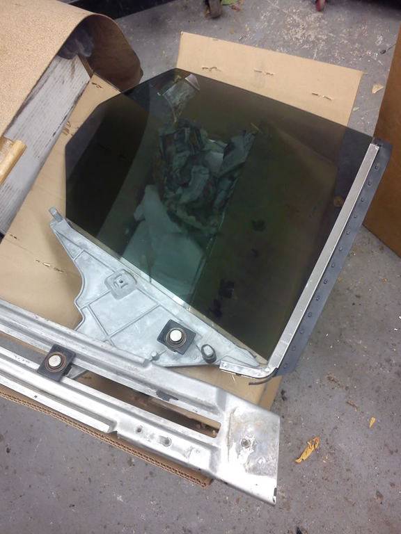

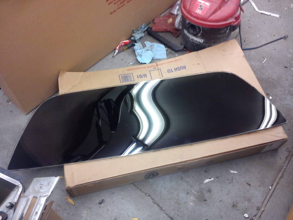

        got my quarter windows tinted with factory tint:
        rear window with limo tint

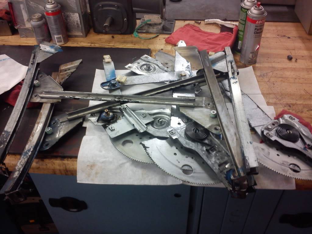

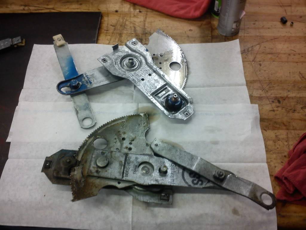

        cleaned up my rear window regulators

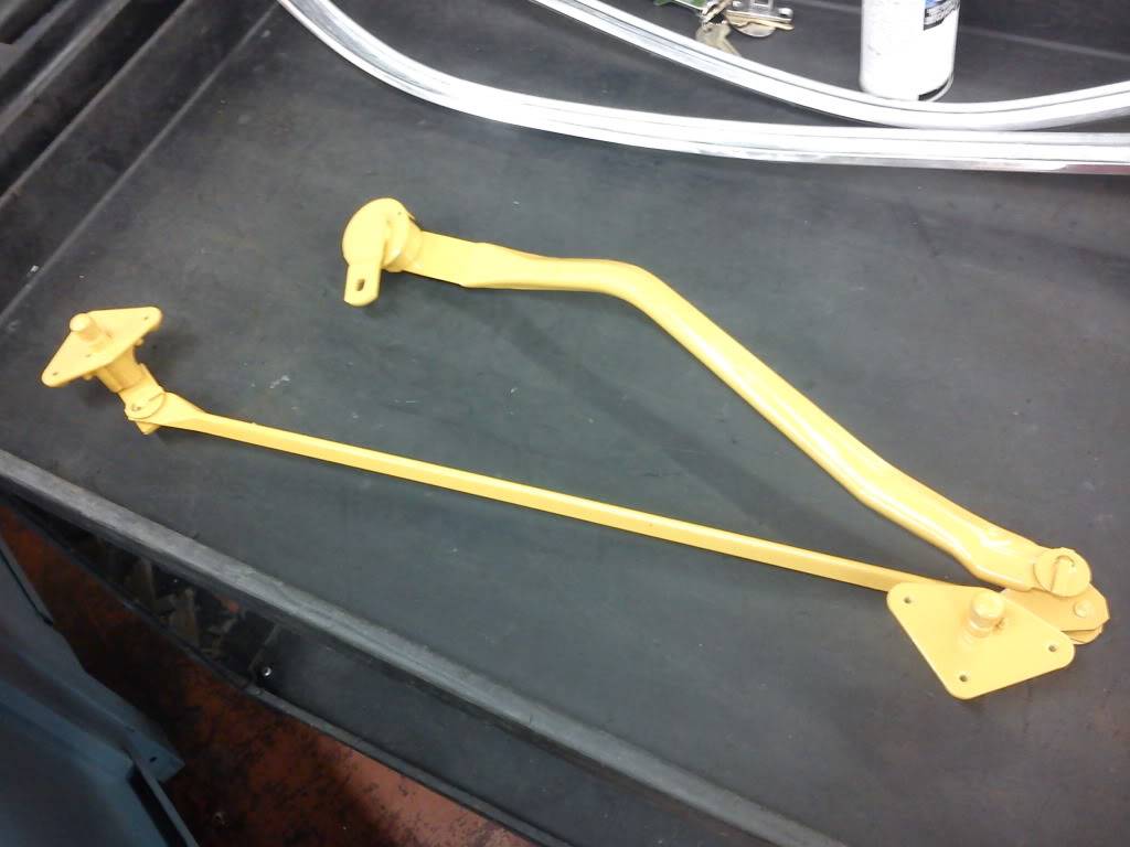

        painted the window wiper assembly - looks darker in person:
        I have the windows in, just wasting so much time aligning them up - I never wanna do this again when its over - i probably wasted at least 3 hours per window. will take a pic when finished. Also have the underside of the dash finished but I was gonna go with a stock clutch setup but now I'm thinking hydraulic. More posts to come...

        Those wheels look great. Are they 17" billets? Nice job on the extra heater support. Are those windows tinted 30%+? Window regs look good. What did you use to clean them up? The photo makes those wiper rods look bright for sure but they still look good. How's the new baby doing. Should be getting pretty big.

        i really admire your innovation with your entire dash assembly. looks friggen sweet!

        Thanks! was getting worried that it wouldn't turn out.
        They are cast aluminum, and yes I believe that they are the 30% tint for the side windows. Baby is getting big and long! thanks for asking!

        Everything is looking great, I cant get over how nice you got the instrument lens all cleaned and clear as a windex-ed window. Those Year One rally's look great, cant wait to see them with the tires on them.

        good job on the dash, your car is looking great - I just finished my dash as well. I thought share how I got mine rejuvenated as it looked exactly like yours in the first pic posted, kind of faded & almost chalky looking - it had me wondering how i was going to get it looking better. I washed mine up really well with dawn dishsoap & let it dry, I also thought about painting it but really was hesitant to put much build on it so I thought about clear coating it but didn't want high gloss.
        I found this at Lowes of all places - Valspar clear satin enamel:
        http://www.valsparpaint.com/en/find...spray-paint-1/premium-enamel-spray-paint.html
        This stuff was amazing, I tried it first on the vent insert for the dash as I had an extra & wanted to see how it finished out, came out great so I did the dash face with it, 2 coats & its beautiful - no messing with paint at all!
        Keep up the good work, project looks great!

            what did you use to do the silver lining? looks stellar! absolutly love this thread

            Great job on the dash, I have to admit when I was scrolling threw the pics I thought "that looks like hell" then I got to the end and was thinking "WOW that really came out nice". Love the early 70's RR.

              Incredible job, I hope my Coronet turns out half as well. I know I'll be using some of your ideas in my project. Thanks for posting
