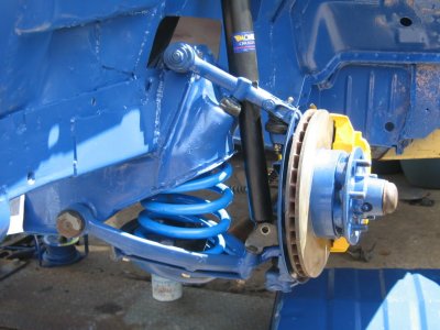

When I started on the rebuild there was no Internet and Mopar parts were hard to buy in Australia so I decided to go for a XJ6 Jag front end to fix the poor brakes & steering problems the RHD conversion had caused.
To fit the Jag crossmember the 440 needed a modifed Truck sump but otherwise it was a easy fit.

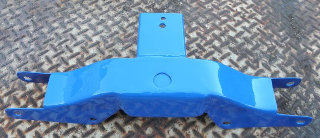

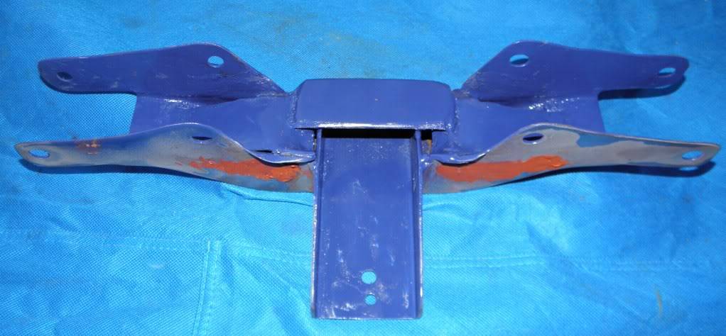

Remade the gearbox mount and raised the gearbox back to original position.
Smoothed and painted

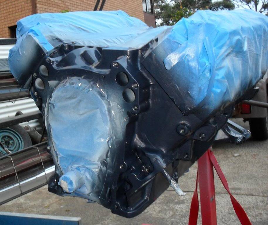

Painted the engine Galaxy Grey custom mix (blue/red pearl added), originally Hemi Orange but it looked out of place in the Blue car.
Mocked it up to see what it will look like when finished

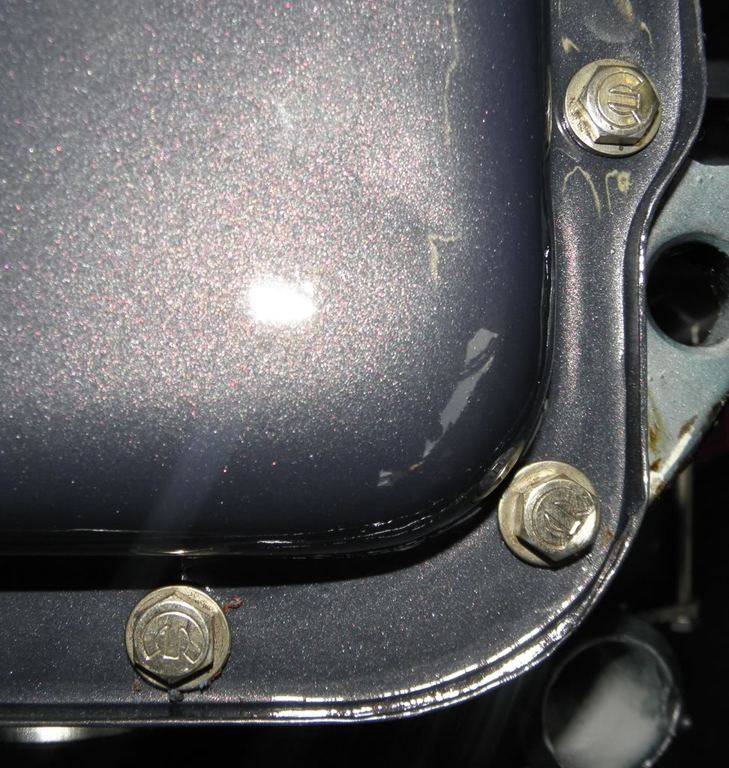

Was going to chrome the modified truck sump but when I paint stripped it there were too many scratches & small dents so I painted it instead.
Now bolted up and nearly ready to put back in the Satellite
I even lined up all the "M" on the S/S bolts !! You can see the pearl in the paint in this pic.
