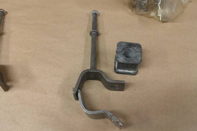

Hey Mopardog, here are the ones I used from firmfeel, but these are for 73, not sure if the mounting plates are the same for 72 or not. Hope this helps.

Parts came in yesterday!! woooowhoooo! After looking at everything, it would appear that the 72 mounts up the same way as the 73, thanks again idrivemopar for the awesome pics. will try to get pics of my install.

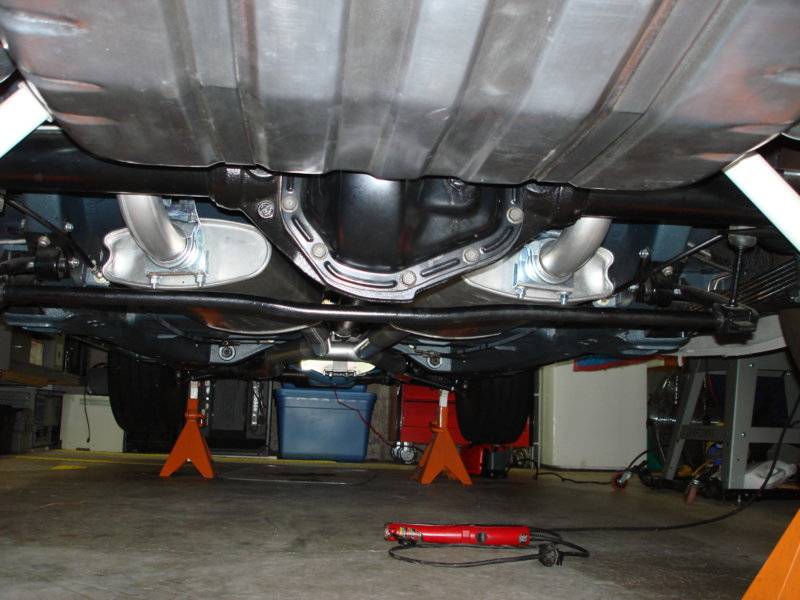

rearend5.jpgrearend6.jpgMy 72 setup isn't like that,found all my bushings with a bunch of searching on Ebay

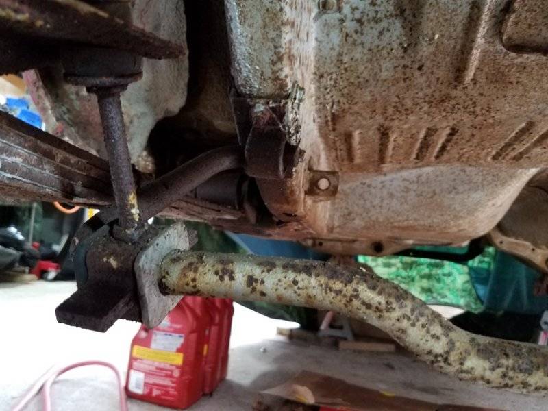

Hey, I wanted to revive this thread because I am having the same issue finding the rear sway bar links and bushings. I can't even find the rear axle bumpers anywhere online, so I guess I will try to reuse the old ones. But unfortunately, one of those sway bar bushing links sheared on me, along with a stud on one of the mounting brackets for the sway bar. My setup is just like RJS's above. In searching the service manual, I can't even find a single reference to a rear sway bar. Did not many 72's come with them? Was it special because of the Dana 60 rear end?
I have an email in to firmfeel.com to see if they can help me as well, but I'll take any other help I can find. Here are a few pics.

All ’72 Road Runners came with rear sway bars. The Dana bar is different from the 8 ¾” bar and is rather rare these days, only 219 of them on the Plymouth side. The rubber parts and links are the same on both bars. Some hardware parts are also in common with later years. I’ve had good luck with aftermarket link repair kits designed for other applications, the rubber parts will fit in most cases.

Thanks. I may give that link a try. Any idea on the sway bar bracket? One of the studs snapped on me when removing the nut. Seems the stud is pressed or welded into the bracket and can't easily be replaced.
The stud head is spot welded to the bracket. Should be able to carefully grind off the head of the stud, tack in a modified bolt as a substitute I would think. That bracket is used on a wide range of later years, have seen them on ebay every once in a while.

If by stand-off you mean that 5 inch bolt with the bushing links and the square part at the end, then no, that was one of the things that broke. One of them snapped about 1/2 inch from the end when I was removing the nut. With regards to the bracket - I have a friend with a fab shop, and he is going to drill out the broken stud and replace it. So that problem should be solved. But I showed him the bushing link thing and he didn't think there was an easy way to fix it, nor get it to look anything like original.

One of your first pictures appears to show two intact stand-offs/links. Yes, aftermarket kits are likely too long for that rear application. The rubber parts are very hard to get on their own I have found; the aftermarket kit was the only source for them.
I’d see if a very experienced welder could section and weld back together the longer links to match the original links length.
Or cut off a new link shaft at the correct length and weld it to the original square end.
