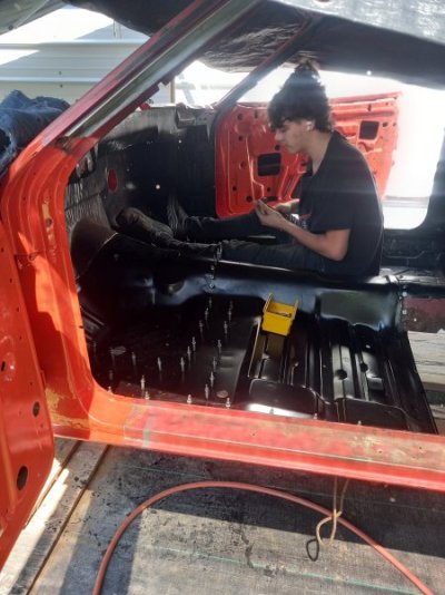

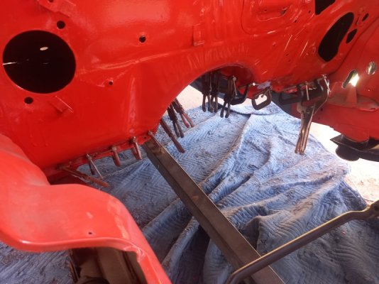

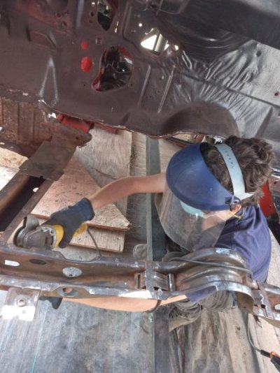

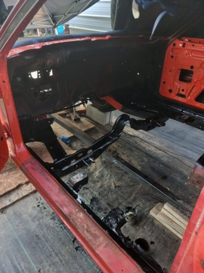

Now to get to the reason for this thread. He, to be referred to as the Kidd has been busy. Please keep in mind his preservation's purpose is to stop deterioration, get him in it, and he says one day he wants to restore in or send it to Kev-Dog at Kindig It. For now, he has been hard at it. Here is his progress. Keep in mind, he is doing all the work, and I only assist for advice and heavy lifting. Cleaning the Rat nest out First Fender Removed
Removing the K-Member

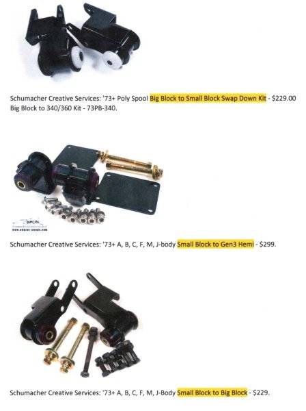

This leads to my question:
Continued from Above: We have both BB and SB k-Members. The Kidd has a later built 318 that froze and cracked the block on both sides, so we picked up for parts. He was also recently given a clean late model 360 roller long block from a car guy friend, and I have a 440 short block he has disassembled and wants to keep for future use.
I have searched and cannot find a conversion kit to put a SB in a BB K-Member, or know of a way to accomplish this so one day in the distance future he can swap the SB out for the BB he would like to have one day. Any known methods?
In addition, has anyone retro-fit a late model 5.7 in one of the 73s or 74s? I am interested in info on this too.
Also, any leads on external body panels? I have bought 3 additional 74 Satellites for parts, and although several parts are okay for this project, the bodies are lacking as well.
Thank you for your help.
As far as I know, nobody makes big to small block conversion motor mounts, however it's really not that hard to make your own. If you don't have a MIG welder, buy one. It will pay for itself many times over.
If I was in your shoes, I would build the big block and install it now.... even if there is a need to save up some dough first. Just build one engine and be done with it.
I would do the 440. Good bolt in project for youngster.
440 source I think has adapter mounts available again. Occasionally shoemaker mounts come up for sale.
Thanks 41 and curiousyellow7, I would do that if it were not my son's first car. For now, just a semi-stock 360. I may mess around with my welder to see if I can come up with something. Maybe someone will see this and post a diagram that they have. I will also look up those venders listed.
Thank you for the help.
The conversion mounts above are for putting a BB in a SB K frame.
Didn't the OP say he had an SB K frame available?
Why not swap that in?
It's not difficult and you can replace the bushings and other front end parts while it's out since that probably needs done any way.
Very cool, I figured I must be the only misfit to swap a BB for a SB, however guess which kits Schumacher are sold out of:wetting:
Thank you all for your time. Sorry for my back and forth. Wish we were sitting in my shop drinking tea and discussing. I have 3 SB Ks and 1 already refinished BB K from the RR and the 3 parts Satellites. If I let him have my BB K he can convert to a BB one day with little effort. I may not be alive when that time comes:praying:,but can always hope.
I never thought it would come to having to buy additional cars to accomplish this goal. However, it seems as if the reproduction parts companies have missed the mark with this one.
73 and 74 are really just now starting to get respected by the general Mopar population, and by extension, the aftermarket industry.
Unfortunately this also comes at a time of off-shoring issues and more recently high inflation rates, and business staffing and financial issues.
Schumacher has recently been sold, and is just now starting to move products again.
Just spoke to someone at Schumacher, and it may be a couple of months before they do a production run on the BB K to a SB conversion kit. However, they do have a SB K to BB conversion I could put on the parts shelf for future use.

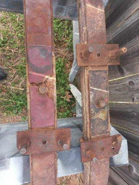

Good evening. A new question has arisen regarding our 1974 Road Runner rear leaf springs.
Can someone please provide me info on the operational difference between the Heavy Duty and Standard Duty rear leaf springs. We found one of the heavy-duty Leafs (Top to bottom number 7 leaf) broken.
Question One: is there any aftermarket replacement individual springs to repair this?
Second: What is the ride height difference between the Standard and Heavy-Duty Leafs?
I have 2 additional sets of standard Leafs, so I could use one of these, but I am wanting to assure of the ride height and performance difference, if any.

Hey Bluesky10,
I have used the rebuilt kit and had a couple issues. I think it is for the standard springs, the u shape straps were too small to wrap the spring pack so had to source larger ones. I was also short on the thin metal squeak suppression separators because again I think the kit is for 1 less spring. Luckily a have a California car so most of mine were good it was just a preventative measure.

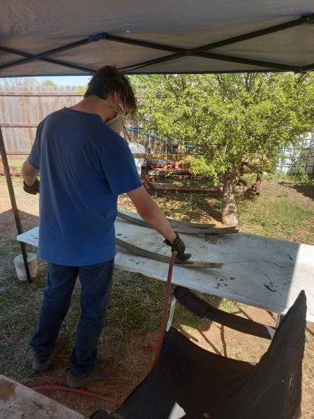

MoparJimT, Thank you for the feedback. Good info to have, so with that we have disassembled a couple of sets we have and have reconditioned a set. The kidd has sanded, primed, and painted one set of 5 leaf springs, selected all the remaining serviceable parts, and all the bushings and additional parts are on the way from Rock Auto.
