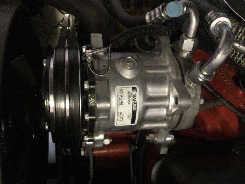

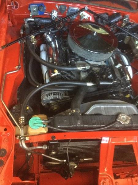

Hi, everything I say here is just my spin on ac and my projects I build. If you are trying to hold you car to the original manufacture look, you will always be chasing the coolant escaping from the system. If you are wanting cool air from your system and perform more adequately I would suggest an aftermarket compressor to be adapted to your car. It will perform more adequately than the old style RV2 compressor.
The old rv2 compressor can be overhauled, mainly just putting in new seal kits. I chased down parts from eBay. Sometimes they become available there. The old rv2 has very few moving parts are simple to take apart and re-assemable. I’ve gone both directions with the old and got it to work ok. But the new style compressor to me will out perform the old style compressor. What ever you decide, you will have to make a plan and then work into that. Just my 2 cents worth on ac.

Because of volume and pressure differences between the two refrigerants, the RV2 may not have sufficient displacement or volume capacity to maintain the R134A pressures and likely that the condenser will not have enough SURFACE AREA to dissipate the collected heat, and the EVAPORATOR will not have enough SURFACE AREA to absorb the heat. Likewise, the refrigerant metering device, thd thermoststic expansion valve or TXV, will not be compatible with R134A refrigerant. The new style AXIAL FLOW COMPRESSOR, such as the Sandun unit, is an excellent unit and can be adapted to suit the application. To achieve a coordinated system and maximum performance, the major components must be sized correctly.

Hi, I have successfully rebuilt the old compressor for my 73 charger. Just by luck someone on eBay was selling pistons rods crank, oil pump, seal kit at the time that I was needing them. I rebuilt my old compressor and installed Esther oil in it. Esther oil is compatible with both 134A and R12. My system has real R12 in it. My system has been holding the R12 now for about two years now. Had the Charger out just last weekend and the wife asked me to turn the air down because she was cool enough. Autozone has the front crank seal if you need that seal ar $31.
