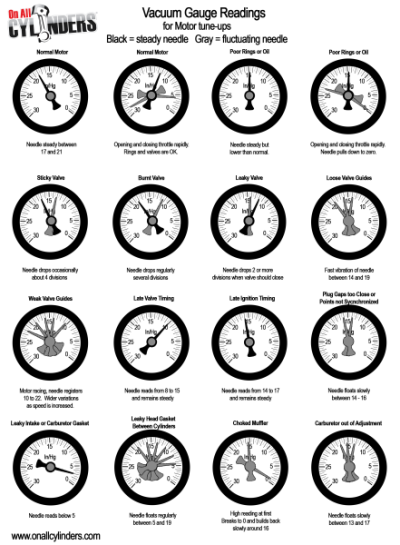

Did you set your distributor off #1 TDC compression ? What does your vacuum gauge read ?
Maybe this will help. Still sounds like
you've got a vacuum leak.
