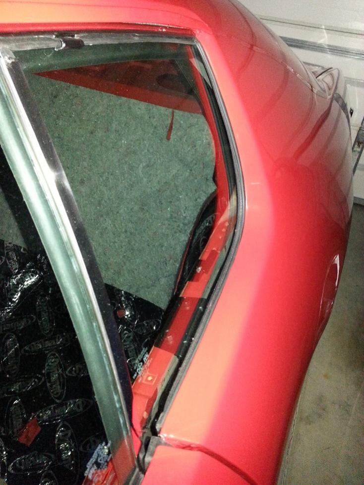

Here is a picture of the ones I got from Restoration Specialties, http://www.restorationspecialties.com ask for Todd, he can set you up with a set. The only thing you will need to do is take the little plastic button off your originals that is riveted on to the front section nearest the door jamb and attach it to the new ones.
One thing I noticed is that there are gaps between the quarter glass seals and the door jamb caps, even with the originals near the door jamb that allow water in, so I am looking at a solution for this problem.
