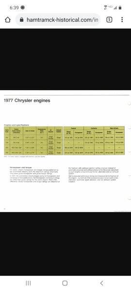

. The 75 was 260, 76 was 240,and the 77 was 195 HP. The 400 was only down to 190.

https://www.hamtramck-historical.co...ataBook/1977/77-Chrysler-engineering_0004.jpgNot sure if this is a hp...but in 77 a 440 had whopping lean burning 195 hp. Go to 1970hamtramck historical and look the library.
True, there are two 440 HP in 1977. one is lean burn, one is high altitude. one is 195, the other is 190.
