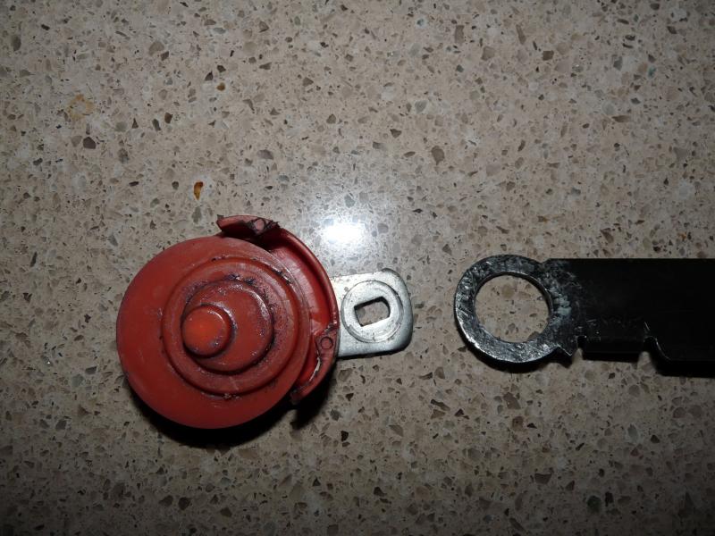

I have replaced all of the items in my Monaco. Wipers will not come out of park function. Only go part way. Motor appears to be functioning properly. Wonder if I put cam assembly or link in wrong. And you should pull the motor to work on this. Good would be good too
Wiper Linkage
Here is how I installed the wiper cam. At this time the wipers will only go from the park position to the half way mark on the windshield. The motor appears to be operating correctly in regards to speed and the park function. Can somebody tell me if I have this in wrong please.

And the best way to install the new bushings is to remove both pivots and arms. You loose less skin that way.
