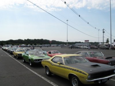

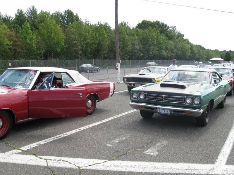

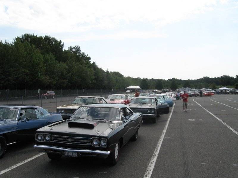

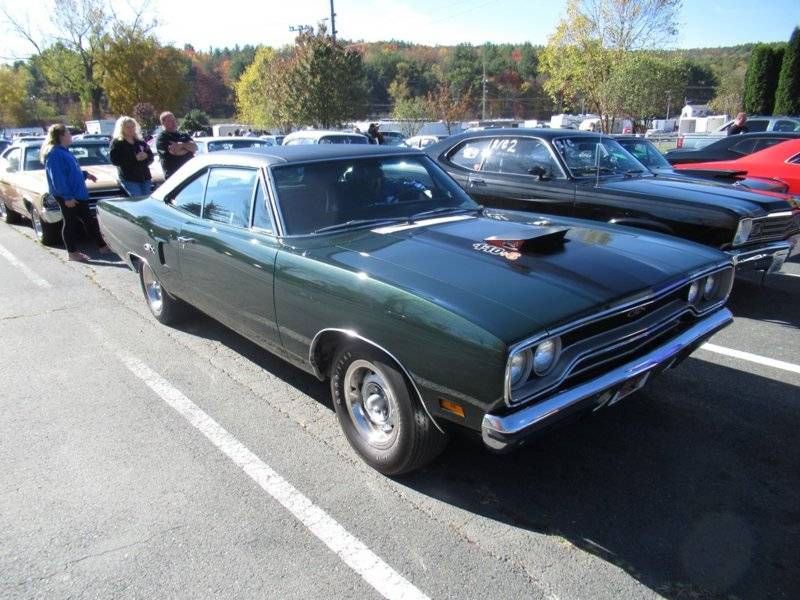

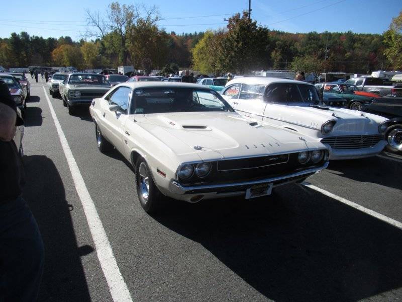

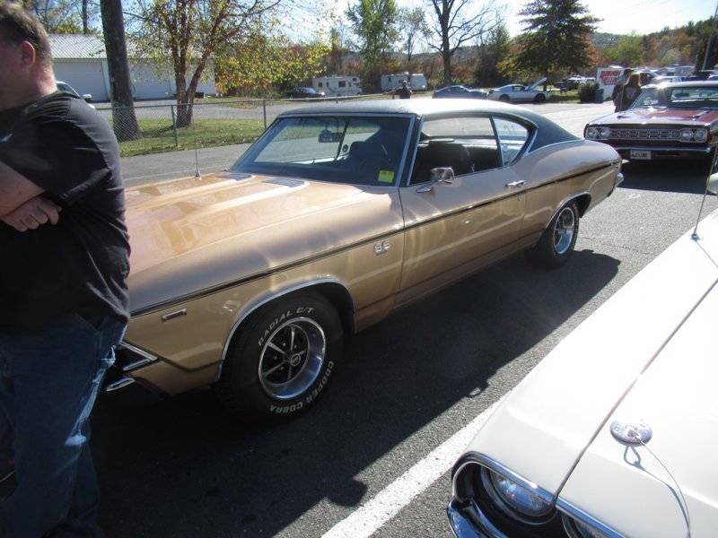

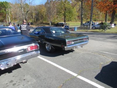

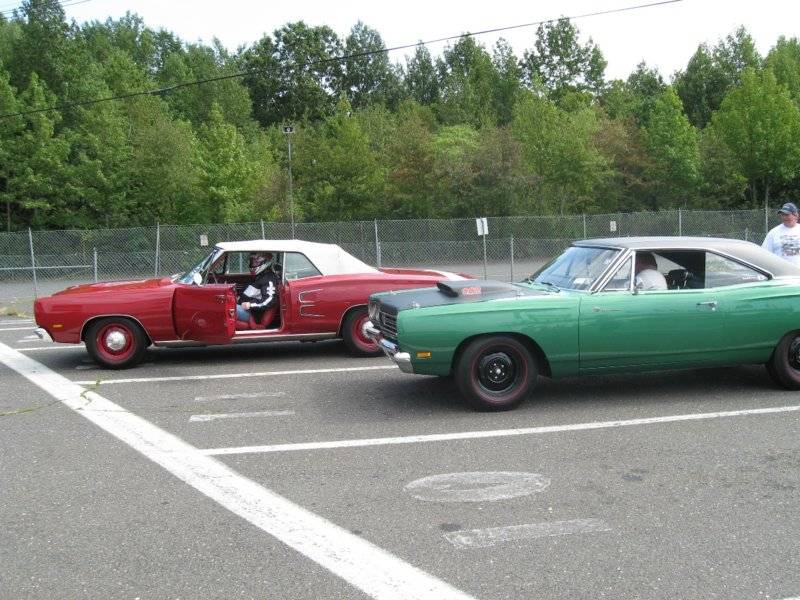

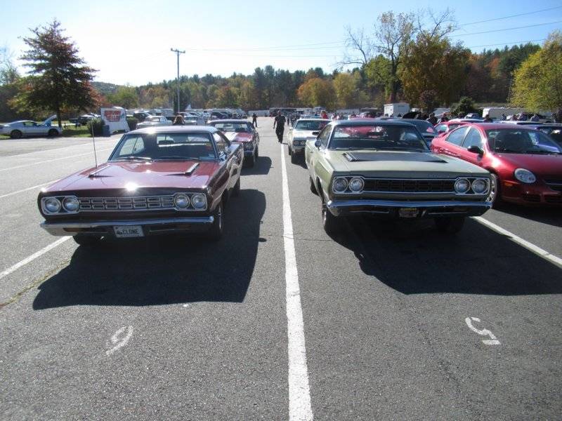

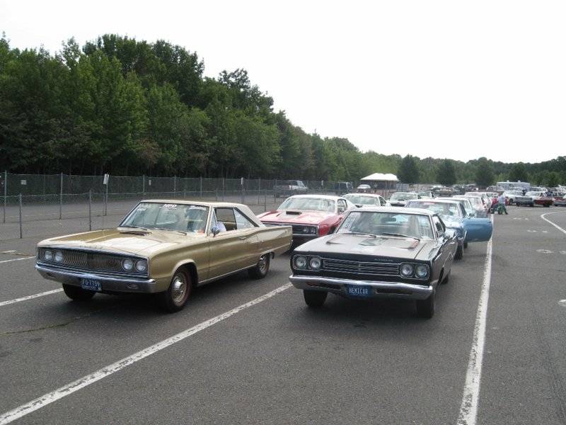

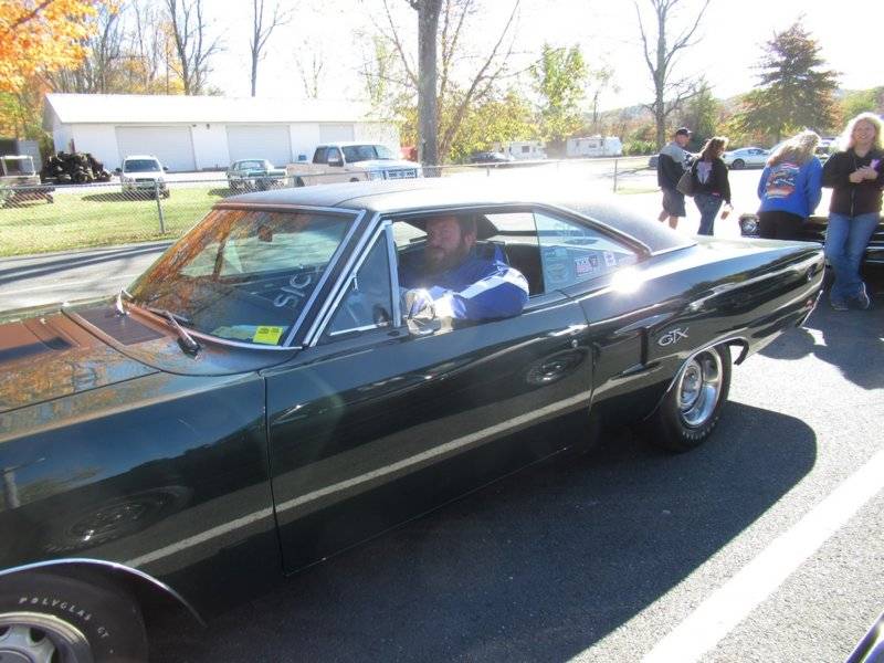

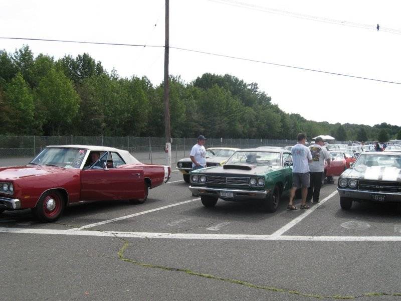

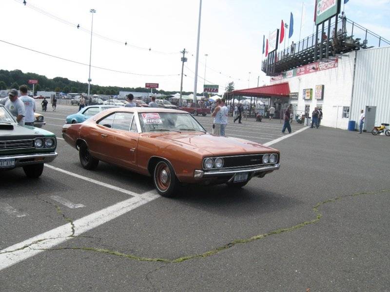

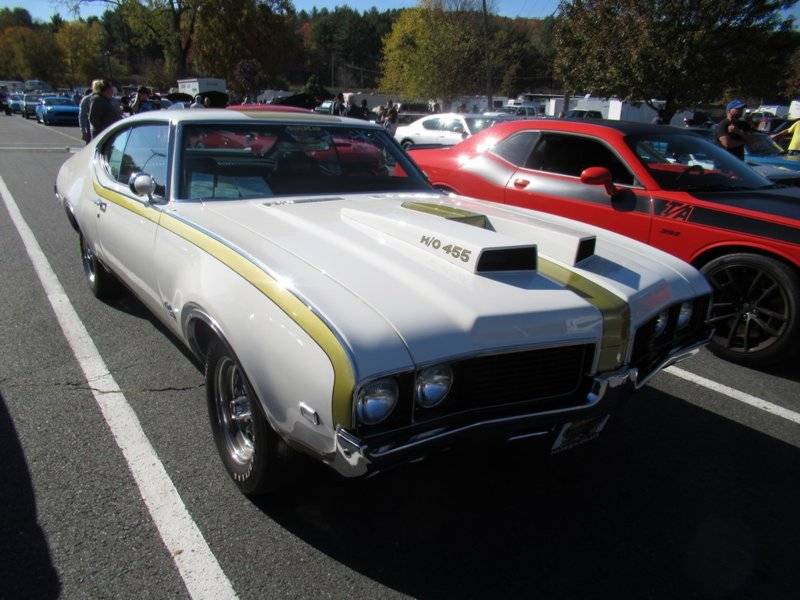

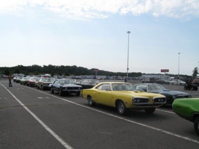

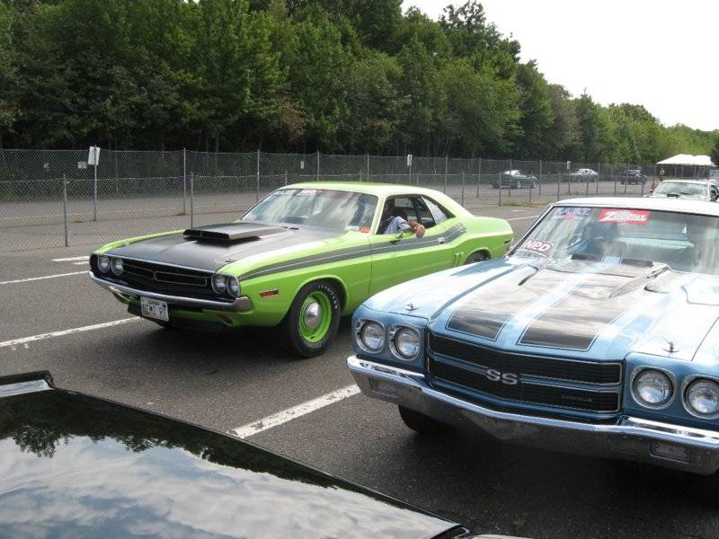

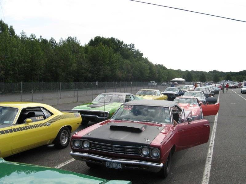

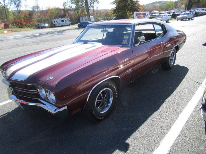

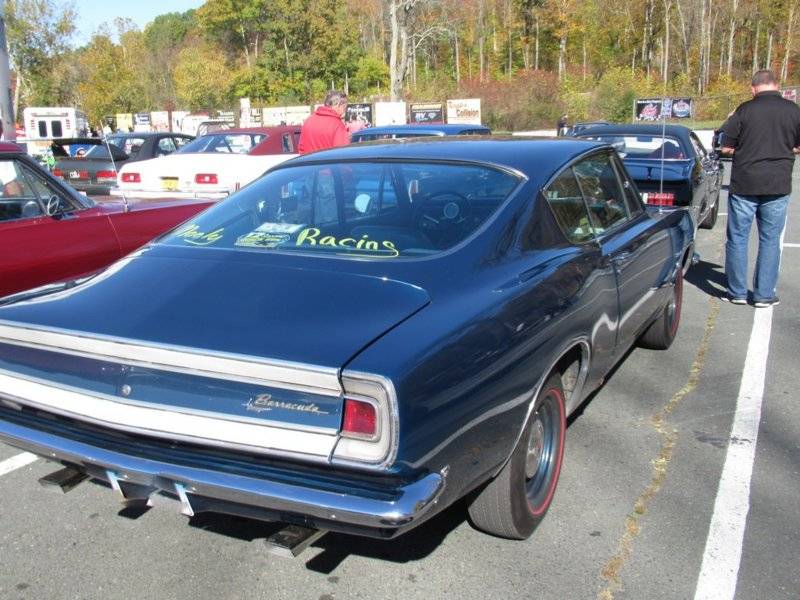

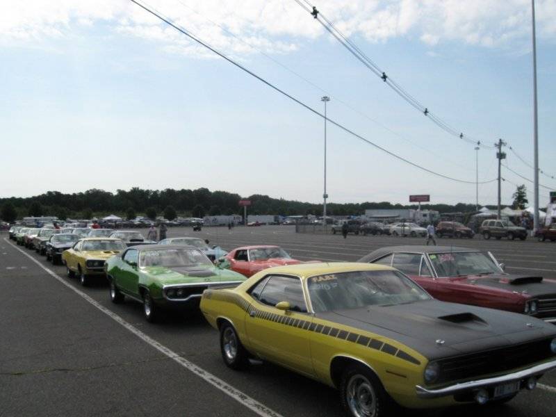

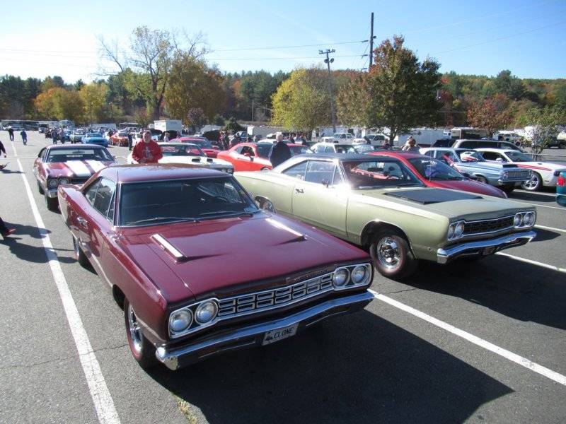

As you get into it,the little things are the 1st to get attention.Ignition timing is normally 1st before tweeking the carbs.Making sure all the clutch linkage is well lubed with no flex is another thing to start with.I get to race with a stock appearing group as an exhibition car.Watching and seeing what they have done to get a car like yours into the 11's is amazing!
10.22.17 026.jpg 10.22.17 027.jpg 10.22.17 028.jpg 10.22.17 029.jpg 10.22.17 030.jpg 10.22.17 031.jpg 10.22.17 032.jpg 10.22.17 033.jpg 10.22.17 039.jpg 10.22.17 040.jpg
