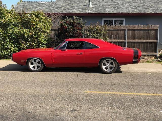

You want to be lower than this ?
I don't have dropped spindles, just 1.15 torsion bars and trimmed lower bumpstops. The car rides firm but not harsh.
View attachment 910976 View attachment 910977
I know you've done a fair amount of steering & suspension upgrades on your car and it looks good. I never though about trimming the bump stops but I guess that would work...

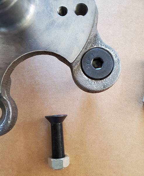

Those funnel shaped mounting bosses look unusual. It makes me curious if you'd need a Bugle shaped screw/bolt for the lower ball joint so the head has adequate contact.
Supplied hardware fits and I was told there should be no issue by both PST (out of stock, no e.t.a. and possibly N/A) initially and also Performance Online when asked about what can be used on the swap.

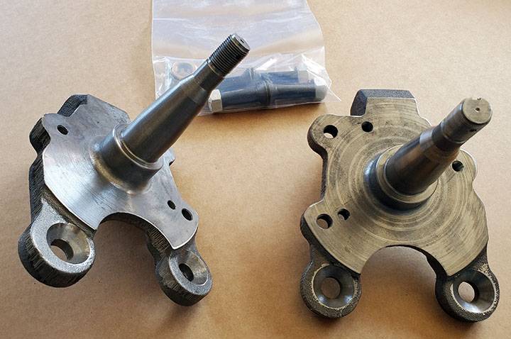

I did the drop spindles from PST, stock steering linkage. No issues.
one thing I did have an issue with was where the caliper bracket mounts to the spindle. The spindles required some “finesseing” with a die grinder in order to make the caliper bracket fit correctly.

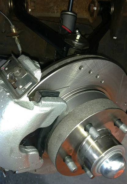

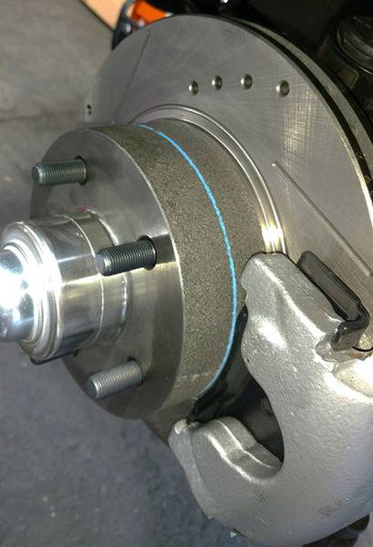

Had to grind the new rotors out some to fit with the brake kit currently on the car, caliper bracket as well but managed to get it all in there.
2" drop spindles with Hotchkis leaf springs along with a bunch of other stuff.
I like how the stance is now, I could go lower now that there is more space as the T-bars are not right on the bump stops.
Brake pads were hitting the rotor, I got this kit long enough ago I don't remember where (probably e-bay) so there was some "finessing" involved.
Sprayed some silver paint on the calipers now that you can see them as well.
