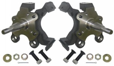

Magnum Force and Performance Online both have 2 inch drop spindles, they look about the same, similar price, has anyone successfully installed them on a 62-65 B body? I have the 15x7 cop wheels on the car, and would like to install the drop spindles instead of torquing the torsion bars so far to get the drop.
Oh, even though their pic shows the caliper brackets, they're not included.

thanks. wondering if anyone has had any issues with tie rod end clearance issues, I guess they move the ball joint mount up a little? I called, they're not exactly sure.

the relationship of the joints are unchanged..axle stub is mounted higher up on the spindle thus the dropping effect of the suspension...if you were to compare to stock you will see the stub closer to the lower joint....
Yeah, I tried comparing pictures of a stock (disc) spindle and the dropped spindle, and the differences are more than just the raised axle stub. It appears the caliper is clocked a little for clearance. Currently, my outer tie rod end is pretty close to the rim/tire, so I'm not sure there will be clearance with a 2 inch drop. I'm going to check it a little closer this weekend to see.
