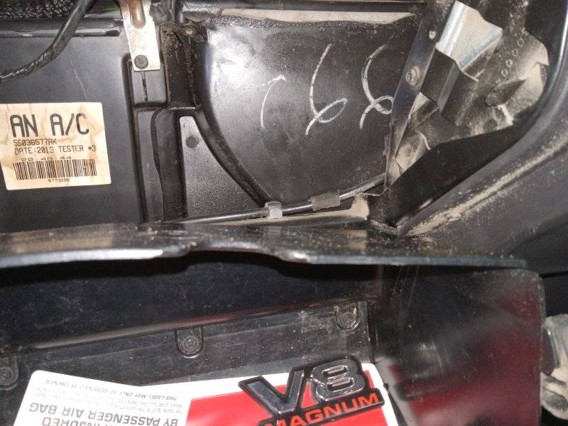

A few months ago something crawled into my ac box and the squirrel cage blower killed it. It got very stinky in two days. Used several cans of febreze and over time, the stink subsided. But recently the dead critter dislodged and is now residing in the squirrel cage of the blower throwing it so out of balance that I can only run it one the first two lower speeds. Any higher of a speed the shaking sounds like it will self destruct. So does anyone have a hack or trick to fish this thing out of the blower? I was thinking, removing the glove box and using a hole saw to access the a/c box and use compressed air or a grabber tool to remove the offending stinker.
I'm thinking it's either a small lizard, mouse or snake. Any suggestions will be appreciated. As I don't want to remove the whole dash to get to it.

Thanks, but I have already done this before when I had to replace the blower. Not fun at all. I'll most likely hole saw it. And fish the dead thing out. And cap plug it shut. It's right behind the glove box, so it's easy to get to.

I replaced my heater core when I had to replace the evaporator. Hindsight is 2020 I should have also replaced the blower at the same time. Because the blower crapped out afterwards . So this a/c box design sucks. I really don't feel like doing this again . So first chance I get ill be hole sawing a access port. I'll use a caplug or some aluminum foil duct tape to re-seal it.
Just be really careful not to hit the evaporator core with the drill bit on the hole saw.
I would suggest making a patch panel out of thin sheet metal or even flashing and seal it with silicone or weatherstrip adhesive or it will leak when you use the AC.
