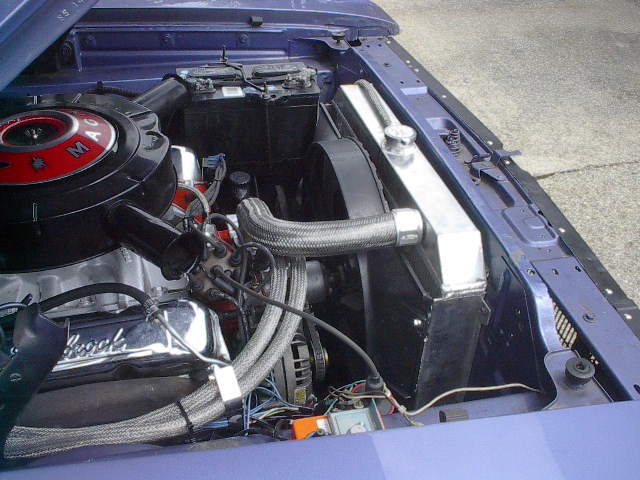

I bought and installed the 22" Wizard in my 440 powered Belvedere. Very very nice peice with quality tig welds. Everyone thats seen it has asked about it and commented on the build quality. First aftermarket peice I've bought that dropped right onto the factory bolt holes and rad hoses lined up.
Cruising along the car runs at 180* or a touch less, unfortunatly I went the mechanical fan route and the replacement heavy duty Hayden fan clutch will not clear with the bigger core tubes in my 67' and the car will climb in temp after heat soak and idleing for 15mins. This is not the rad's fault but an airflow issue.

I can also say that the new wizard with bigger tubes took about 1liter of water more roughly then the stock style 26" rad did that was half hidden behind the rad support.

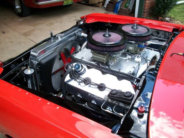

no...actually a 70 RR shroud . Rad had the fittings and it worked perfect..actually the fan is too far in the shroud but my 440 stays cool anywhere/any temp of the day so I don't bother with it
