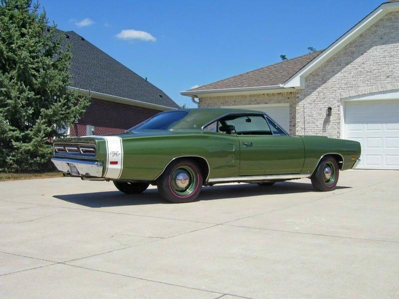

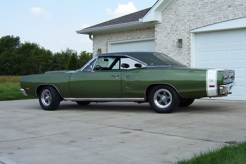

225-70's. perfect fit.

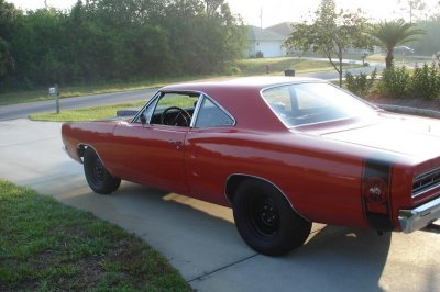

I had 245 by 70's on my 69 bee....29 inches tall but not wide enough for me
I have put 225/70/15 on my 69 Bee 's stock rims, And is what I run up front. I didn't like them on the rear.They're not big enough IMO. I"m running MT sportsman S/T they are 28"on 8"x15" steel rim with 4.5" backspacing (If I remember right). Was as wide(10")as I could go. Once I shred them , I was looking replace them with 255/70 or larger. You can seach bf goodrich/ cooper tire they have a calulator/table. Will give you tire heights and rim specs.
