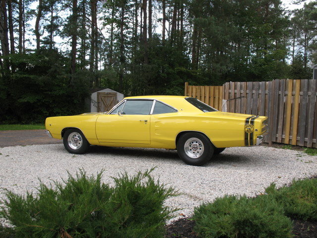

295/65/15 BFG Drag TA on a weld 8" rim

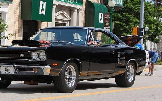

That tire seems like a better fit for 8" wheels? I run 325/50s on my 10" TorqueThrusts.

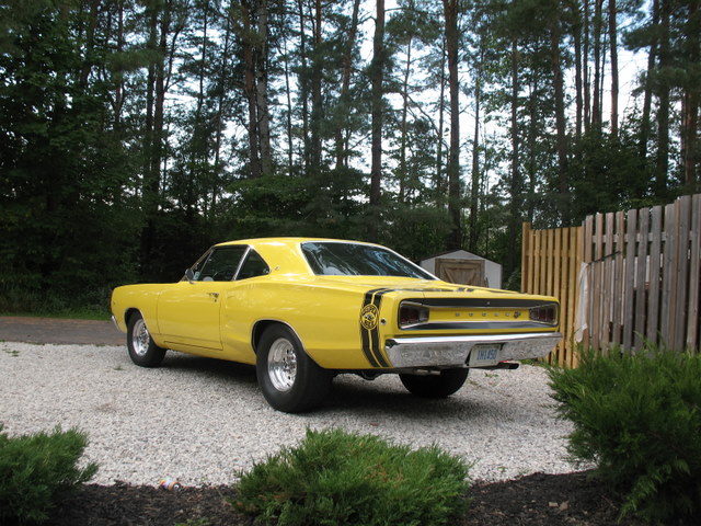

On my 69 Bee, I'm running MT ET radial 295/55/15 on a 10" Billet Specialties wheel with 5.5" back spacing. Tire has about a 1/4" clearance from the leaf spring and inside of fender. The 295 tire looks nice on the 10" wheel, tread is nice and flat, not ballooned up. The below pic is about two years old; since then, new leaf springs have been installed so the Bee is bit more raked now
