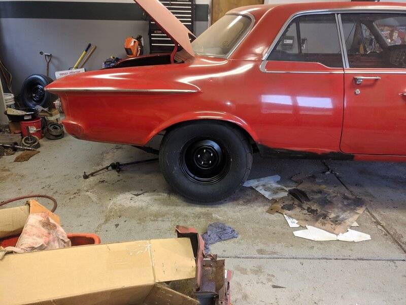

Rear rims/tires ordered... hope they fit :) Haven't figured out the front yet..
Rims showed.. on my 62 (stock housing and location) i have 1.5" at the front of the rim which because of how the springs angle will be bout 1" at tire bulge which i'm sure won't be enough.. i'm figuring 1.5" bulge.. So i will prolly move the front of the spring into the frame like DVW does them and offset shackles, don't need to move the rear as much. Thinking of moving the front hangers into the frame maybe 1" though and boxing it nicely. I don't wanna go full in like mini tubing. Wheel lip area looks like it will be plenty of room..
Will need to get new perches and shackles.. wanna try to do it in the car so i can make sure it all fits perfect.. only thing i hate is cutting off the old perches while in the car..

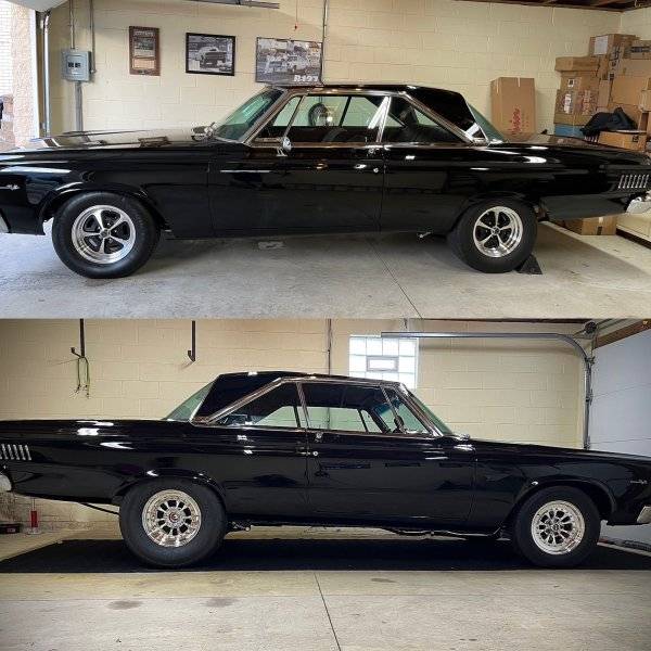

I have been wondering about tire size and what is the biggest that will fit on a 65 Belvedere. After reading so many comments about 255's being the biggest, with an occassional 275 being the biggest, I decided to find out for myself. I did find 2 posts of people that fit a 295x65x15, so that was my goal.
Here are my photos of that tire (Mickey Thompson 255508 - Mickey Thompson ET Street S/S Tires) mounted on 15x8 with 4.5 inch backspace rims (Wheel Vintiques 63-5812042 - Wheel Vintiques 63 Series). The previous owner of my car rolled the fender lip, but I am sure they would fit even it the lip was not rolled.
Now I need to finalize the fronts....
Hopefully this will help someone who is wondering if these tires would fit.
