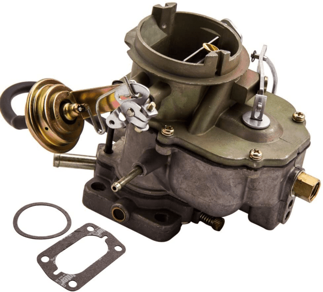

Woodruff Carbs is an excellent choice.....but, condider looking on eBay for a Carter or Amazon Prime.... they were asking $75.00 plus free shipping. Some 1967 LA 318 engines used a Stromberg WWC3 carb. The pix below is a Carter BBD 2 barrel.......just a thought....

AnyBody have Long term results on those Cheap New 2 BBL. Carbs.on E-bay ?
If your carb is original for the car, it is best to have it rebuilt. The jets, air bleeds, float level etc will be correct for THAT engine. Who knows what an ebay carb will have in it?
Rebuilding is a snap. The biggest wear area is on the throttle shaft but they make bushings to fix it. Pull it apart, clean everything, make sure mating surfaces are flat, replace accelerator pump seal, set float height.
