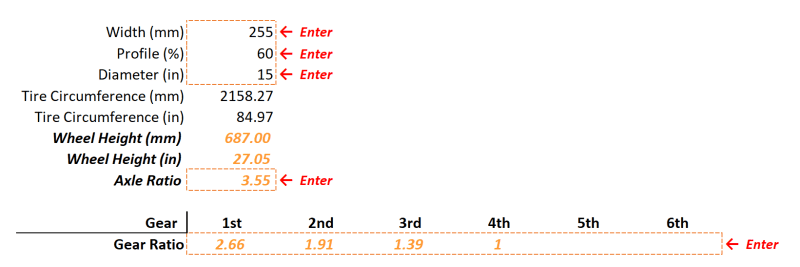

I struggled with gear set choices/transmission ratios/tire sizes for a while when trying to decide on what RPM I was comfortable cruising at. To help, I made an excel spreadsheet that auto-calculates RPM vs speed for a given car (after inputting some known or hypothetical values). Was very helpful to visualize RPM drop after gear changes, as well as highway cruising RPM. Happy to share the doc with anyone who wants it. Screenshot examples below:
