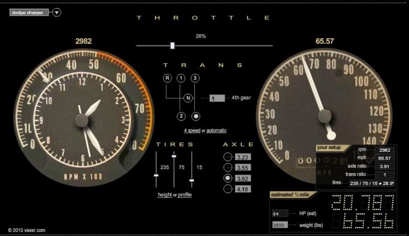

  • B-Body Rallye guage gear tire etc calculator for  checking all sorts of cool stuff.jpg
