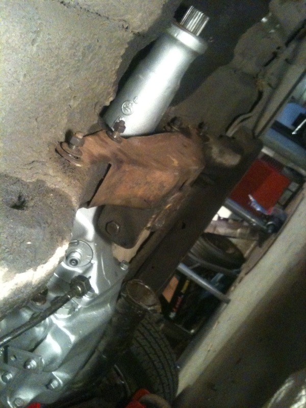

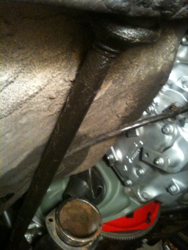

well she's comeing along slow but sure.... SHE IS ALL FITTING TOGETHER..MY CAR IS A 1971 AND AS YOU CAN SEE I HAVE 1969 RR TRANY IN THERE WITH NO REAR SHIFTER LOCATION.. I PICKED A THING UP CALLED A BOW TIE.. SETS THE FRONT LOCATION BACK SIX INCHES SO MY SHIFTER WILL BE IN THE BENCH SEAT POSITIONAND NOT UNDER MY DASH...
ALSO USED A 69 BB 383 RR CAST 11" BELLHOUSEING , BOUGHT A NEW Z BAR AND KIT FOR THE CONVERSION AND IT ALL FITS NICE LIKE IT SHOULD... USED THE 11" 143 TOOTH FLYWHEEL ..HAD IT BALANCED (MY 440 IS A 1973) AND RESURFACED .. PUT IN A MC1123 McLEOD 11.95" CLUTHCH... MY PILOT WASNT DRILLED IN MY CRANK SO I USED THE PRB5300 BEARING TRICK
I MUST GIVE YOU ALL ON THIS SITE A SPECIAL THANKS FOR HELPING MAKE THIS SWAP HAPPEN WITH HARDLY ANY SCREW UPS
OH YA !!! THE 69 AND 71 4-SPEEDS ALSO HAVE DIFRENT TRANNY MOUNT LOCATIONS ..WE THOUGHT WE WERE GOING TO HAVE TO FAB SOMETHING BUT WHEN WE TURNED THE SPOOL MOUNT BACKWARDS IT BOLTED RIGHT UP

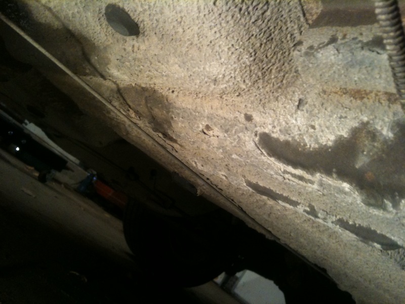

check this out ..this is a cali car ,my fender tag said factory undercoated.... unreal !! check out how thick it is under here..inside the wheel wells and quarters are the same way.... no rust anywhere ever....

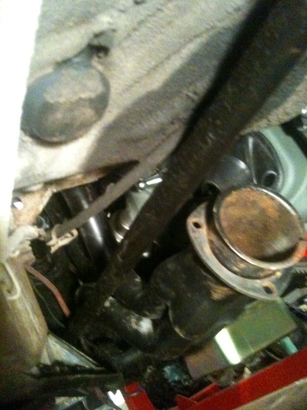

)))) UPDATE (((( BOLT ON HORNIES WONT BOLT UP PASS SIDE THE CROSSMEMBER IS IN THE WAY

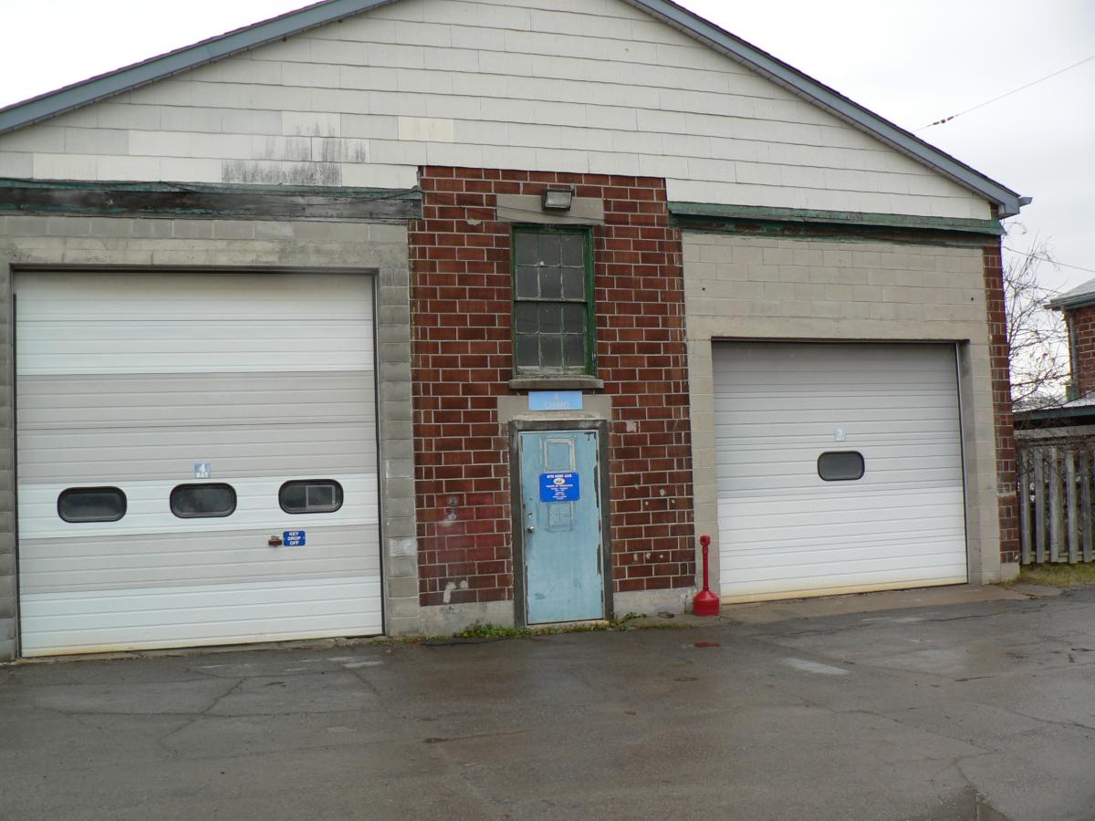

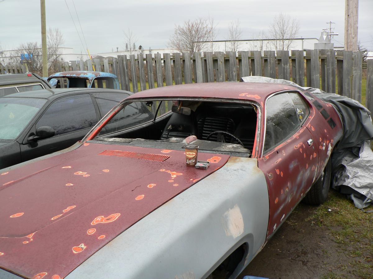

Just removed the windsheild from my satty and cleaned up the groove all the way around. Really nice that the Royal Canadian Air Force has a Auto hobby shop. 2 mechanical bays and a body bay. Great bunch of guys that assist me in doing it all myself minus painting.
The chevy thats in the body bay should be out nxt week and then mine goes in.
Heres a shot of 1 of the 2 buildings and my car minus winsheild.
Met with a glass guy to chit chat about what the processes were this morning and hes willing to give me a hand putting it in.
He suggested a epoxy primer and says I cleaned it up perfect (little relief)
more to come; sry i diont want to take over your thread-

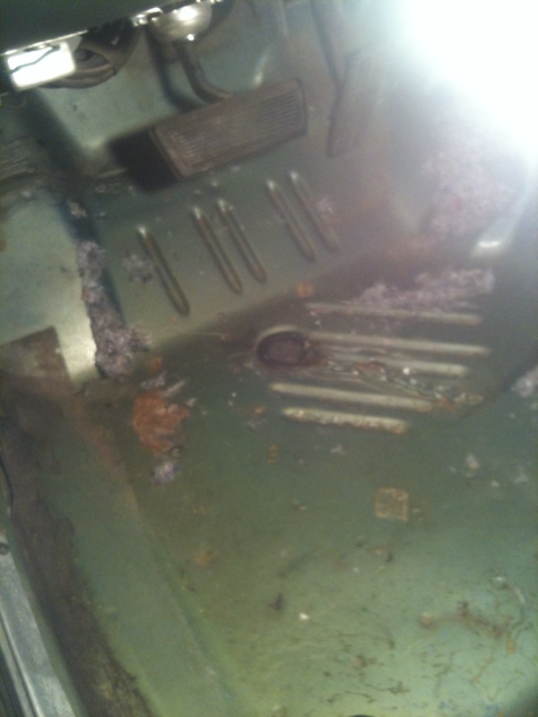

Yanked the carpet so we can put in the 4 speed hump...and check out them floor boards...sure can tell its not a minnesota car

Great looking floors!woo!! Your a lucky guy-
had a peice mine in- didnt bother replacing the whole side-
