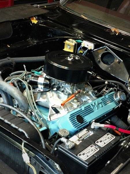

Stock 2 barrel, so I can't speak to performance, but it sounds great and I didn't need a 90 filter.
When I got mine they didn't offer their top of the line coating on their website, not sure about now, but call and request it.

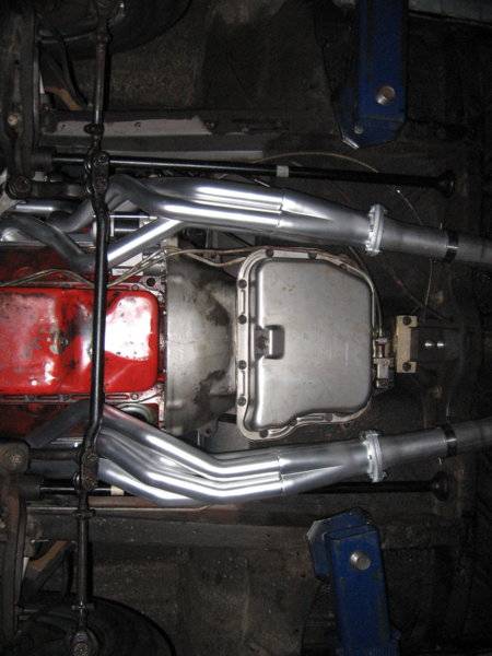

No need for a 90* oil filter adapter unless you want one. Yes the TTI's are worth the money. I went with the complete exhaust on a stock internal poly with a 600 Edelbrock and a Weiand intake. Just those few items really woke the poly up.We also built a 390 stroker poly and it will run with any big block.
TTI makes good stuff.

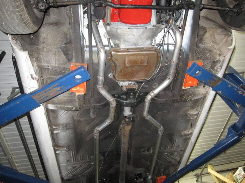

You could also try an H-pipe.

I've got a h-pipe fitted and the mufflers are straight through, no brand from the local muffler shop.

I went with the mirror image right side manifold and scratch built system on my 65 2Bbl poly.

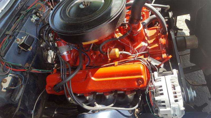

should of told you the motor i'm running a 318 this is what i'm wanting headers for in the 65 sat thanks
