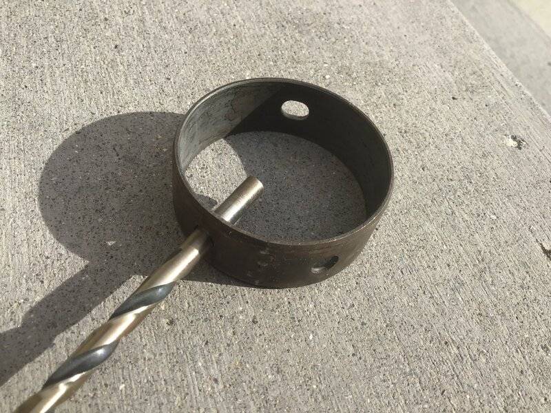

The 1/4 turn at a time is a failure. It doesn’t work. I’m not surprised to hear you don’t have oil at rockers doing it this way. There is a small window of rotation that the oil holes are lined up to feed the rockers. And what diameter are the oil holes in the cam bearing and the cam itself? They are 7/32”. If you run the drill with out the crank moving then turn 1/4 and run drill again you will never see any oil at rockers.
So get a helper, one person on the drill constantly running clockwise, and one person turning the crankshaft slowly. Take out all plugs so it turns easier. You need to go two revolutions of the crank to make sure you have gotten both oil holes lined up to oil.
