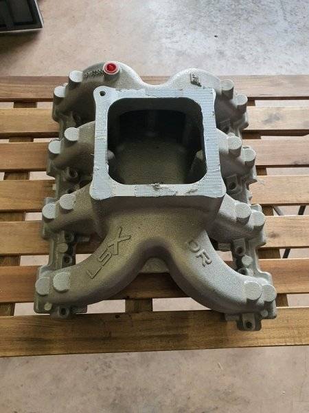

Haven't got a decent intake as yet but have plans to modify a LSX one.

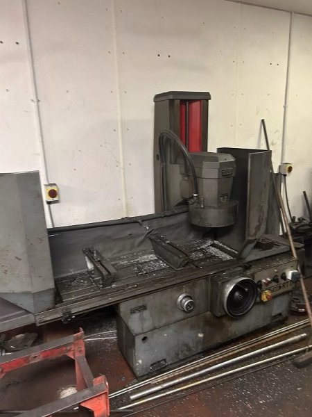

This was our best piece of machinery, you can do heads and block decks as well.
Also can be used like a milling machine to doe intake flanges as well.

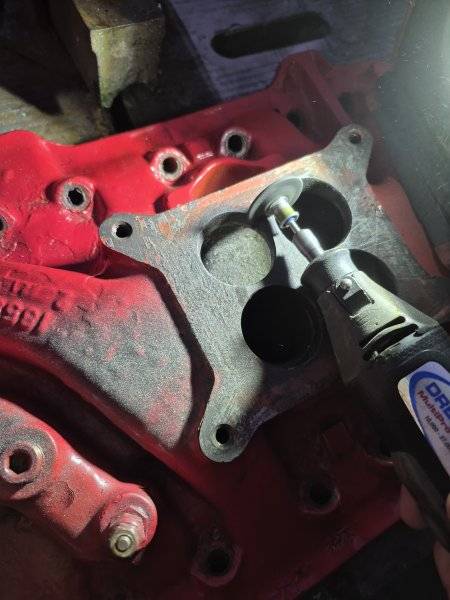

I'm in the process of porting my 4 barrel factory intake right now.
I've been meaning to do it for about 2 years, since the car went on the chassis dyno and the dyno operator reckoned the intake was a big restriction.
Gary Pavlovich sent me the following pictures so I'm having a crack. I'm very excited...
I pulled the manifold off last night and spent this evening cleaning up the old gaskets but before I stopped for the night I had to make an initial cut to see if my dremel would work. I probably need a die grinder but the dremel performed admirably.
I'm going to clean up the ports too but I think opening up the plenum will provide the biggest gain.

I think the biggest gain you would get is to use a divided spacer under the carb, 1" [ or thicker if it will fit under the bonnet ].
Already has one. The dyno operator played with spacers too, didn't make any difference, that's why he suggested the intake was the restriction. He races a 600hp Mustang around the different tracks in Australia and knows his stuff. Gary Pavlovich and other people well versed in the poly engine agree, hence the work I'm doing now. Makes a lot of sense to me - 4 small openings versus one large open plenum. The engine already has headers, bigger valves, head porting, but the manifold was stock.
