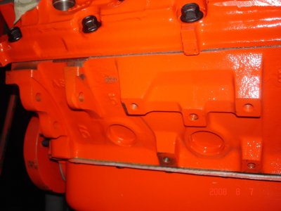

The newer Magnum 360 has both mounts....Here is a pic of a Magnum block. The mount with the ears on the left is old style mount. The flat mounting Pad on the right is the Magnum style truck mount.
