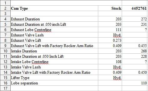

I am attaching a pic the specs I can find comparing the cam that is fitted and the stock 1978 Monaco 360 cam.
I think swapping my cam for a stock one is just about within my abilities but, before I try it, I expect a stock cam would reduce the idle noise and loping but would it also help fuel consumption to any significant degree?
I also wonder if any other type of carburetor (it has a relatively new Summit Racing Carb SUM-M08600VS. 600cfm) would help? Any advice or opinions would be appreciated.

The MP 0.050" cam specs for all of their cams are BS. This cam would probably measure 218/221 @ 0.050" based on other MP cams that I have mesured. It only has 50 degrees overlap. I would characterize this as a nice upgrade from the factory cam but still relatively mild.
This information below is accurate.
You said “Probably”
Below is definitely.
268°/272° Hydraulic: P4452761​
Intake Duration, Nominal​
268°​
Exhaust Duration, Nominal​
272°​
Intake Duration @ .050”​
228°​
Exhaust Duration @ .050”​
231°​
Intake Lobe Centerline​
108° ATDC​
Exhaust Lobe Centerline​
112° BTDC​
Lobe Separation Angle​
110°​
Overlap​
50°​
Intake Opens​
26° BTDC​
Exhaust Opens​
68° BBDC​
Intake Closes​
62° ABDC​
Exhaust Closes​
24° ATDC​
Intake Lift​
.450”​
Exhaust Lift​
.455"​
