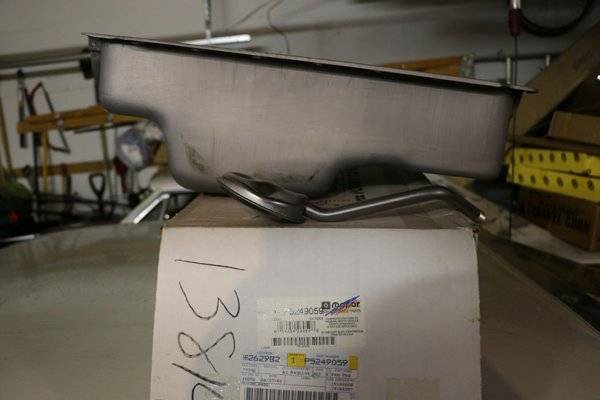

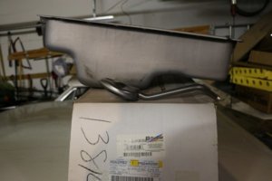

Have you installed the engine. I just noticed it was from a truck. Your going to have to change out the rear sump oil pan and truck engine mounts.
And oil pan pick up to suite the car oil pans different sump location!
