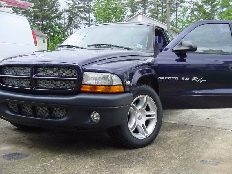

I had a Dakota R/T 360 Magnum. Did Harland Sharp 1.7 Rollers, M1 intake, Mopar Performance ECM, 52mm billet throttle body and all the little bolt on parts. Thought about doing a 408 but was too poor at the time like now.... But just those modifications made a great seat of the pants difference. I think a stock Dakota R/T was 245 horse power. Which is not that great for a performance packaged truck.
