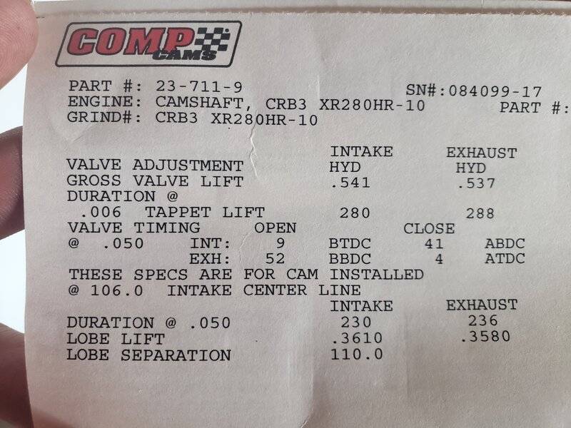

I did mine 383/496, .030 over. I used 440 Source heads, roller rockers, stroker kit. Used RPM Performer intake. I "Know" for sure I'm never going to be chasing hp or racing it. So the CNC ported 440 Source heads are more than enough. I used a Comp hydraulic roller cam for longevity w today's oils. I based my build around this build but 496 and hydraulic roller. At the crank I got 610/670 hp/tq. I used the below cam. Idles at 850 in drive w 13" vacuum.

Appreciate the details on the cam- I’ll compare to the recommended TF cam and see where power is. Finding something that starts low to 5k would be ideal. Appreciate the article- very good read.
I’m guessing with the TF 240 I might be somewhere between the articles power rating and what your actual dyno rates? Upper 500 range? That would be plenty for this sled- although some weight savings planned for front end as well.
