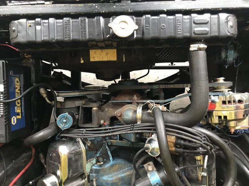

I acquired my 66 Coronet station wagon last fall and am still getting a feel for it. It is running hot and my local radiator shop and I am working on troubleshooting it. The guy at the radiator shop says for an engine like this running at 220 is not a big deal but from everything I have read that seems pretty hot. Seems like closer to 190 is ideal. The car has an electric fan (installed by the previous owner) and we realized it wasn't working so we fixed that but that didn't seem to be help much. We have also changed the thermostat (the previous one was in upside down) and flushed the radiator. I have yet to take it on a long drive but in the short trips I have taken, even on the open road, it seems to be running way warmer than it should. Has headers now but I have exhaust manifolds that I am looking to put back on once I get the chance. Thanks in advance for your suggestions.

The electric fan on there now is only covering about 1/3 of the radiator surface.
The factory shroud covers the whole core sort of like a funnel. The factory belt driven fan ends up pulling air though the entire core as opposed to the tiny surface area that your electric fan is doing.

Note : from that pic that electric fan is not installed correctly. It needs a sealed shroud to pull air across the whole radiator. Electric fans get a bad reputation but they are almost always badly installed from what I see. Try and find a mechanical fan installed on a modern car.
