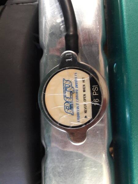

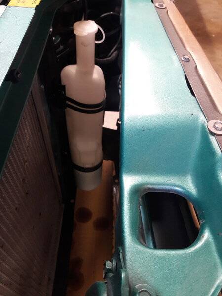

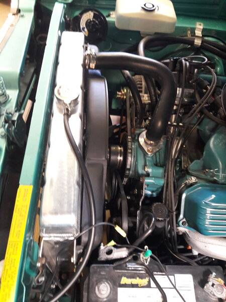

ECP 2 row radiator (which I don't recommend as fitment is poor), stock shroud, stock fan and clutch. Overflow bottle helps by eliminating air and cavitation. Miloden 180 thermostat. Chinesium 16psi cap.
On a 104F day idling at a long painful red light it will see 200F. Otherwise 180 to 190 all the time.
