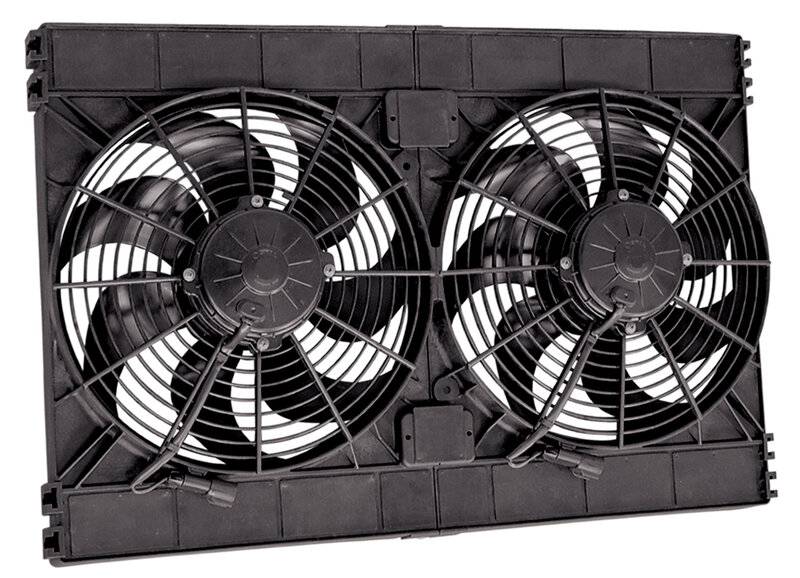

Sorry Nate S your thinking has one big flaw - it is not about the power of the electric motor it is about the CFM of air the fan can move.
If your theory was even close to right every cooling system in every passenger car produced in the last 30 years would be in big trouble.
My theory is close to right, but not close enough. Pretty fair to call me out on it! There are other facets, fan speed at idle being a big one, coupling to radiator (shrouding) being another, fan diameter, blade design etc being a third. It's worthy to note though that the 5/14/28HP IS all from moving air, just how it's moved matters. Engine driven fans do move more air -at speed- . The newer cars that use the electric fans have much more efficient engines and pull through much more efficient radiators. Ever notice how long it takes for the heat to work in a new car vs old? An older design inefficient engine, using an original inefficient radiator, possibly with a bigger, less efficient cam is gonna be hard put to stay cool with an electric fan. Change the radiator and it can help but it looks like the OP has a stock radiator.

I switched to electric a few years ago, I asked the knowledgeable guys here at FBBO how many CFM was needed and sized mine accordingly, no problems at all.
