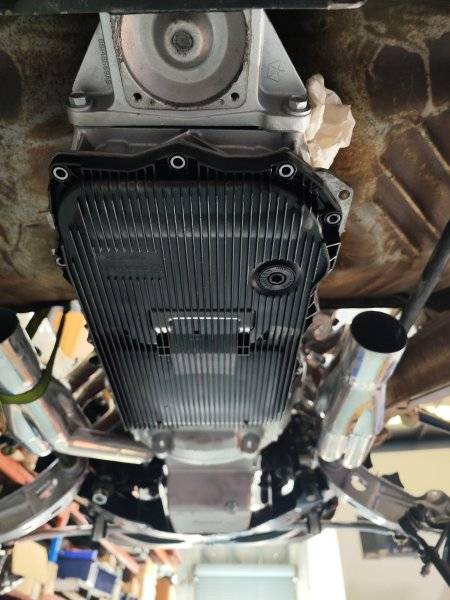

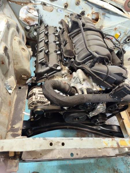

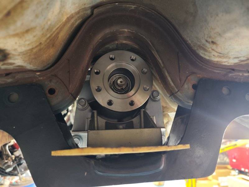

Well did a test fit with the new 392 & 8 speed looks good Gearbox output coupler ends up in the middle of the torsion bar support CNC mate is going to make a longer output coupler rather that cut out the torsion bar also need to dent the Hooker Header slightly as they are a bit close to the torsion bars
