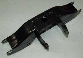

Guys, my 73 was a factory 4 speed car that a PO has installed a 727. I have been acquiring the parts to return it back to 4 speed and THINK I read that manuals and autos require different cross members. Can you send me somewhere to see a picture of the cross member needed so I can figure out what I got or need to acquire.....thanks..

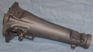

That would all depend on which tail shaft you use on the 4 speed.
There are year specific ones and dual pattern ones.
But for your year car j think they are the same providing you have a trans output housing with the E body mount location or aka dual pattern
I think this is the x member you need, which is the same manual or auto on your year.

I have one of those dual pattern mount tail shafts note the picture posted by:4mulas that is the tail shaft used when using an a833 from 68-70 model year. I don’t need it and would sell it if needed?
Ok, I have the duel pattern tail shaft on my four speed. So, if I understand correctly , if I measure from the front bell housing on the 727 to the center of rear cross member mount , it should be the same as from the bell housing bolted to the four speed to tail shaft rear mount. I am taking it that the duel mount only refers to shifter location and not two different rear mount locations. In other words the original cross member did not need to be changed when the PO stuck in the 727.

Tranny mounts are the same in 73 for auto and manual.
