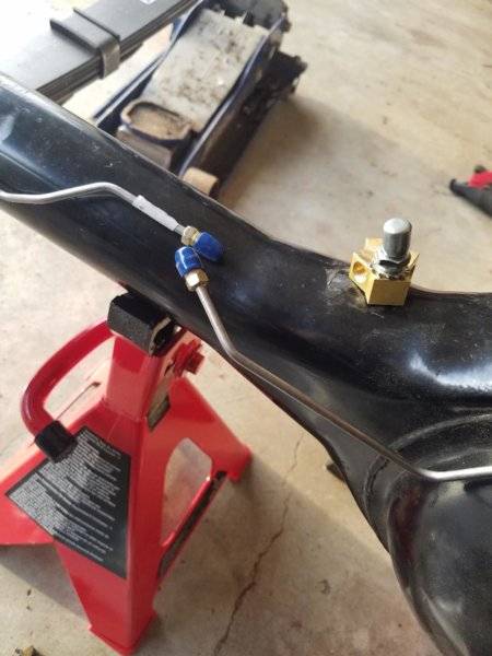

I also bought new brake lines. They don't seem to line up well, but the Right Stuff kit has me cutting them anyway

Chrysler moved the position of the junction block at some point, which is why your brake lines don't line up. Contact Right stuff they may be able to sort it out.

It seems your housing is pre 1970, and the brake lines are 1970 and later. From what I just read, they moved the junction block outward in 1970. My 1967 housing has the block in the same place as yours.

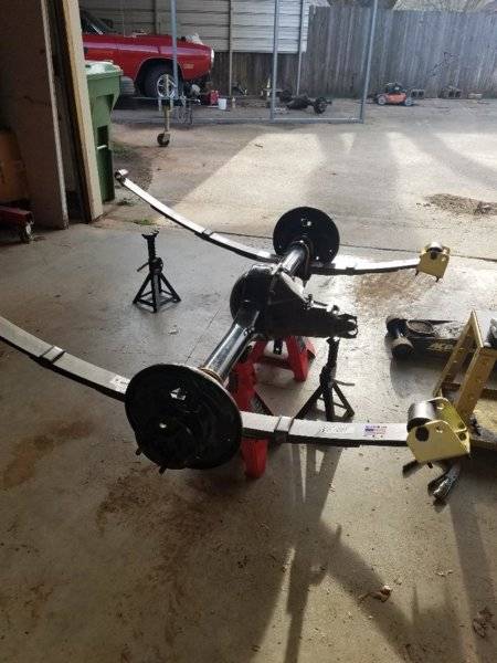

thanks again guys. I am going to attempt the axle removal later today. I will also attempt to have different lines sent. Thanks for the insight

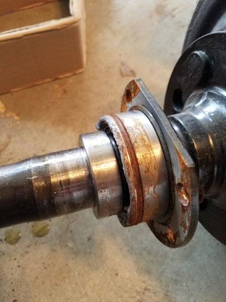

yall are right, it's an easy operation. Here's what passenger side looks like. Would yall replace this?

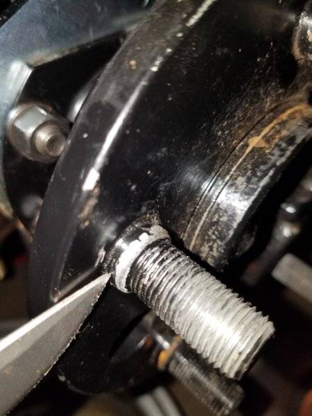

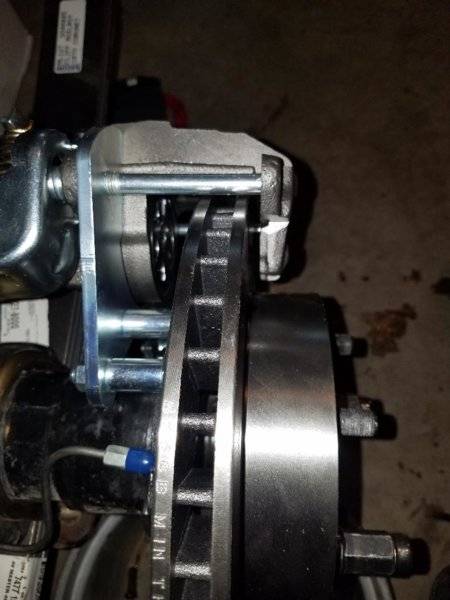

I worked on the one side of the axle today. After mounting the caliper, I seem to have no room for the outer pad. I've determined that the issue is that the rotor doesn't fit past the raised section of the hub bolts.
I'm thinking that I need to drill out the rotor holes a bit, or force it on
