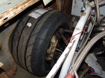

Needed to add 11" to the wheel base to match Superbird.
DSC08976.JPG DSC08977.JPG DSC08978.JPG DSC08983.JPG DSC08984.JPG DSC08987.JPG

When they call them 'stock cars' its makes me laugh...
Diff pumps and trailing arms, very stock indeed...:lol:

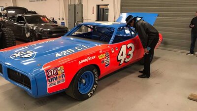

I give you credit for putting seats in the back for the Kids! My '72 Petty Charger is still on the rotisserie as an abolute shell! So you're a lot further along than me.Hopefully I will be retired within the next month and I can relly get moving!
The Kirkeys are nice but I just have a pair of black and blue Craigslist buckets for a $100.
I'm still wondering how the Pettys got
426 CI out of a 440? Did they sleeve the blocks or what? I have a 440 block if its not too costly! Like you said I haven't won the lottery yet! My other option is I have a 383 with a ton of spare performance parts. Maybe get a RB crank and stroke it into a 426!?!????? Any/all feedback greatly appreciated. Thanks, Rick

Several ways to go with the 426 thing for the later wedge engine.
Just get a 413 block, 'cheap as chips' and bore it plus 60.
Sleeve down a 440 block probably around $600/$700.
Or de-stroke a 440 crank with 2.200 Chevy rod...
4.320 bore x 3.640 throw is 426ci
4.350 bore x 3.585 throw is 426ci also
Whatever way you go, no one is gonna know lol...
Even Tricky Dicky likes it too lol!
